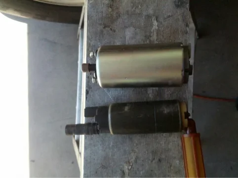

Went with a supra pump!
Holy cow, that's a giant pump!!
