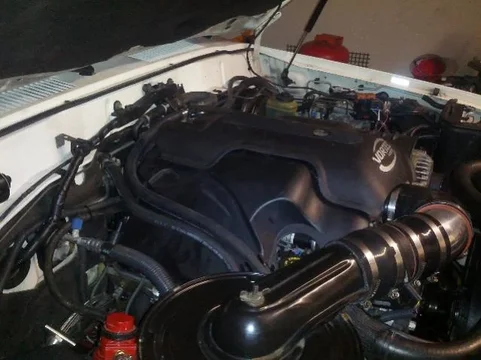

Side shot
Maybe I missed it somewhere in the thread, but how are your mating this to the transfer case. Or what are you doing for transfer case ?
Mark adapters kit 4L60e to stock 80 tcase
Ok one more question, how hard is it to mate up the wiring. You are splicing the Toyota ecu to the GM ecu ?
Toyota ecu is deleted. Services no longer needed... GM harness requires minimal wires from the Toyota harness to run. Essentially just a keyed 12v, a ground and a 12v crank source to the starter.
Sounds easy just time consuming. Lots of little detail needed
Does Dirty Dingo make mounts specific to the 80 series? Did you retain the stock frame mounts or weld in new ones?
Not 80 specific. But best fitting when. Cutting out the factory mounts. I'd like to make some mounts to bolt onto the stock frame mounts

Someone asked if it was possible to I said yes it is. No I'm not running the factory auto as it would need a standalone to do so. Drivetrain is 5.7l ls1 4l60e automatic and stock tcase.
