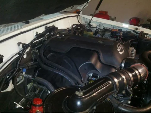

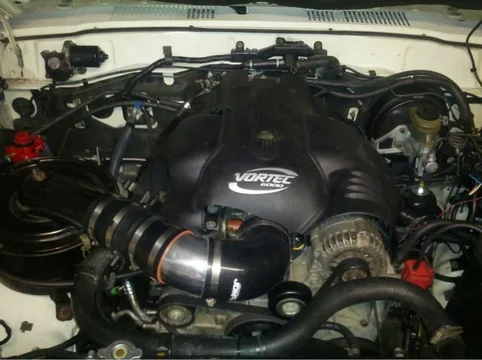

1996 Land Cruiser repower
i would expect to see more of these LSx swaps in the future. all the hard work is figured out now!
soon many 80 series owners will realize that these trucks were meant for some good old fashion american v8 power :grinpimp:
my 80 makes me smile every time I pin the throttle to the mat. acceleration is roughly twice as fast as before.

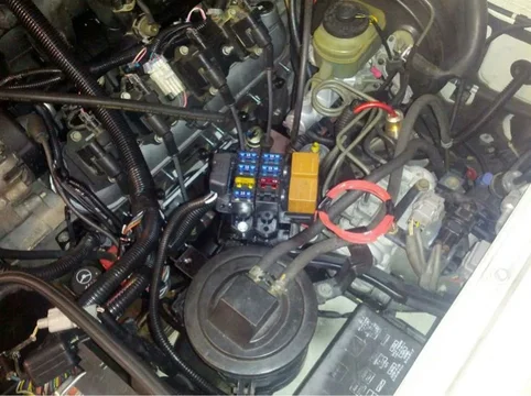

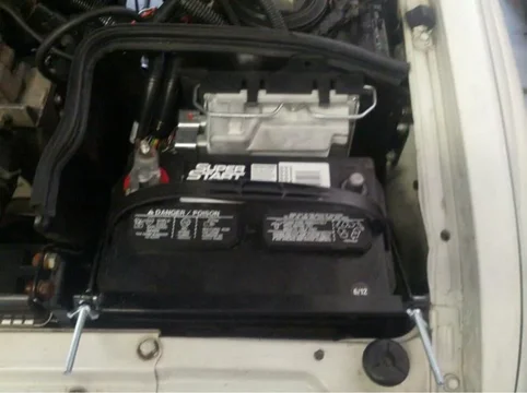

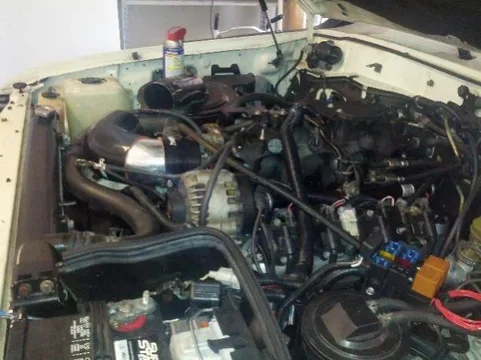

Here's some more photos of the swap! It's almost done.
How much splicing is required to get the factory gauges to work?
Looks good, any idea how much lighter it is, and will you have to go to a bigger radiator?
No splicing required to get the gauges going just some addition to adding the Toyota sensors to the motor. Front end will be around 250lbs lighter. Stock radiator was retained, its plenty big enough to cool that v8.
Tach you need to get a converter from a company called Dakota digital
Looks great! What is the plan for the exhaust?
2.5 y into a single 3 out the back using magna flow cat and stainless muffler. Same I run on my 6.0l lx450.
Is this going to be an emissions legal swap? I still see the factory vapor canister in place. I removed mine and put the PCM there. A gm vapor canister is now mounted in the back with the required vent hoses and harness to actuate the vent valve.
Yes it will. Ended up using a purge valve off an earlier vortec which will connect to the factory canister. I routed mine like this also.
