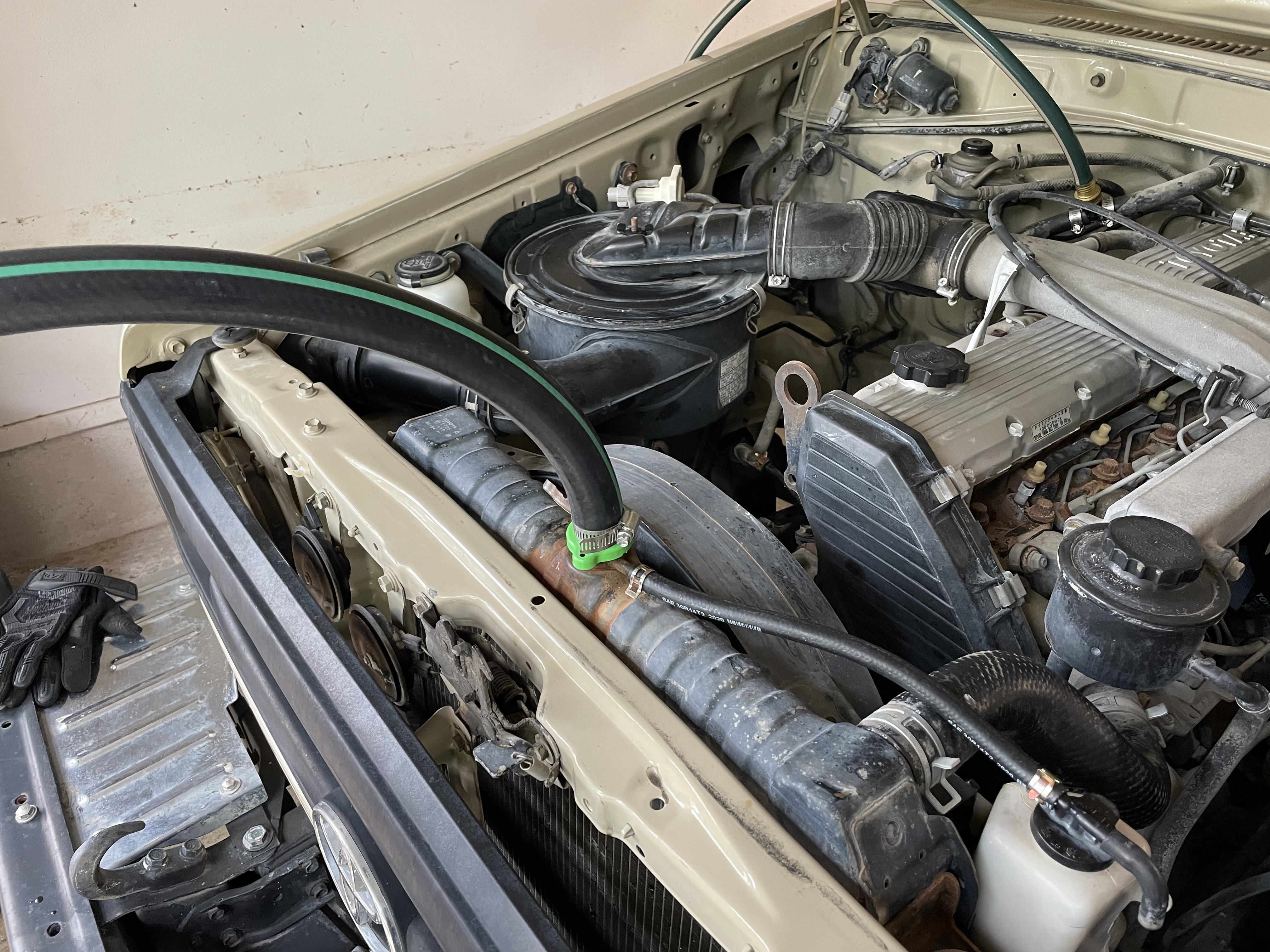

Does anyone have a coolant flush/cleaner that they like?
I pulled the overflow tank to see if I could clean it up. It’s obvious to me that there is tons of rust and buildup in the cooling system. Obviously I can replace the overflow tank, but what about the rest of the system? I’ve read lots of people have luck with Thermocure for rusty coolant systems.
What do y’all think?
I have good luck getting the bulk of it out with a pressure washer if you can get your hands on one. A wide tip and do your best to move it around in there. If the plastic isn't looking brittle you can move down in tip size, just don't go too crazy lol

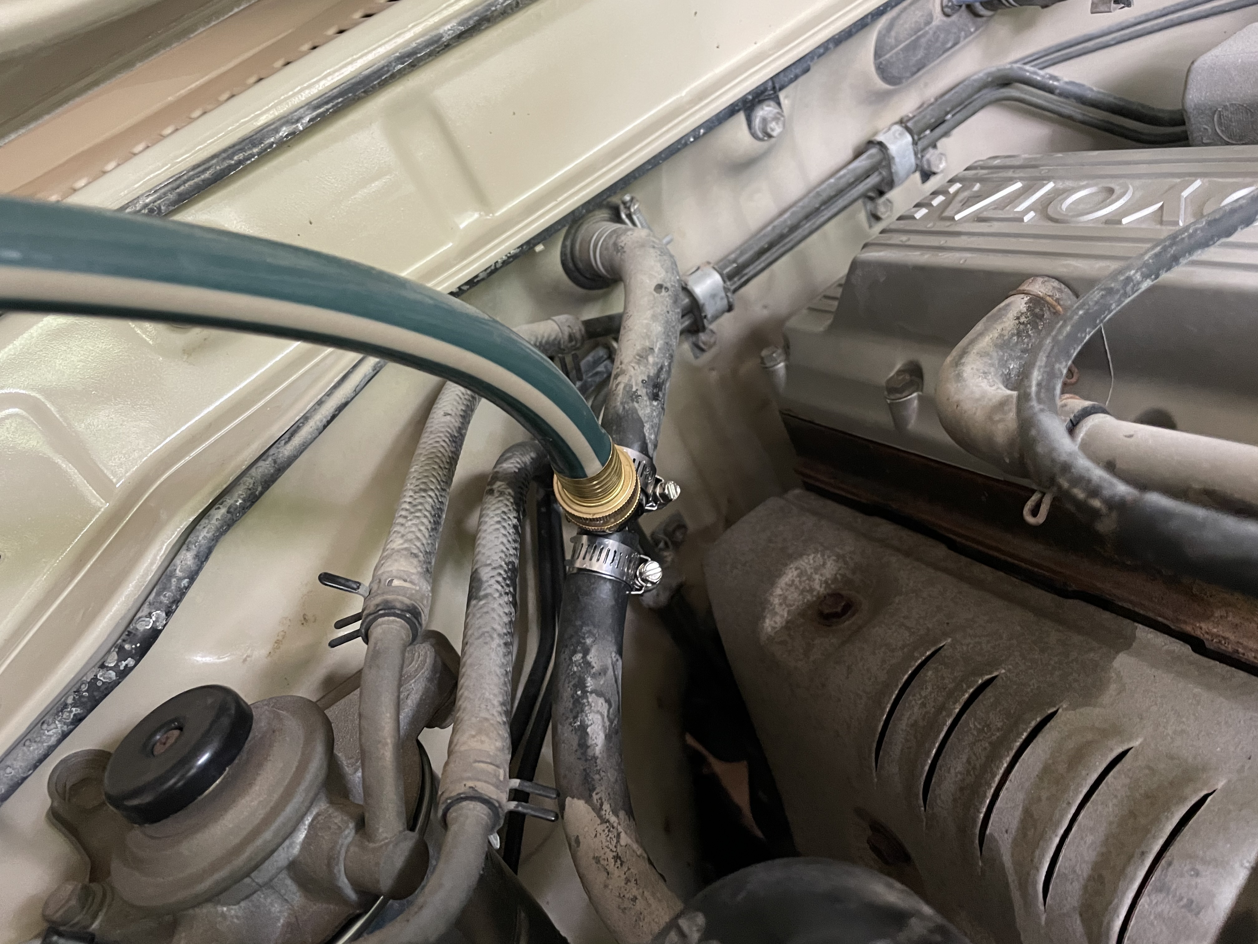

I decided to start by flushing the coolant system with just tap water. It was apparent to me that the “coolant” was so filthy, anything would be an improvement. I do not believe there was any actual radiator fluid in the system. No sweet smell, and just looked like filthy tap water.

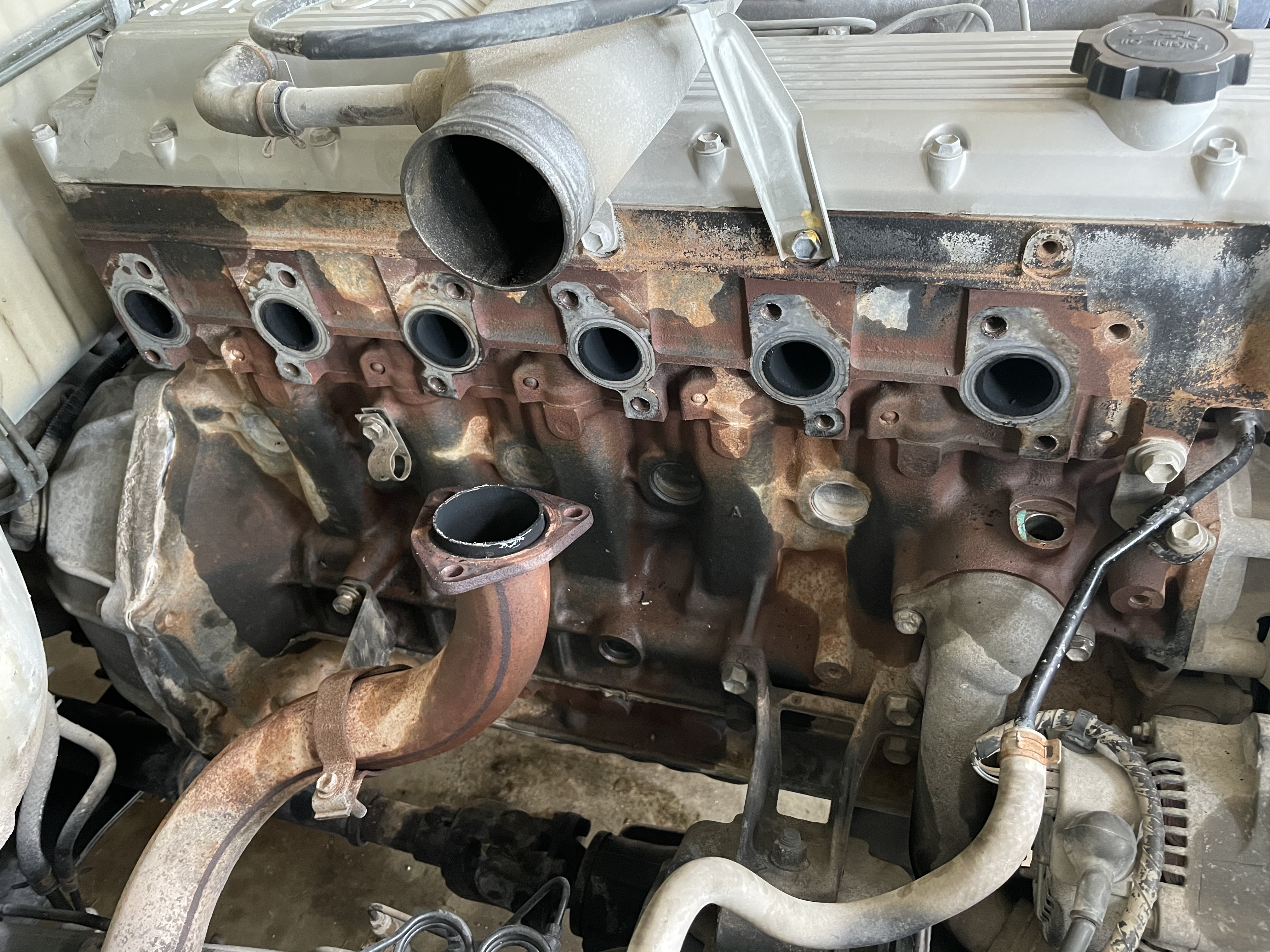

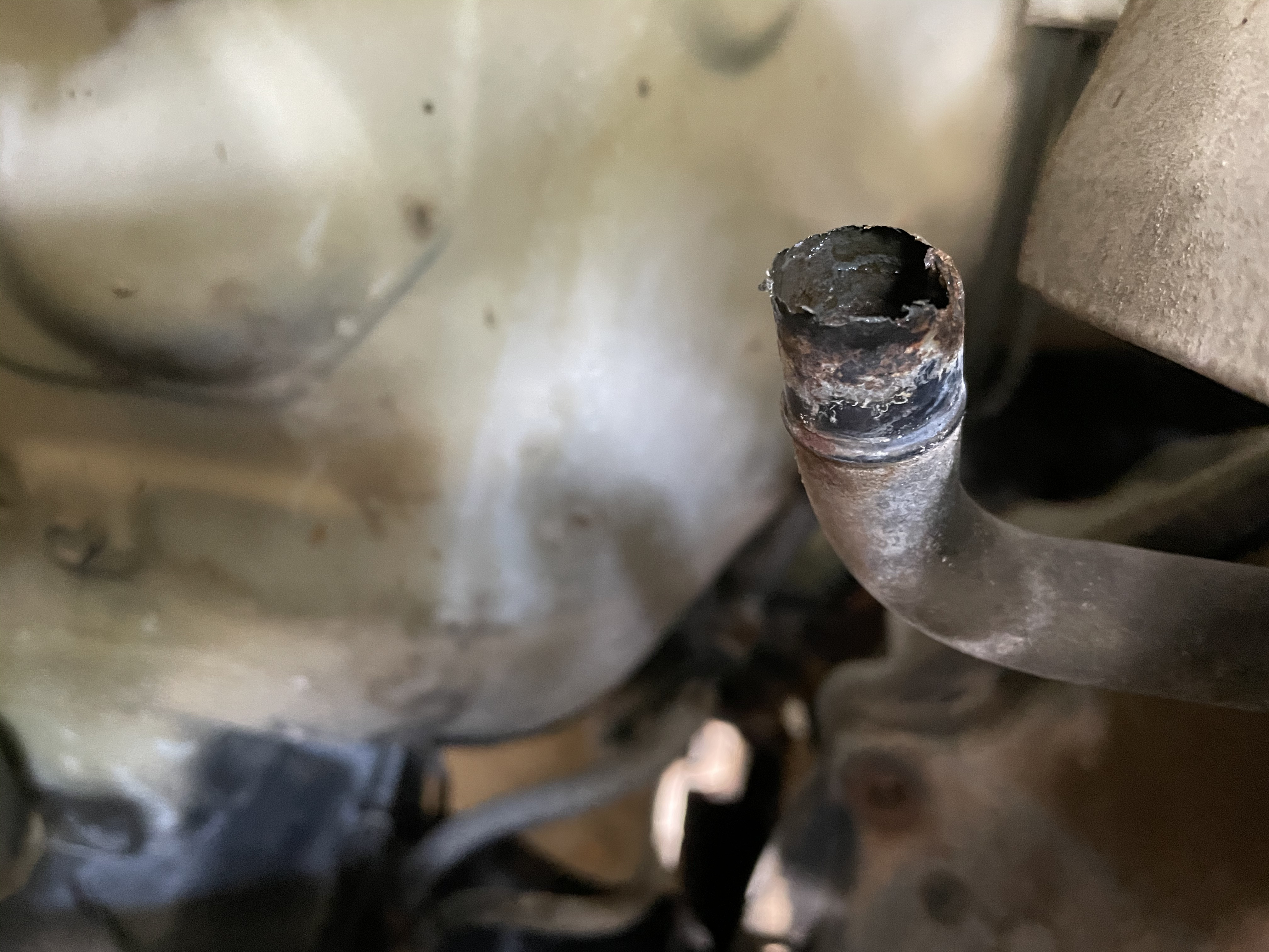

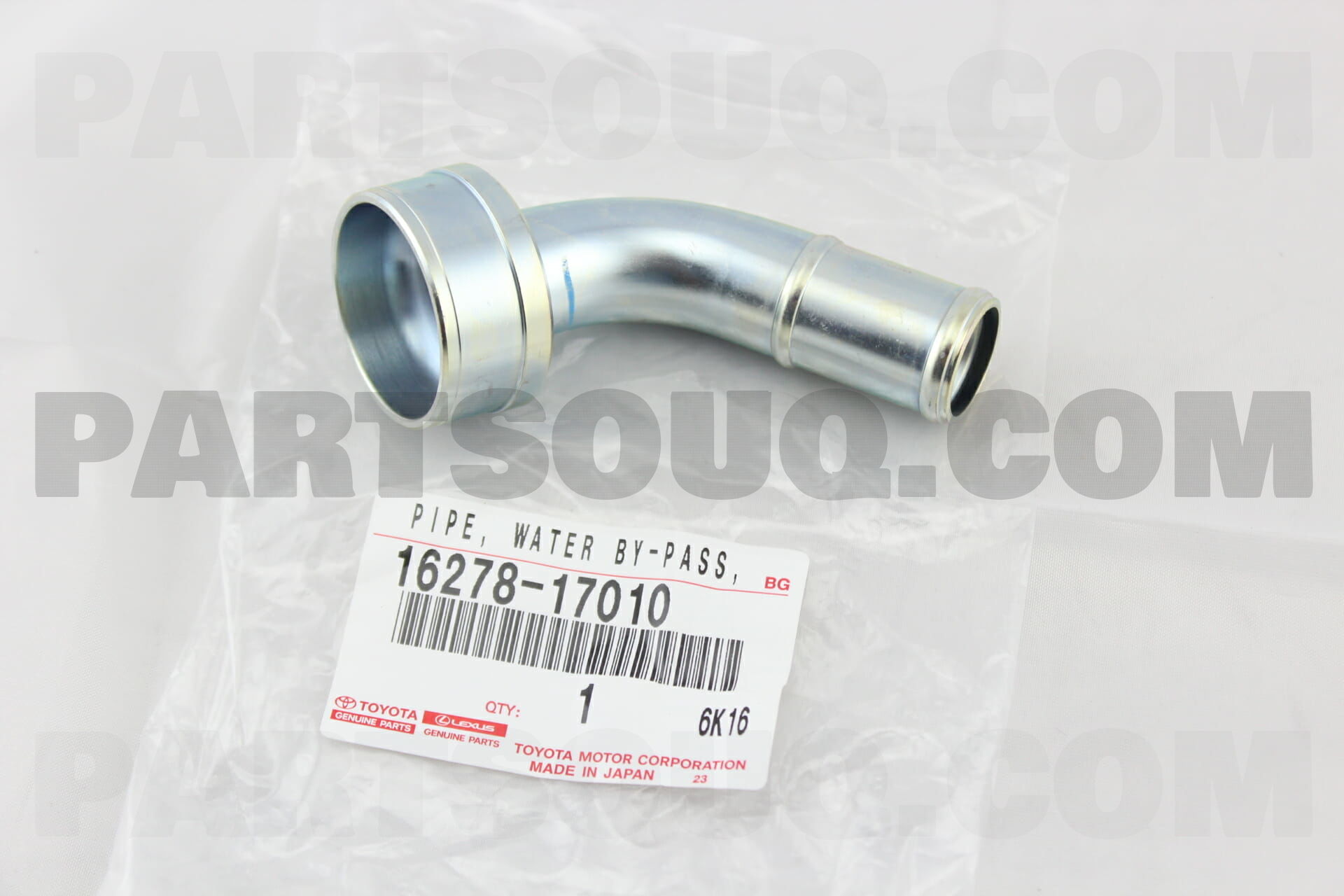

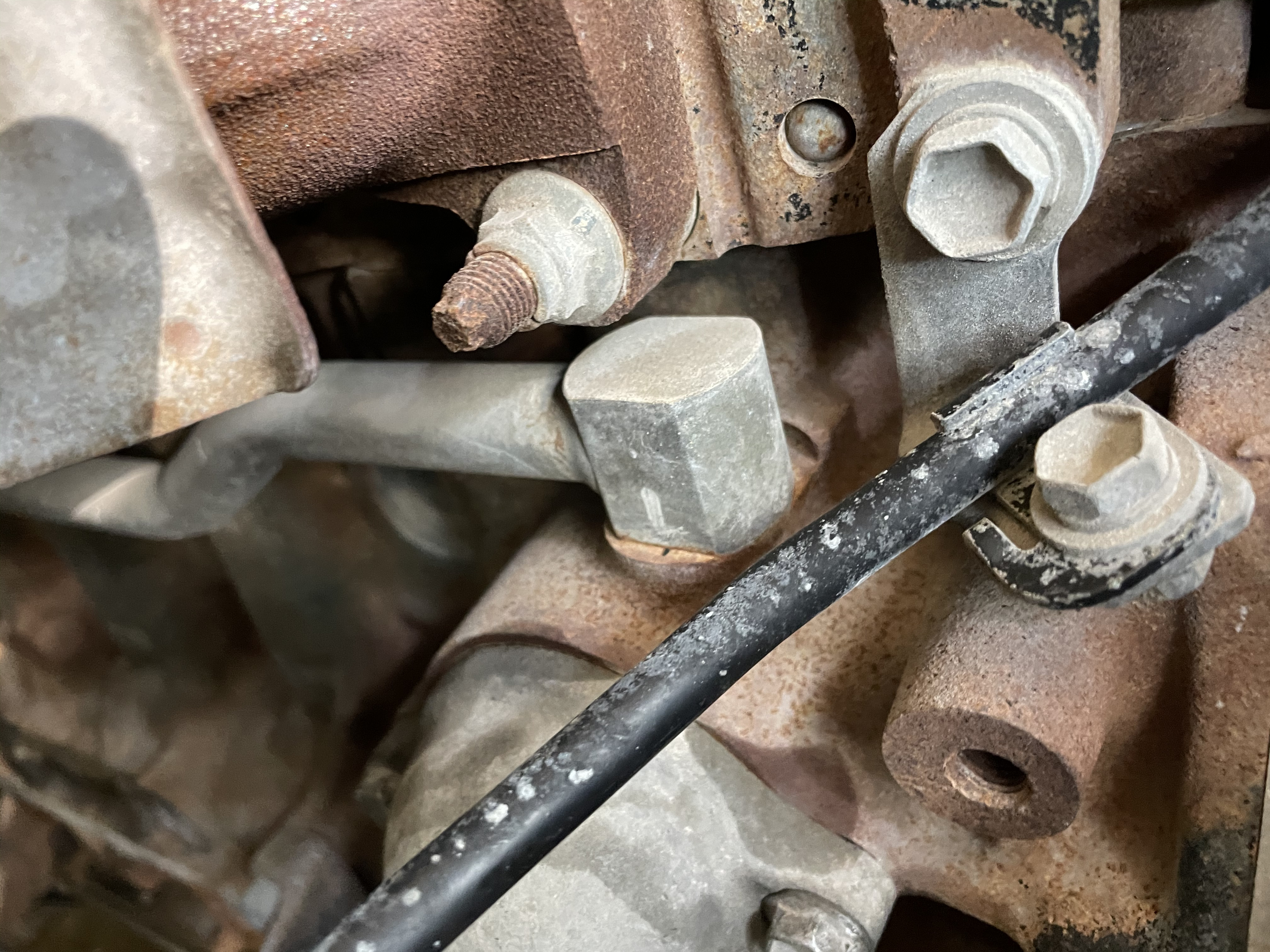

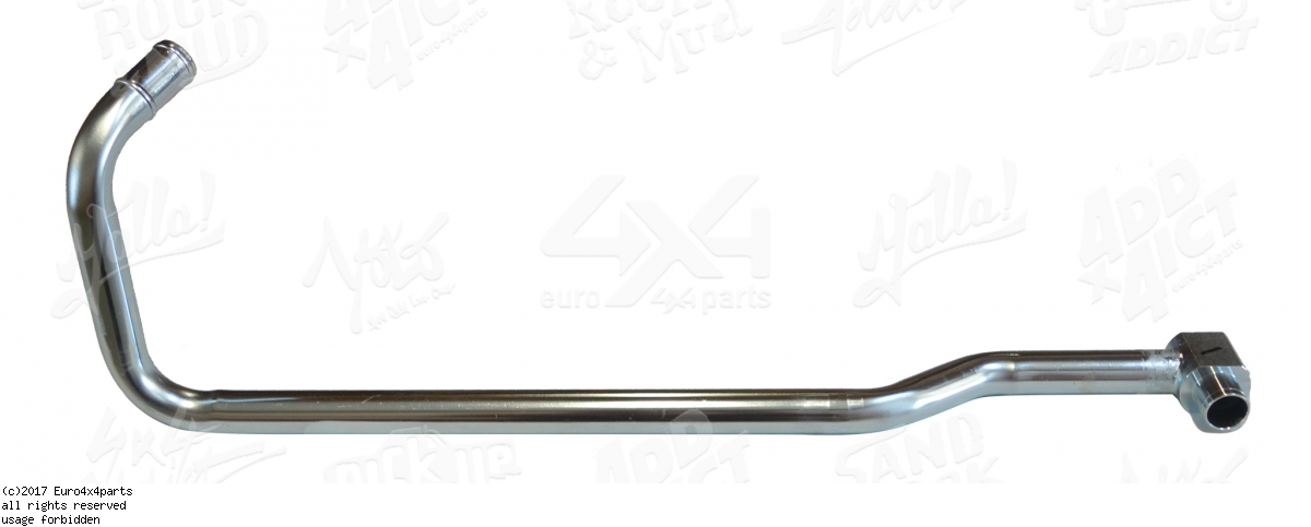

I went ahead and pulled the passenger’s side heater hose. It looks like Toyota “Pipe, Water Bypass, No. 1” (PN: 16268-17010) may be in my future.
Is this a press fit? Do I have to pull the exhaust manifold to access it?
Yes and yes.
Also, that radiator is s***. Go to your local dealer and order 16400-17080.
Agreed. I already have a new radiator on order.

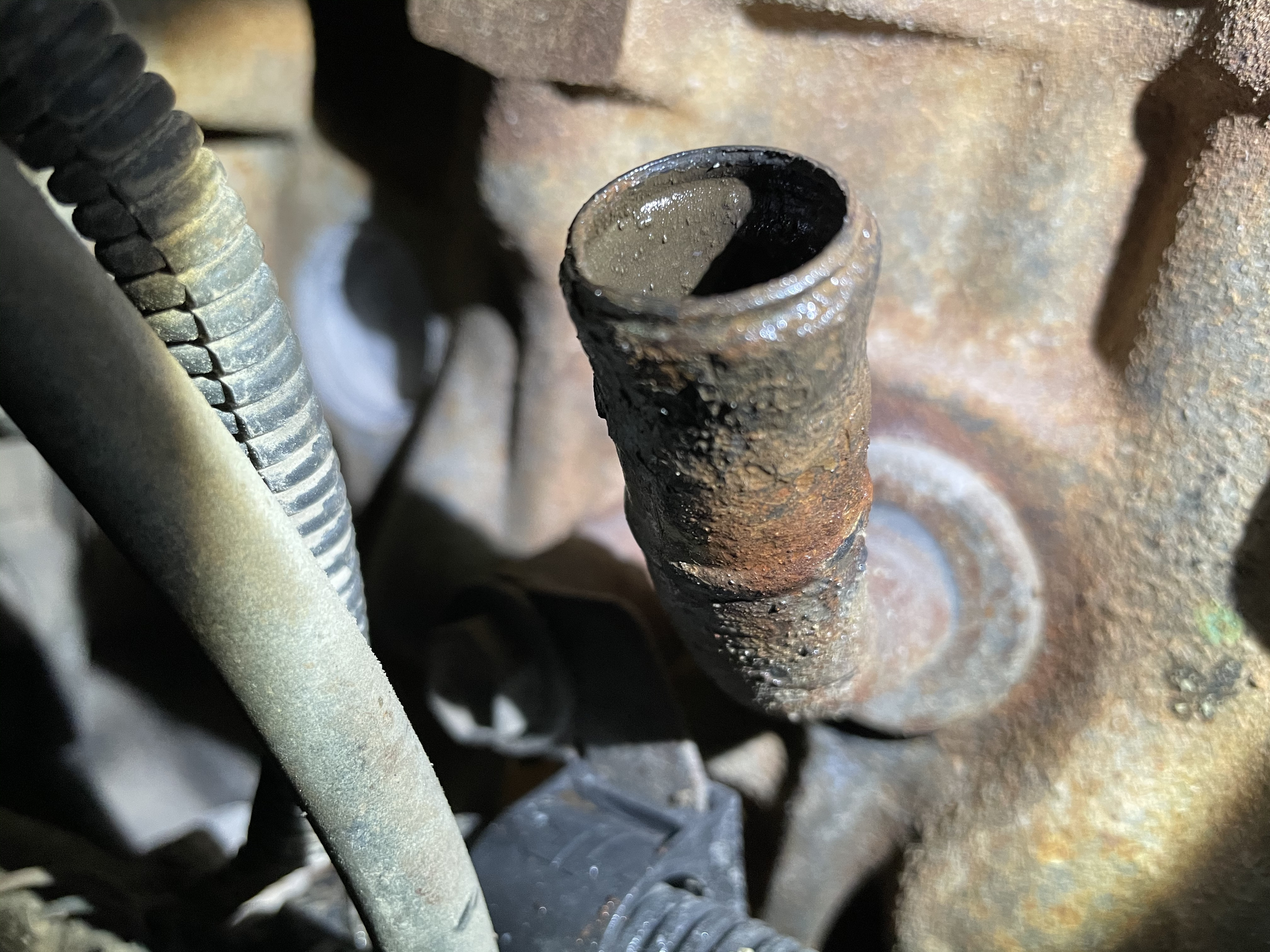

What do you think of bypass No. 2? Should I replace it? Is this also press-fit?

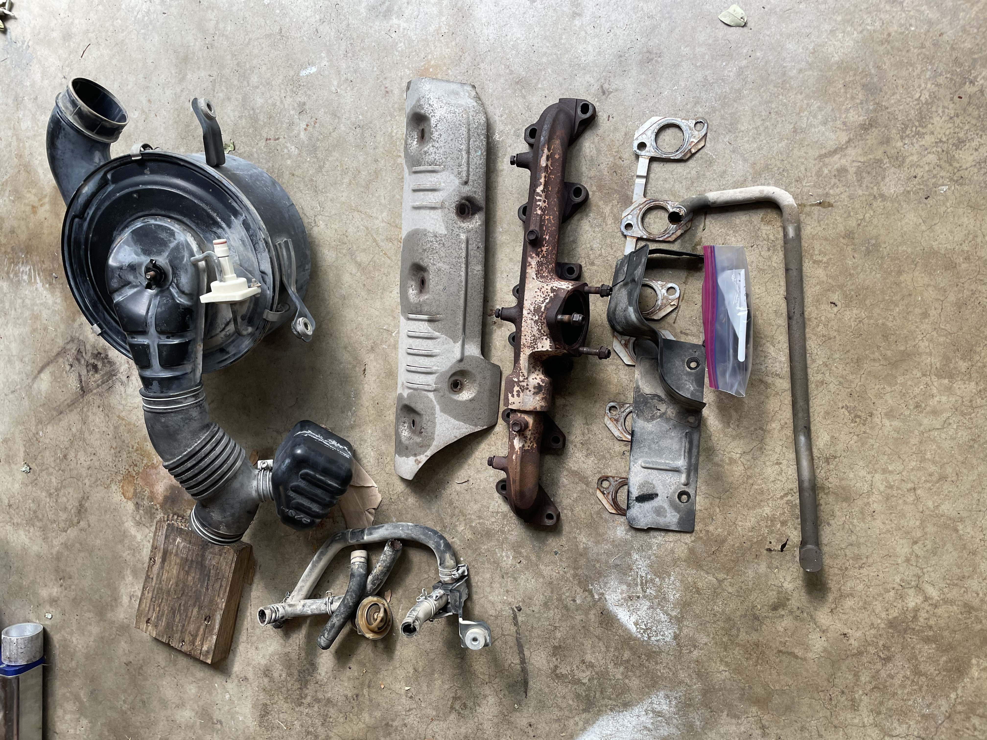

But I knew the cooling system needed work. All of the hoses were “crunchy” and the coolant was filthy. The plan was to flush the coolant and install new hoses. But once I pulled the passenger’s side heater hose off that hardline, I knew the hardline needed to be replaced too.
So I pulled the exhaust manifold and removed the hardline. New parts are on the way.
