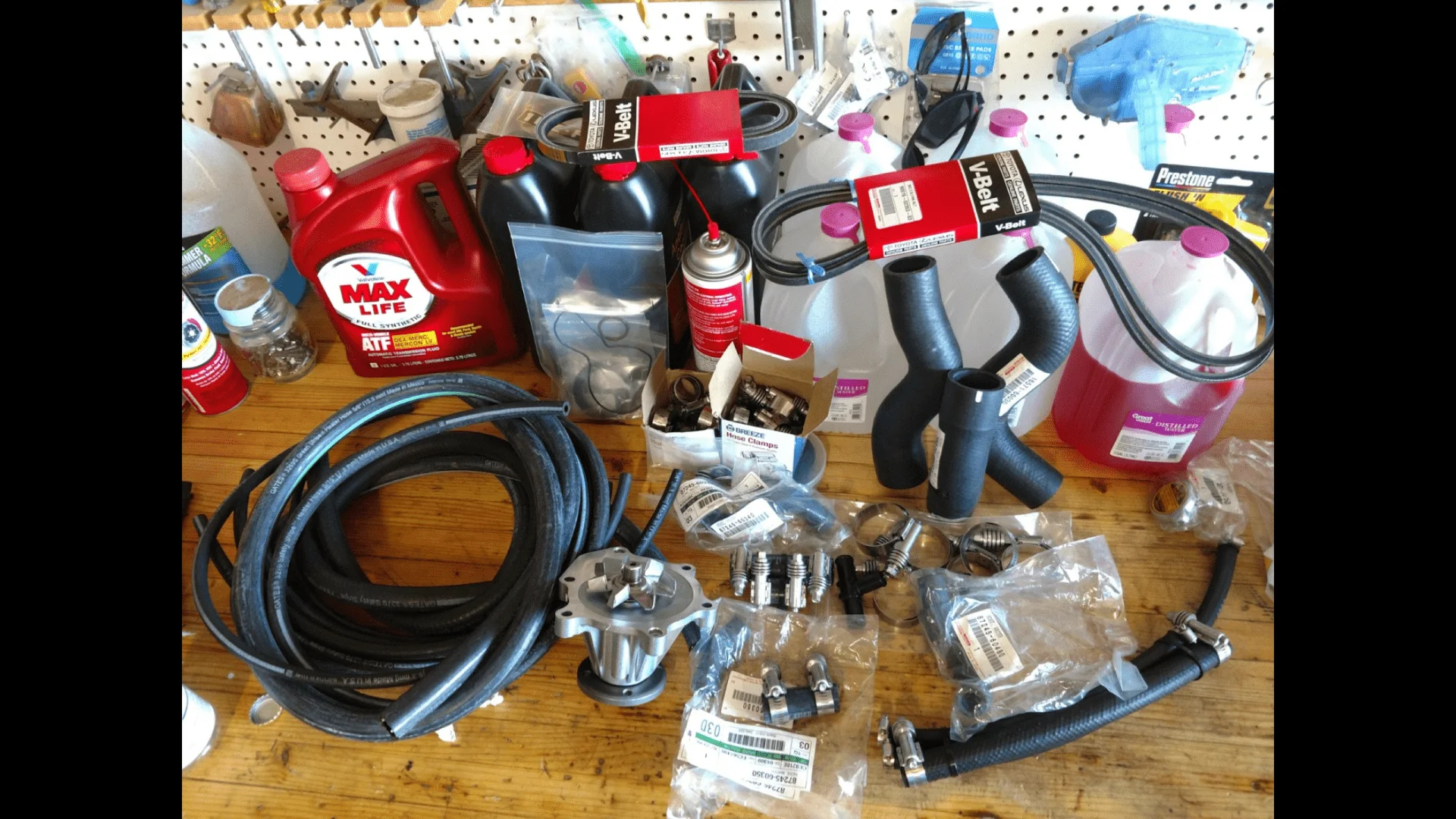

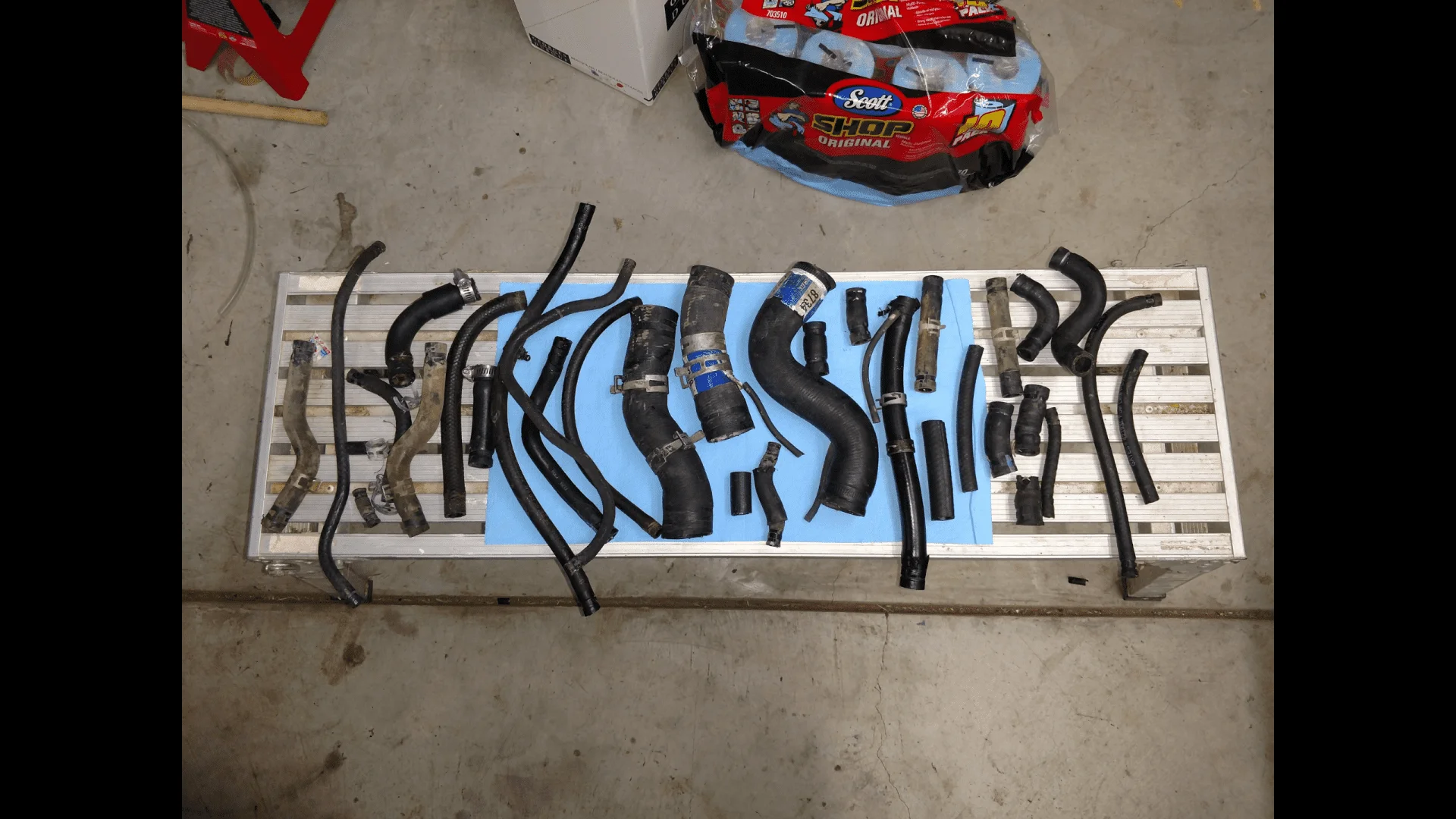

This is subject to change, but here's what I've come up with so far(updated 7/6/2018):
Finished! (except for the rear seat heater hoses...another day)
That’s my 80 in the pics, appreciate the compliment!
Missing are the hoses for the rear heater, I bought them but they’re kind of a pain to install...so they’re sitting in my garage for another day.
No sweat, you're welcome. Im new to the forum and the community. Picked up the ‘95 FZJ in my profile pic about three weeks ago. Already buried in the rabbit hole. I’ve been trying to discern all part numbers for pretty much every rubber hose under the hood and your pics/post above was even better intel than I’d hoped for. I haven't even broached the rear heater situation yet. I’m aiming to attack pretty much everything in your pics first. Thanks, again. Big help.
I’d suggest replacing the radiator(if it’s original) and water pump too, I did mine shortly after the hoses. There’s a lot of write ups on the PHH, I happily wrote a check to get mine replaced when I had a shop take care of some engine oil leaks, I couldn’t figure out how to get to the PHH without a lift.
Awesome work, very helpful. PHH is easy if you can take the front driver wheel off and have a garage you can swear loudly in.
This is a great reference and has helped me a lot, but the Clamps for the upper radiator hose part number should be 90467-41002. Two are required. All other part numbers are correct.
90467-41002 seems to be out of production. 90466-41008 is listed as a replacement.

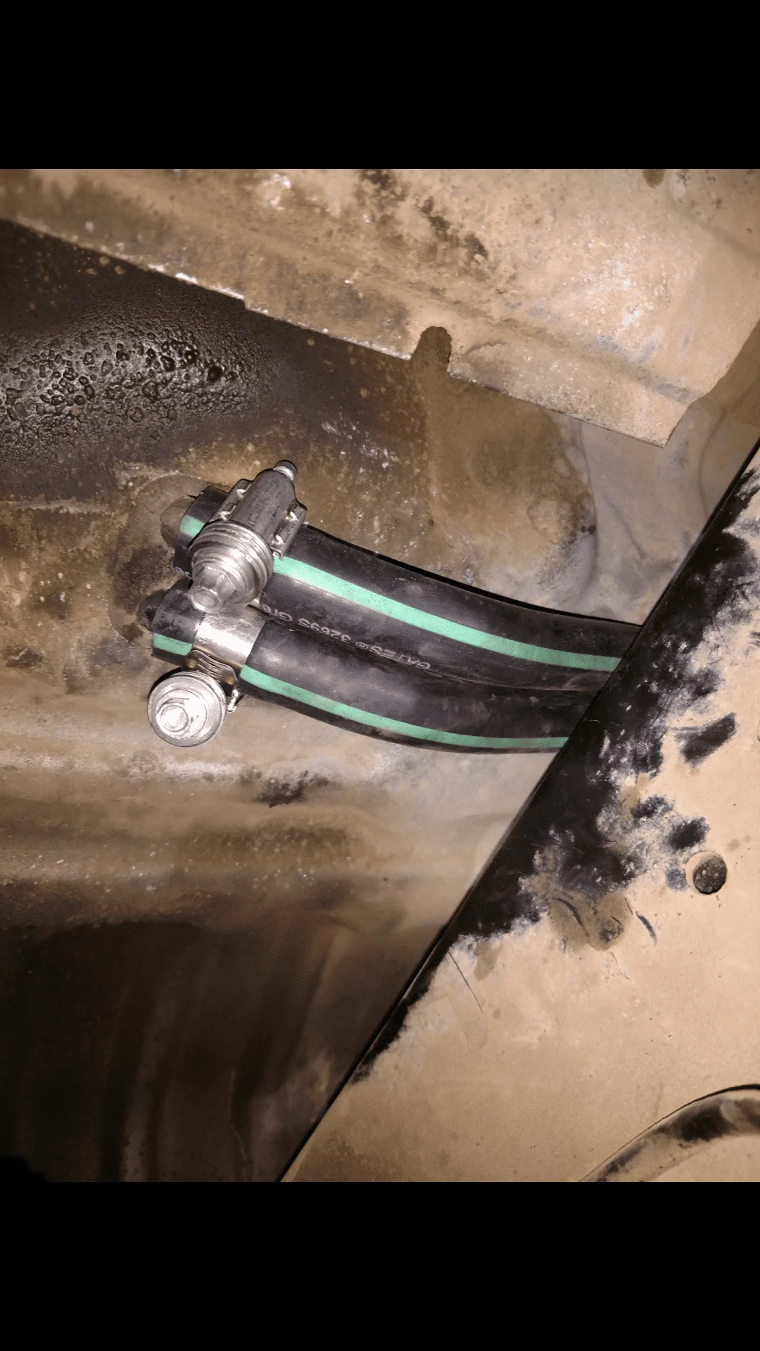

Made my own rear heater core and as many hoses as I could out of gates 1/2" & 5/8" green stripe.
Don't be sloppy about and of the work!!! Add a banana :banana: for being meticulous! Buy once cry once, do it right once!
A number of 80 series coolant connections are in spots like the pesky that can fail and it's game over before you know it.
Special thanks to Joey @NLXTACY ongoing and when I started my journey and love affair with my 80 series. Lots of goodies at Wits End that solved "problems I didn't know I had" :flipoff2:

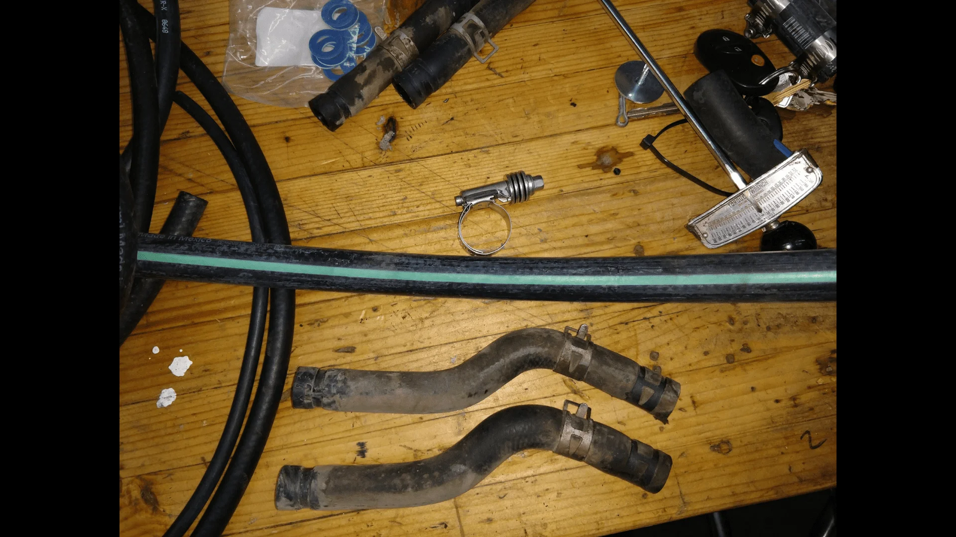

If your wondering 8 3/4" for over frame rear heater core connections (photo attached) they bend in just right, no kinks.
Old rear heater core hose sizing
New rear heater core hoses
