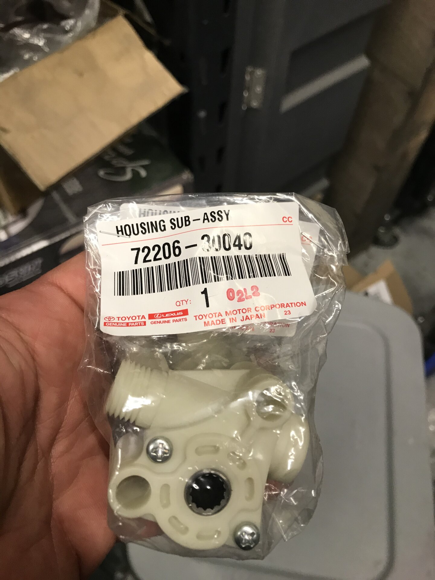

A bit of build content.
We needed to replace these and I didn’t have them before the Cruiser went to the interior shop.
I needed to also pick this up so we can assemble the sunroof and take it to the interior shop.
More pics of the covering to come. We (mostly me) went back and forth about wrapping the headliner in leather or vinyl. Personally I really dislike the 95-97 fuzzy headliner and pillar trim coverings. The one piece headliner rocks compared to 91-94 80’s but the earlier ones the vinyl is so much better. Why? Well you can’t clean that 95-97 fuzzy very easily. We are also finding that after all these years the glue bleeds through and it just looks nasty with no real way to fix. We eventually settled on a headliner fabric that is shampoo-able and is fairly similar to vinyl. I like it. @ohsix picked out the color. Whole headliner and all the pillar trim pieces are getting wrapped with it.

What is it?

Clarification: What is this, if you can say: "a headliner fabric that is shampoo-able and is fairly similar to vinyl." Not really a fan of vinyl myself, and leather doesn't last...
It’s a flat knit, foam backed headliner material.
Seems like you might be able to do a light clean with a vacuum, which is what ICON recommends for their Alcantara liners. Less wear on the material…
