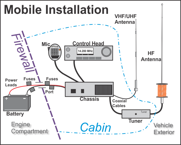

I've been doing some HAM research. He is a really informative blog I found. I don't want to lose the link and feel like it would be beneficial to anyone trying to set up their trucks for mobile ops. There are multiple parts but I'll just link the first one here.
