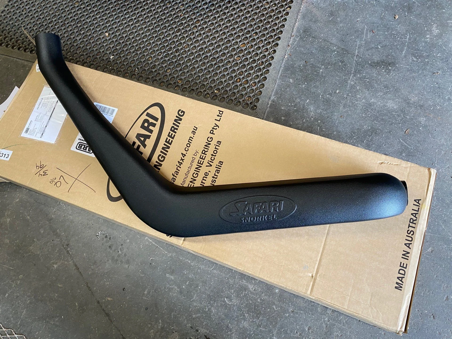

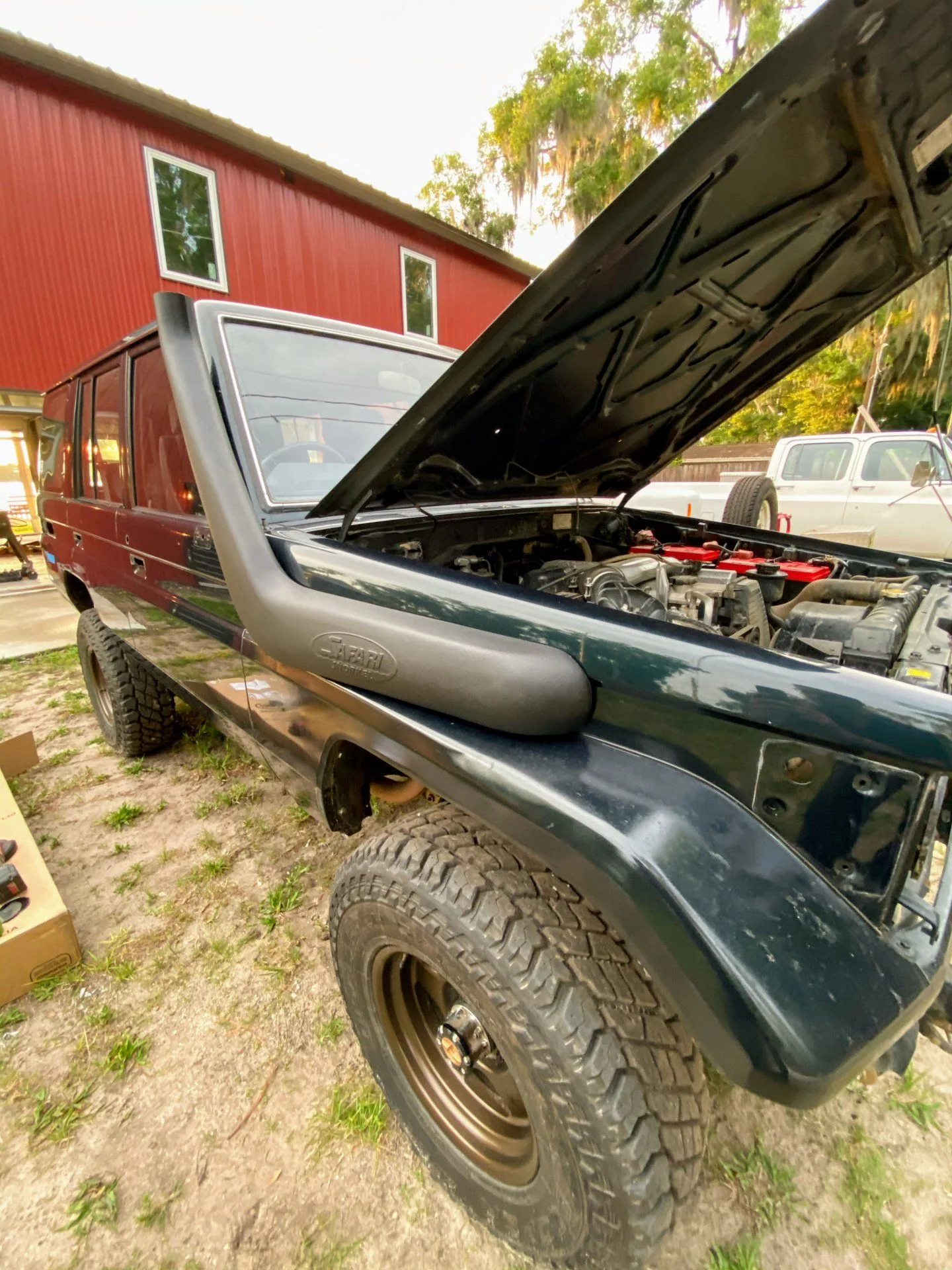

I decided at the last minute to add a snorkel and @ca18sean wanted to mock it up before paint. Did not want the extra large Safari Airmax so I ordered the classic Safari Snorkel.
And here we are all mocked up on the truck. I really like the clean lines of the original Safari model. It looks similar to the OEM snorkel but its actually a one-piece unit.

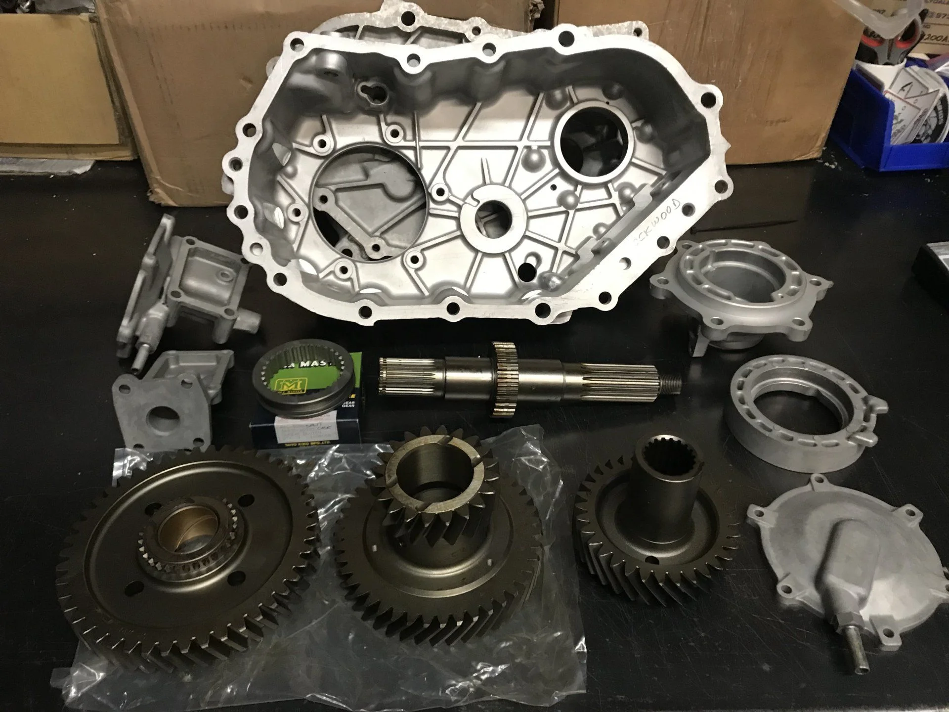

Lots of good progress on the 77. I always wanted a low range gear set installed on this truck. There just was not enough time to get to that when the truck was at @SNLC shop last year. Got off the phone with @orangefj45 last night and he is sending all the necessary bits and pieces to @ca18sean to tackle that project while the truck is down. Now this 1PZ should spin some RPM’s in low range.

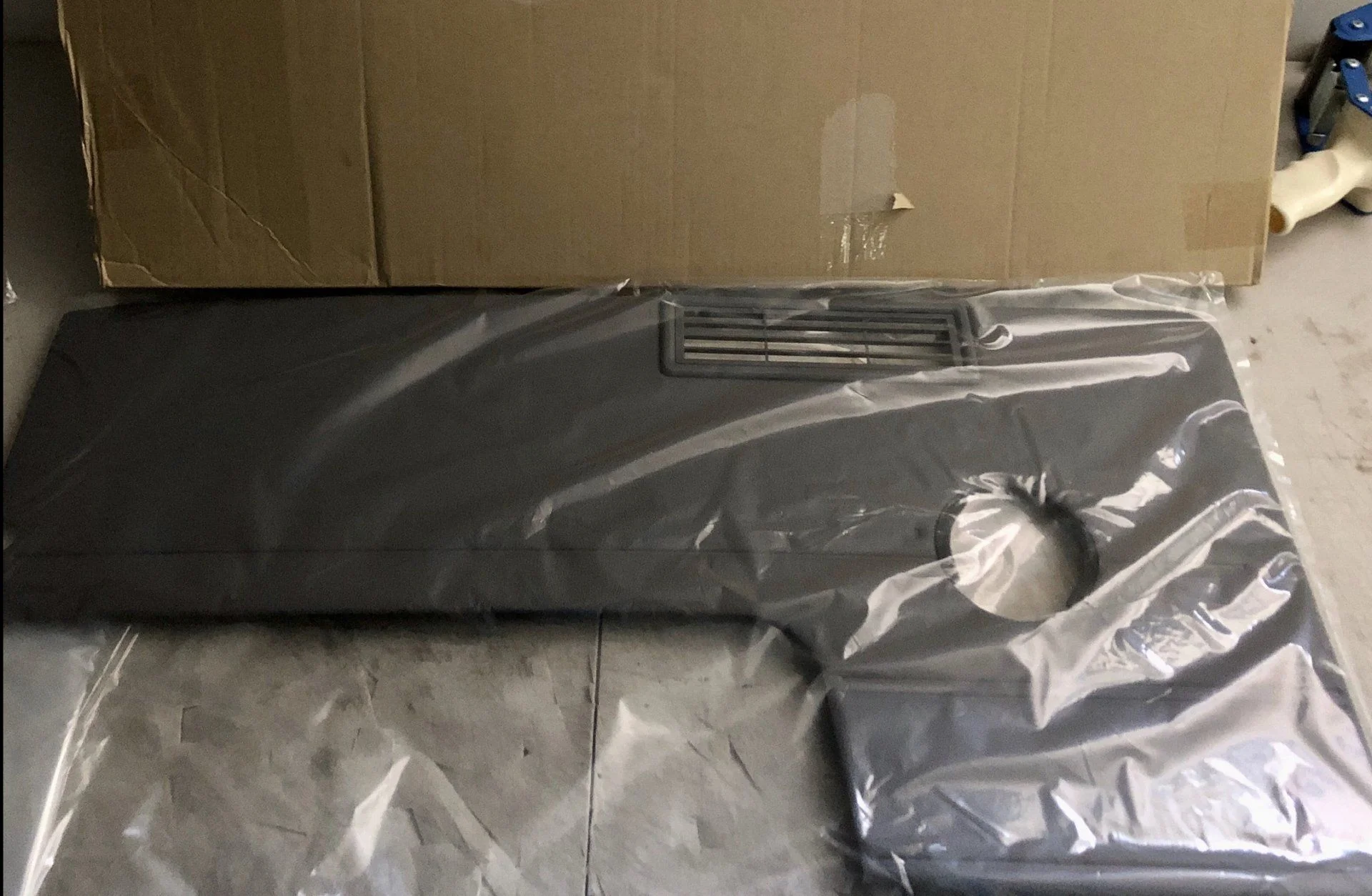

The truck was missing a few interior pieces (most since replaced) but the one that bugged me the most was the rear interior panel. The PO made a homemade panel that was “fine” but we can always do better. I had checked out a few places when I got the truck but no luck. Could not find it to save my life. @Onur has been serving as “Project Manager” for my two 45 builds so I shot him a text to see what he could come up with. A few days later this jewel arrived...
There is literally nothing better than new OEM parts. We are replacing all the exterior badging with new OEM as well but securing the rear panel is clutch.

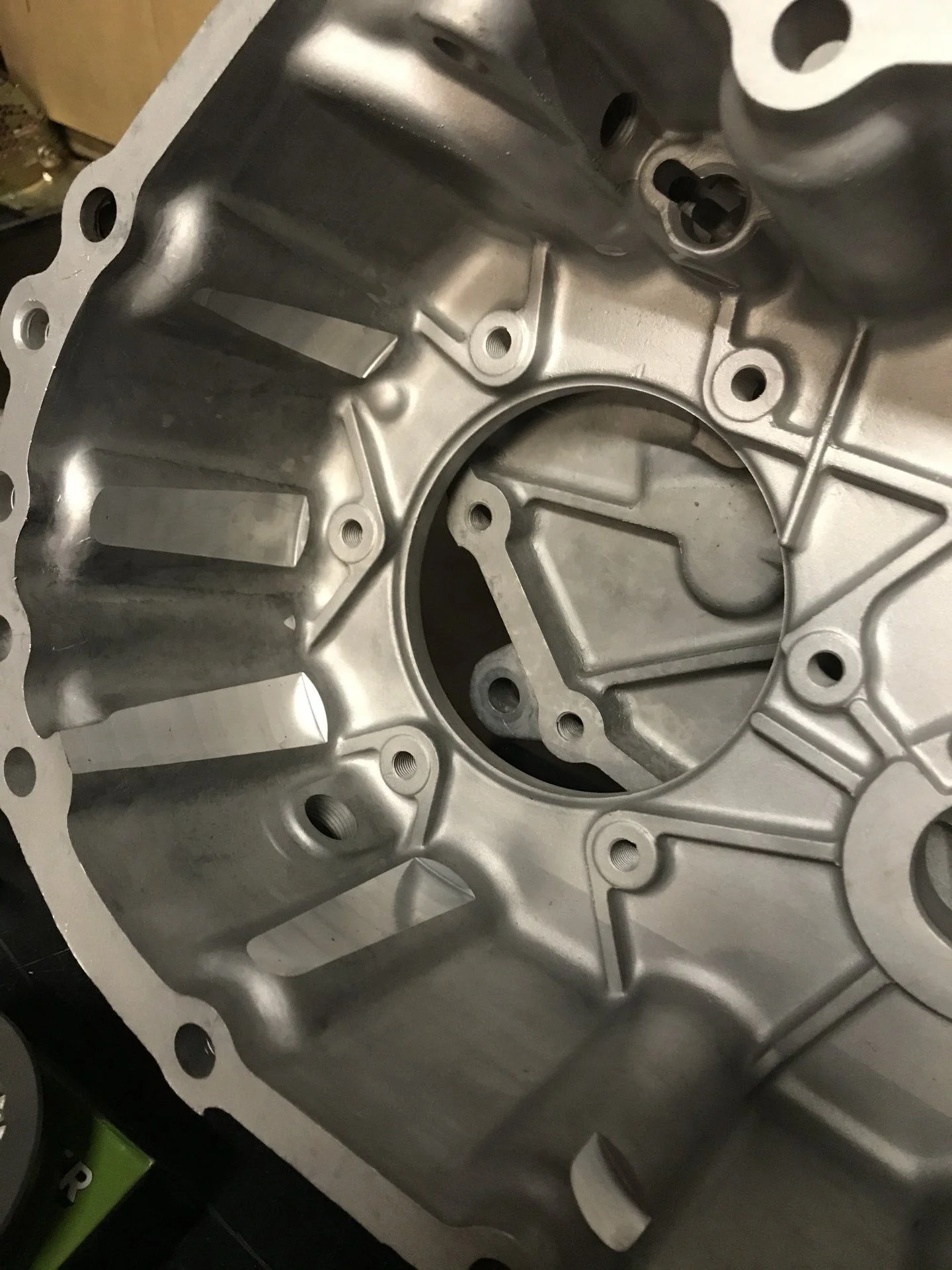

Tcase parts are ready, case is machined for the Sumo 3:1 low range gears, also sending a Sumo full-spline input gear and rebuild kit.
Parts will ship out Tuesday.
Thanks again John!!!!!

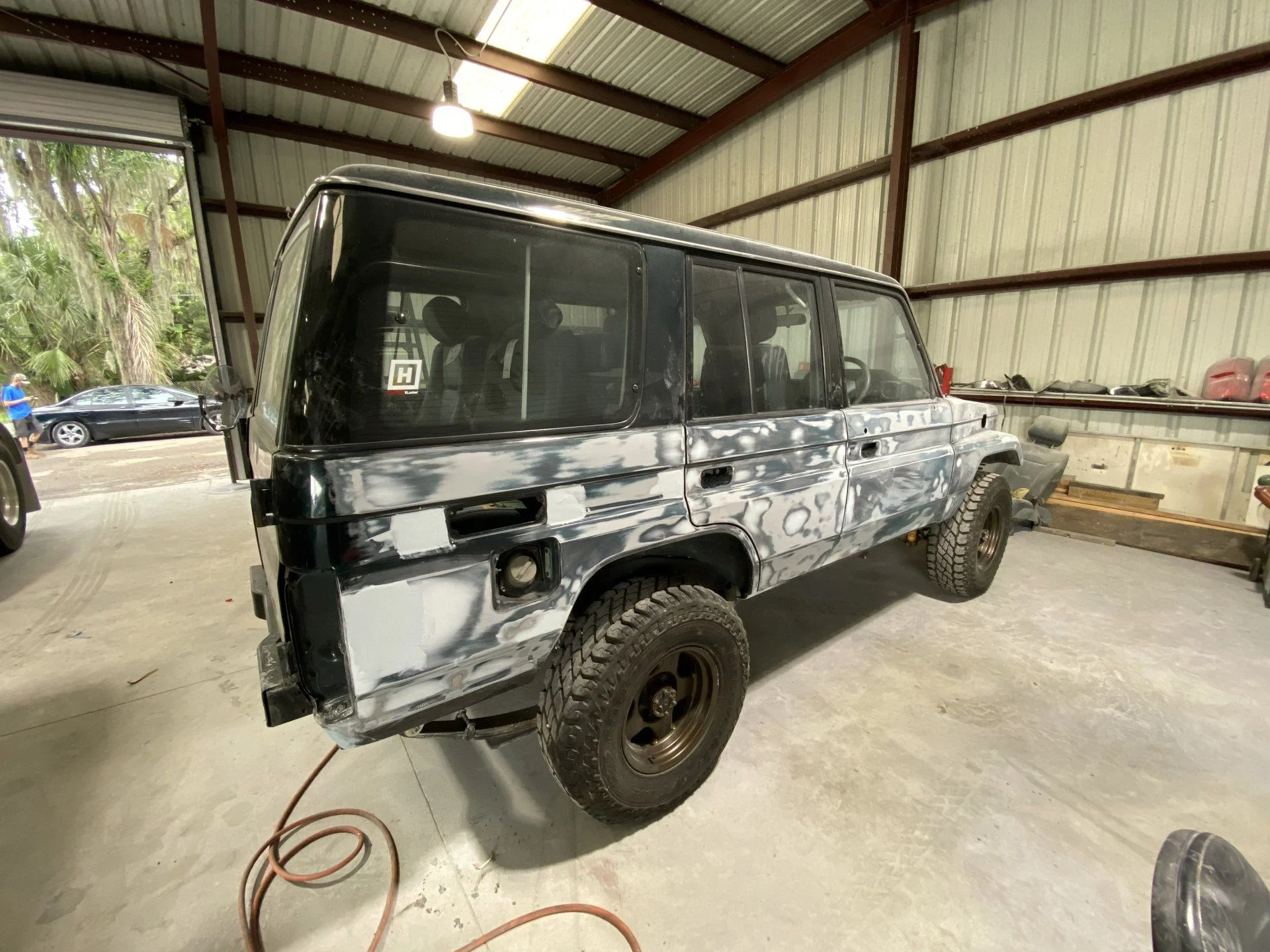

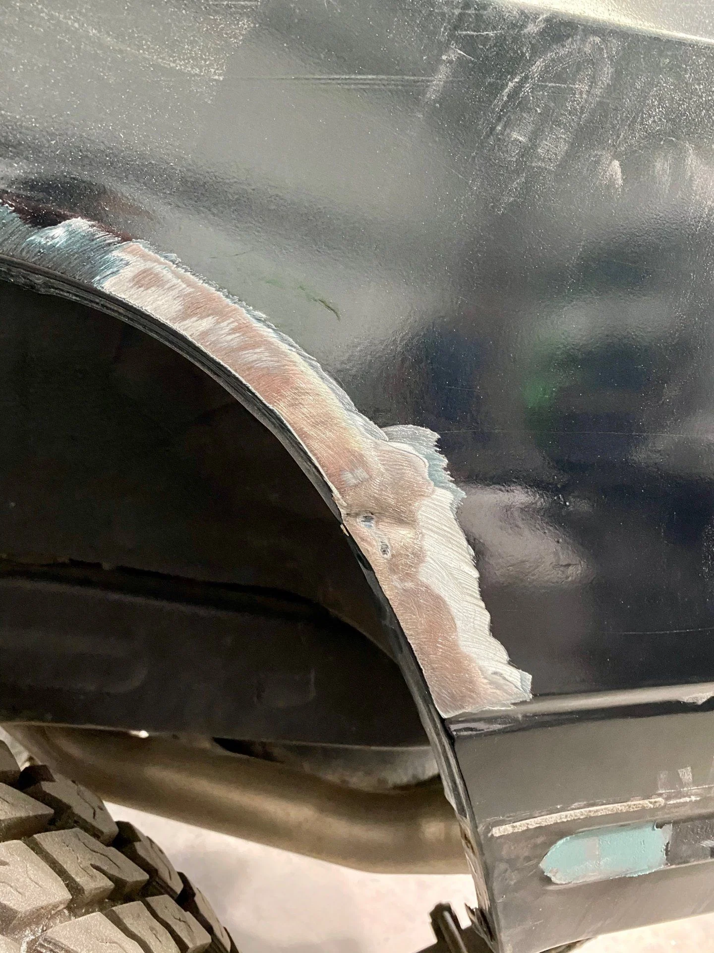

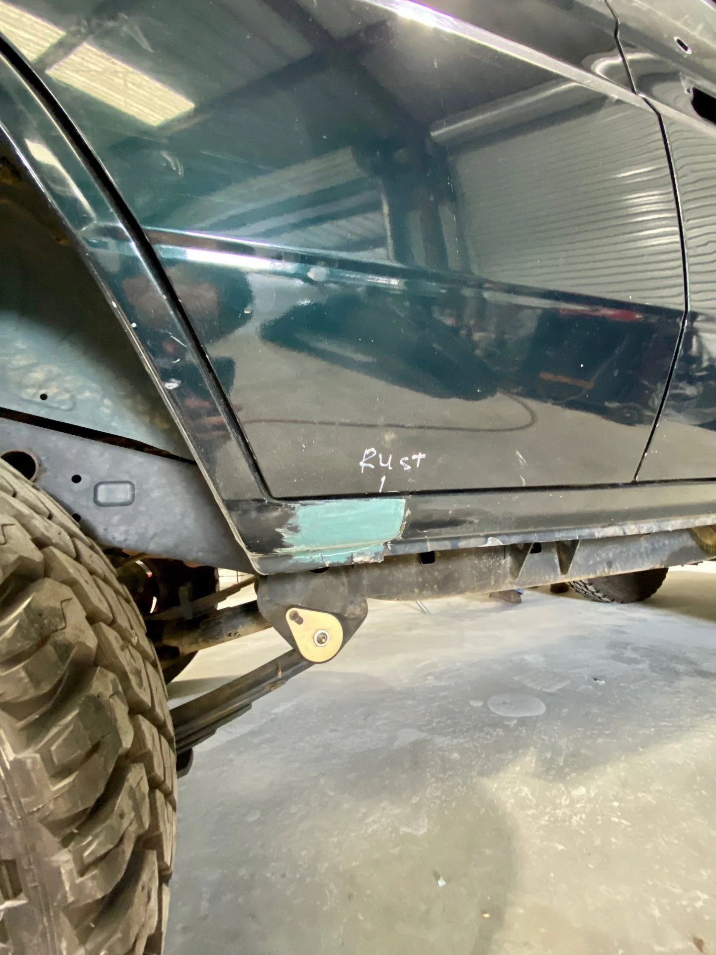

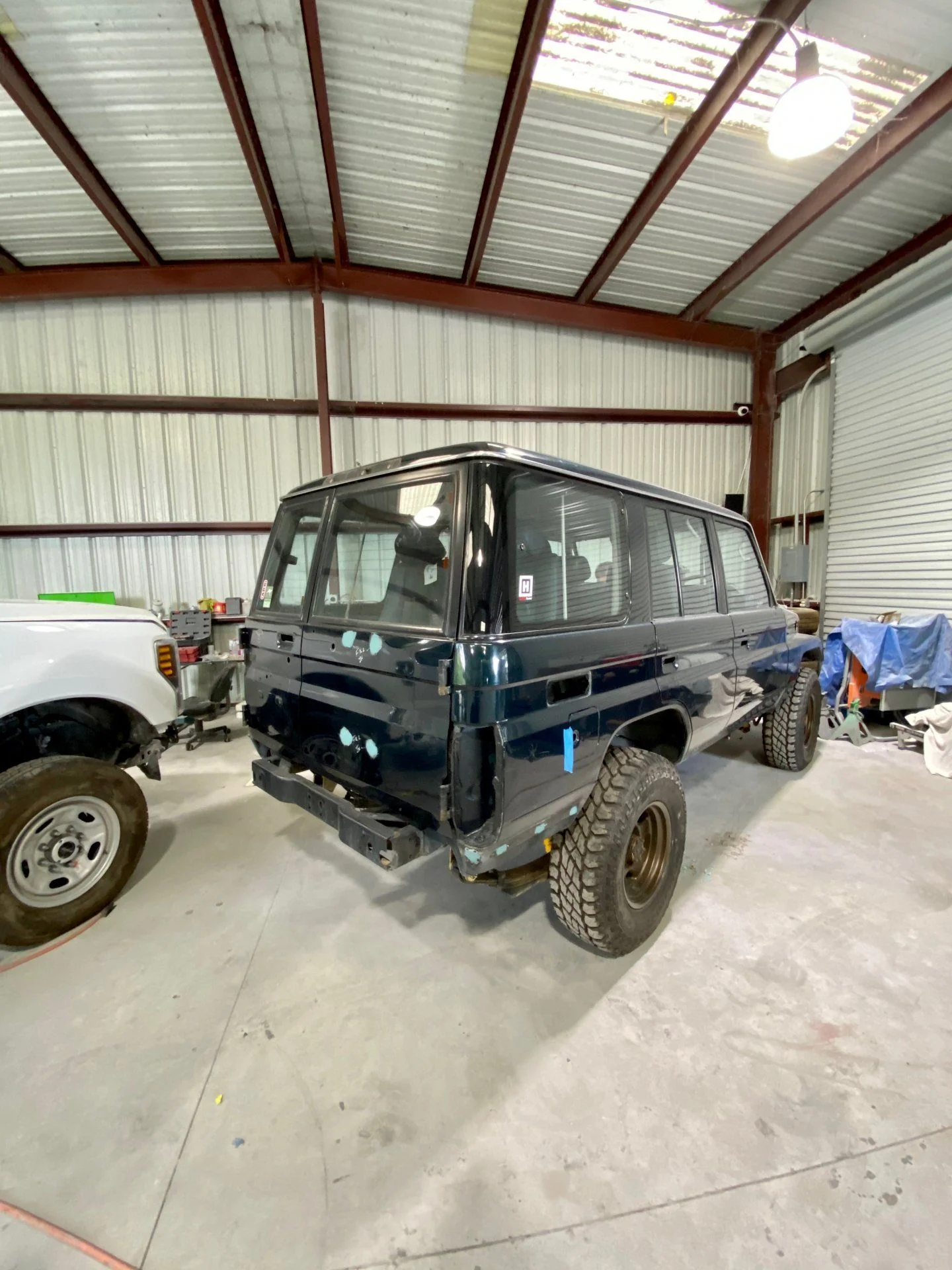

Made some progress on the truck this week. The body shop worked their way through the PO’s body work, filled in some holes and a bit of rust in the right rocker area. We no longer need the factory rear holes for the bumper or the spare tire carrier. I’m going with a Kaymar rear bar in its place.
The truck is pretty well prepped for paint at this point (these photos were taken earlier in the week). Hopefully the truck will get painted by the end of this coming week and start going back together.
Man....this thing had a lot of little dents and dings. The shop was still working on body work at the end of last week. But that is pretty much wrapped up now and I am really glad that we ended up taking it this far. The shop has done a great job of really getting in there and working out some of the previous body work and making sure everything is nice and ready for the respray. The end result should be worth it.

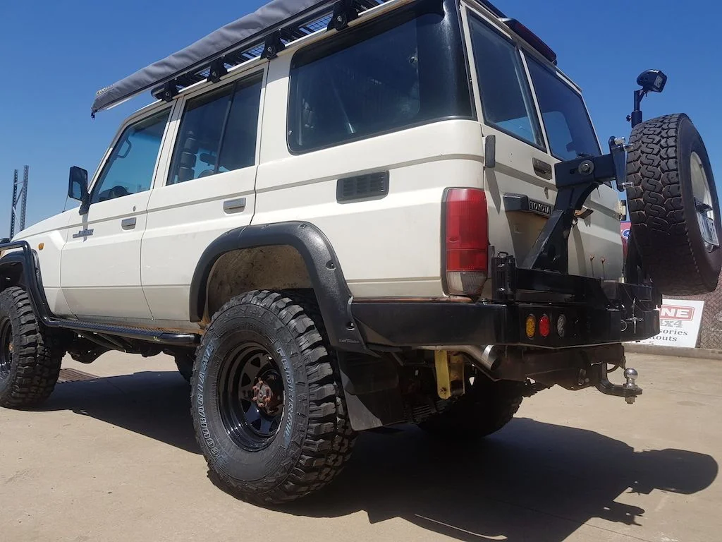

Definitely flares, but the right offset wheels are hard to find otherwise, spacers are required.
Not factory flares but definitely flares :)
Pretty sure these would fit the rear of a 77.
