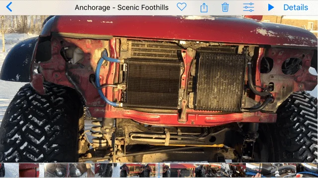

The factory chevy rad had an oil cooler with lines running from just above the oil filter. I see now that everyone just blocks those cooler ports off.
Not the best pic, (sorry, clipped from a video I posted elsewhere in the forum)
The AT cooler on the right is the OEM Toyota cooler. The lines route from the Chevy AT into the bottom of the OEM Toyota radiator on the PS, then out the DS to this cooler. The cooler on the left is an aftermarket oil cooler, and has lines directly from the Chevy engine.
(the paper clip at the bottom is the OEM power steering cooler)

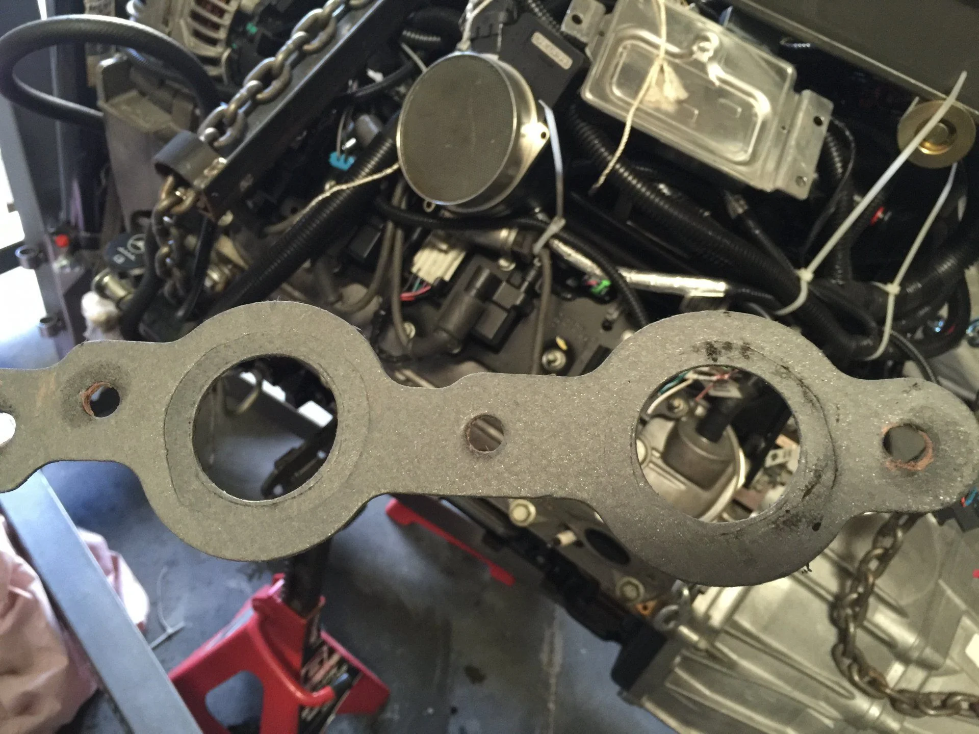

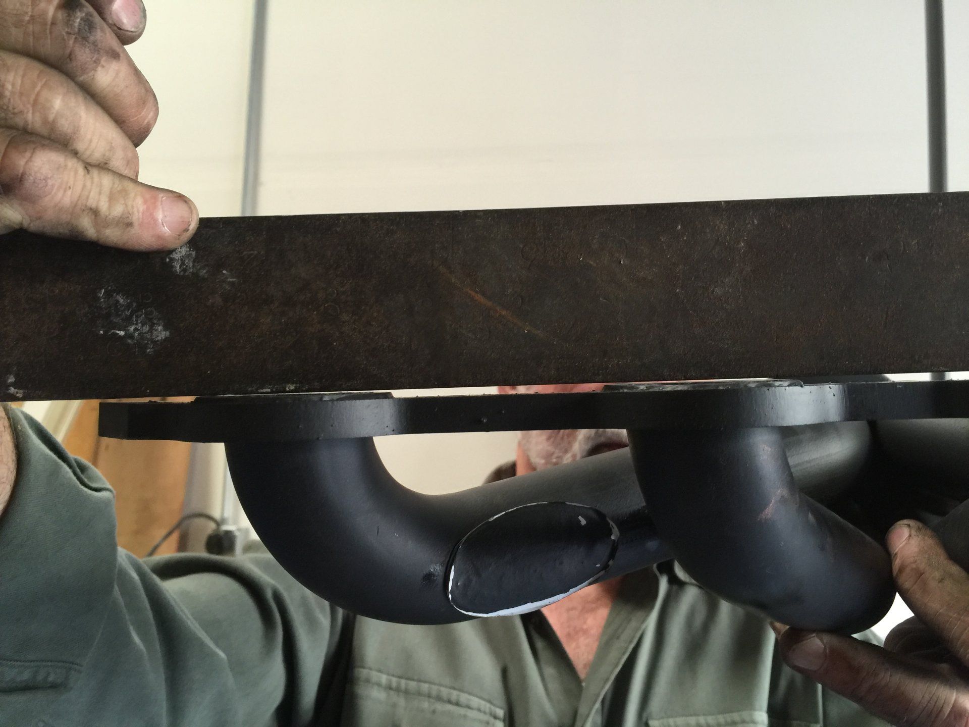

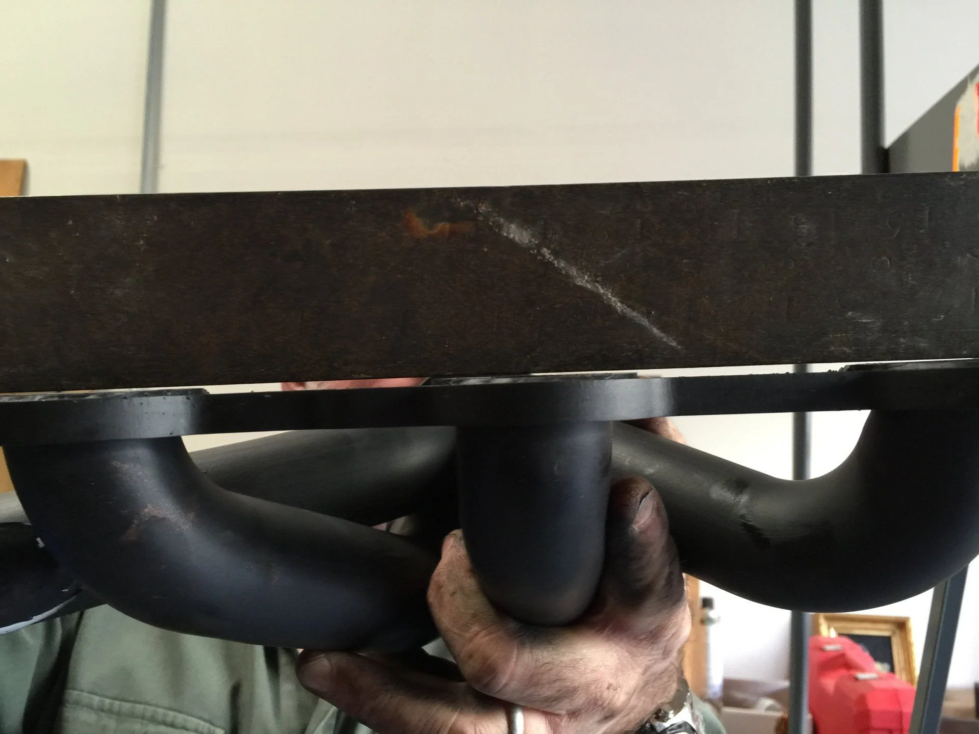

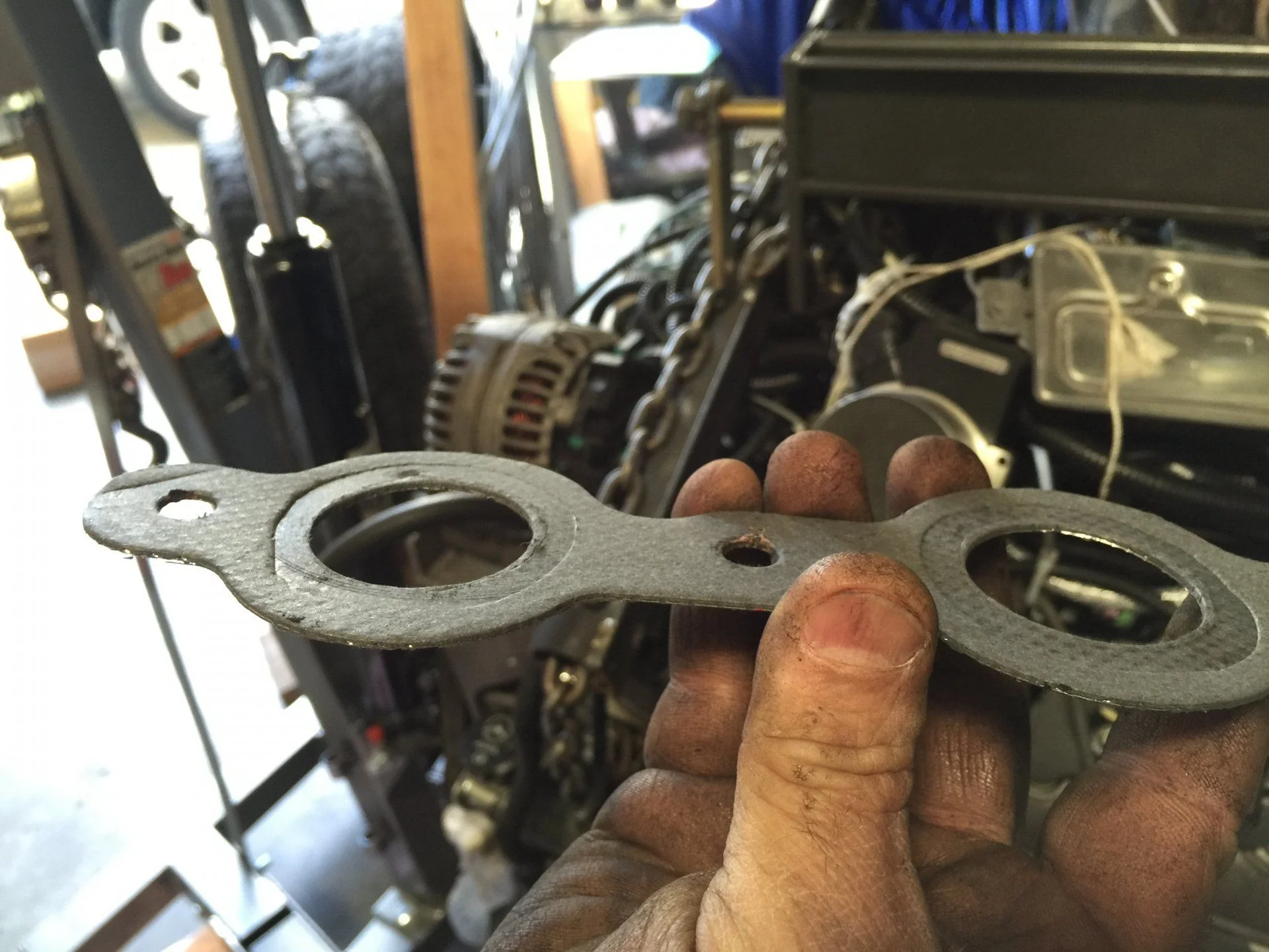

Ran into a little issue in preparation for test fitting my engine. I noticed after I had torqued up my Hooker Headers (PN 2312HKR) that they didn't look super flush with the heads. I decided to be cautious and pull them off again and investigate. Thank god I did. Upon inspection, the tolerances on the headers were so off that they weren't making uniform good seals with the gaskets. As you can see from the photos, the imprint of the rings just isn't there in certain sections. I'm currently waiting to hear back from Hooker, but it hasn't been the best customer service interaction to date. They are very concerned that I bought the headers a year ago and have only got around to installing them now - not sure how that is particularly relevant, but we shall see. Hopefully they send me a replacement set. Either that or I'm going to have to take them somewhere to be re-surfaced for $50-75. Hopefully this get resolved soon...
UPDATE- Hooker is sending me a new set of headers free of charge- very nice of them. Apparently they changed the way the headers are designed and no longer use the raised flanges around the exhaust ports on the heads and are now flat planed all the way across the header. I'll post pictures of the new headers below.
