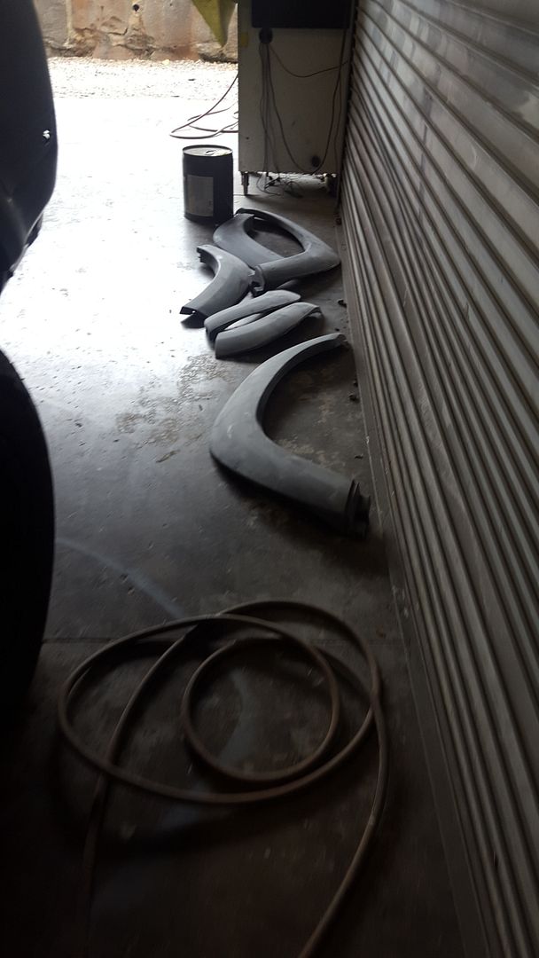

I'm currently doing my flares, If you want new seals for your flares try toyota part number PZQ50-33096, found this is $7 a packet for 2m vs $45 a packet for the 80 series one.

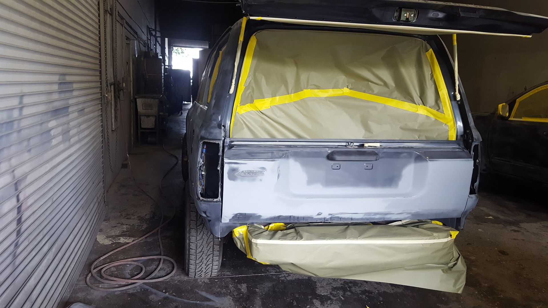

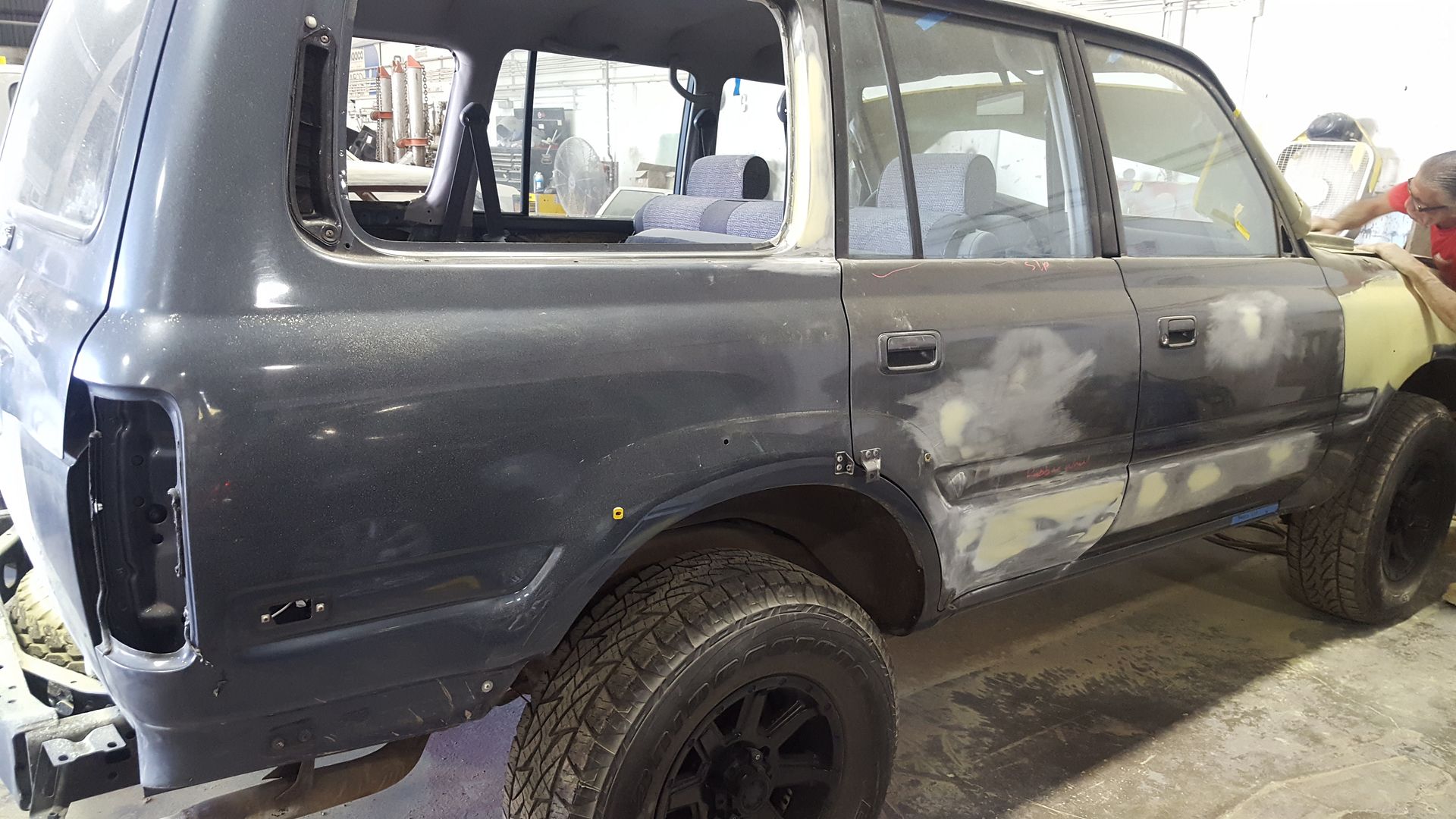

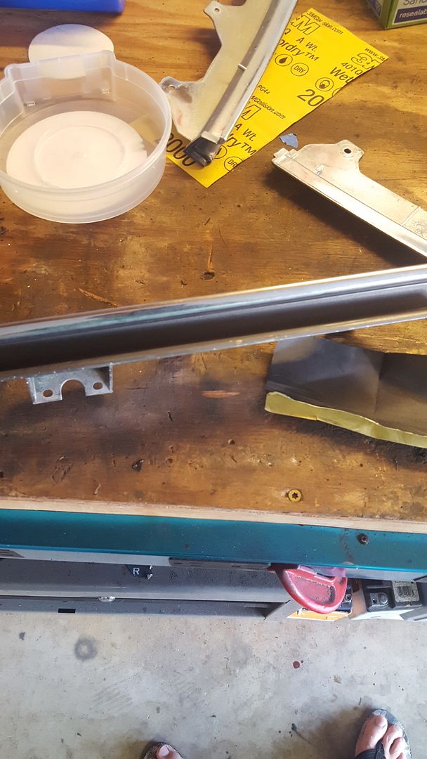

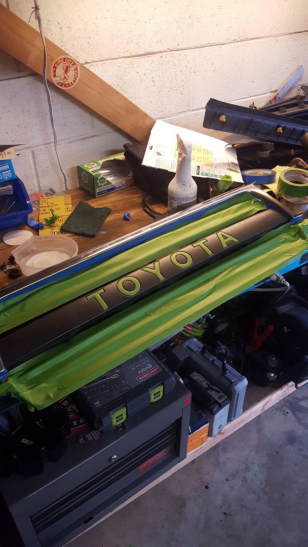

Not much going on today. I had to order a new rear window seal. Dropped it off for some paint and body. Started on blacking out the grill and other misc. chrome pieces. I have started to notice that it doesnt start idling rough until it warms up. hummmm

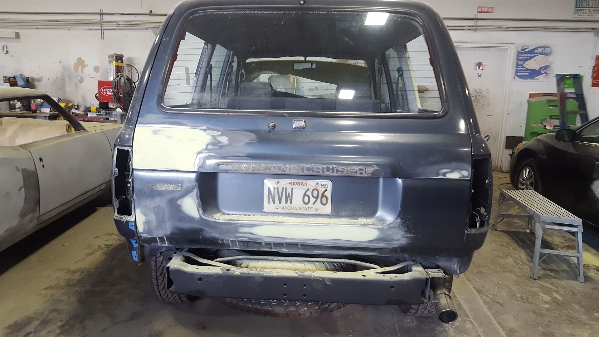

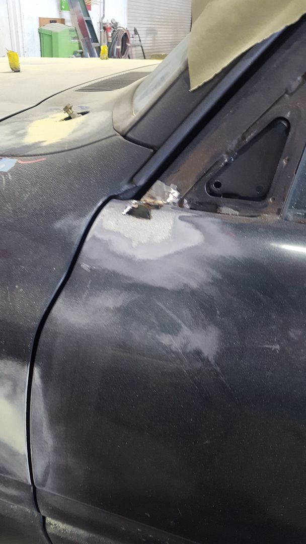

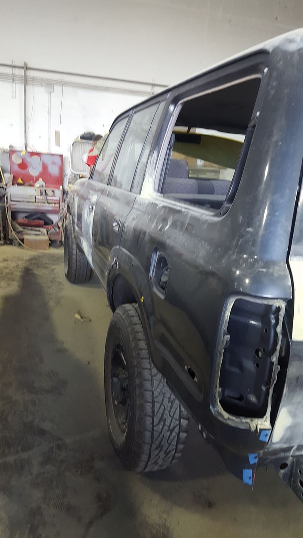

nice work! please post pics of how you fix the rust in the rear window, interested to see how that goes.
Thanks. I would but it has already been repaired. THere are a few ways of doing it but the best is to cur out the rust and welding in new metal. Some will also cut out and use fireberglass.

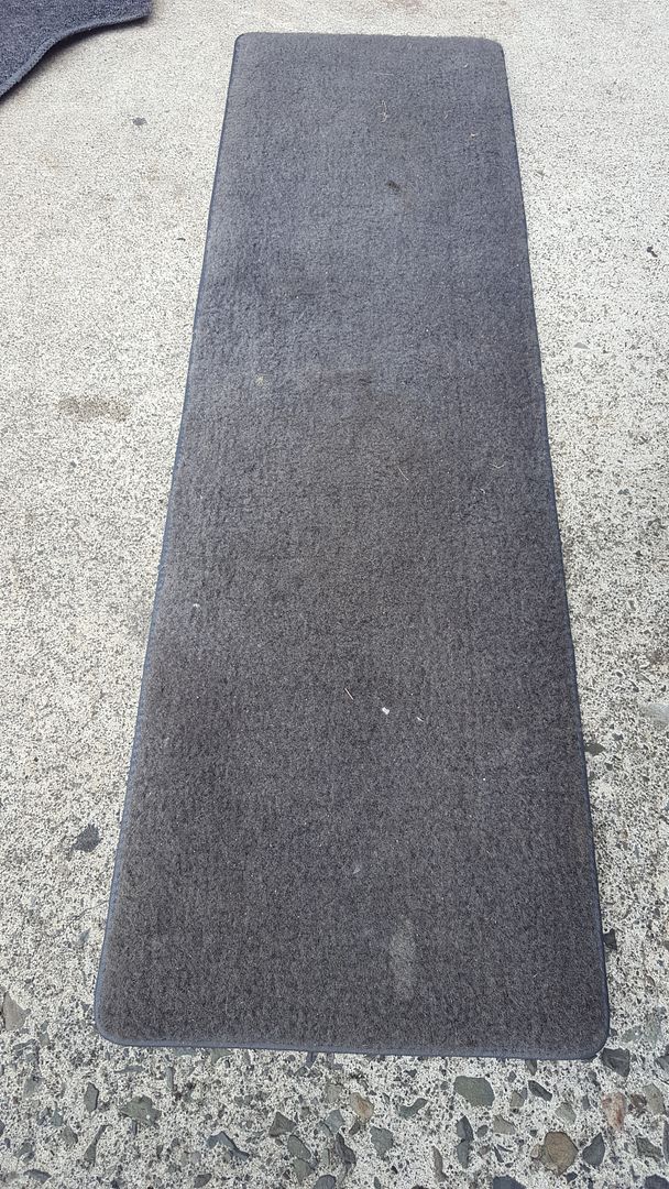

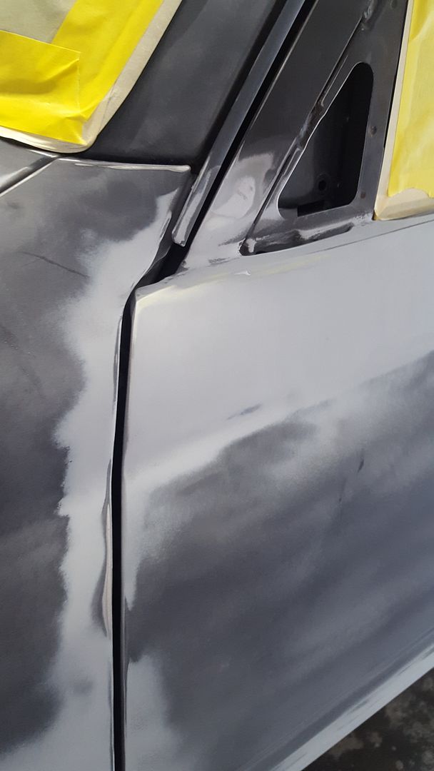

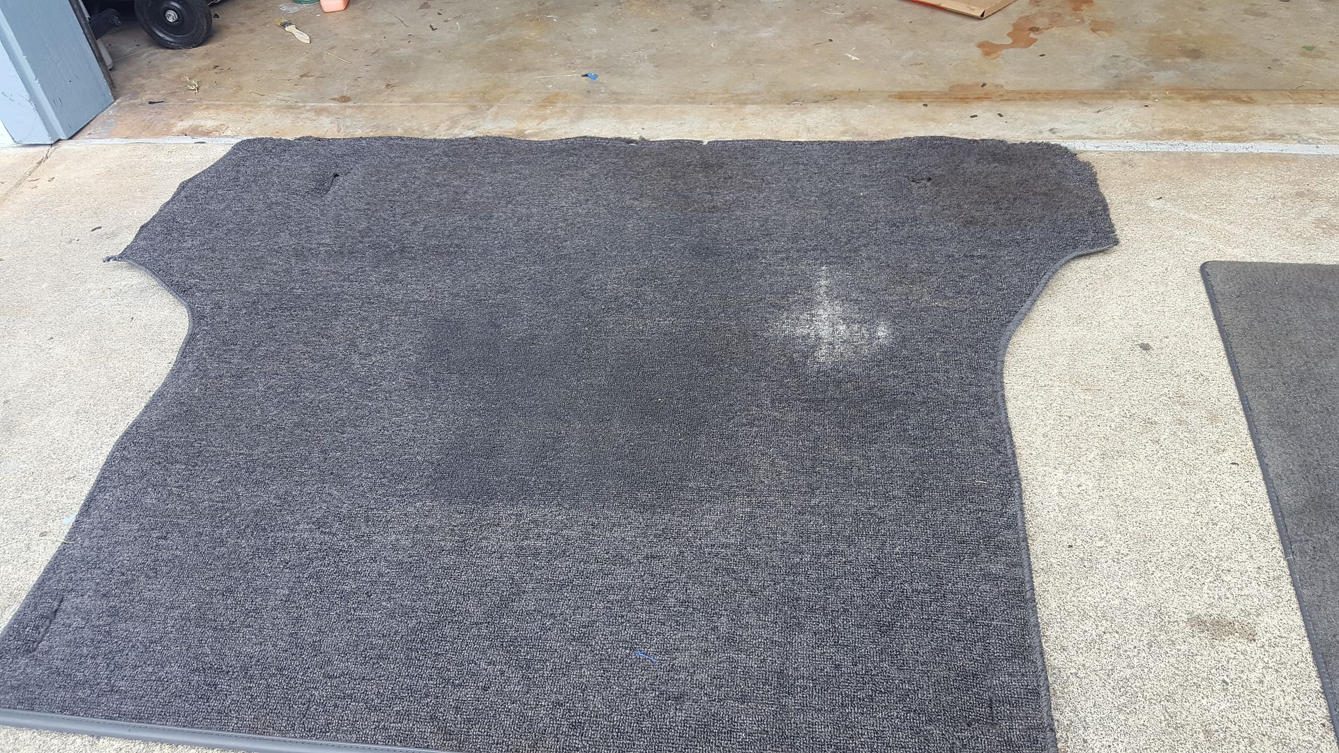

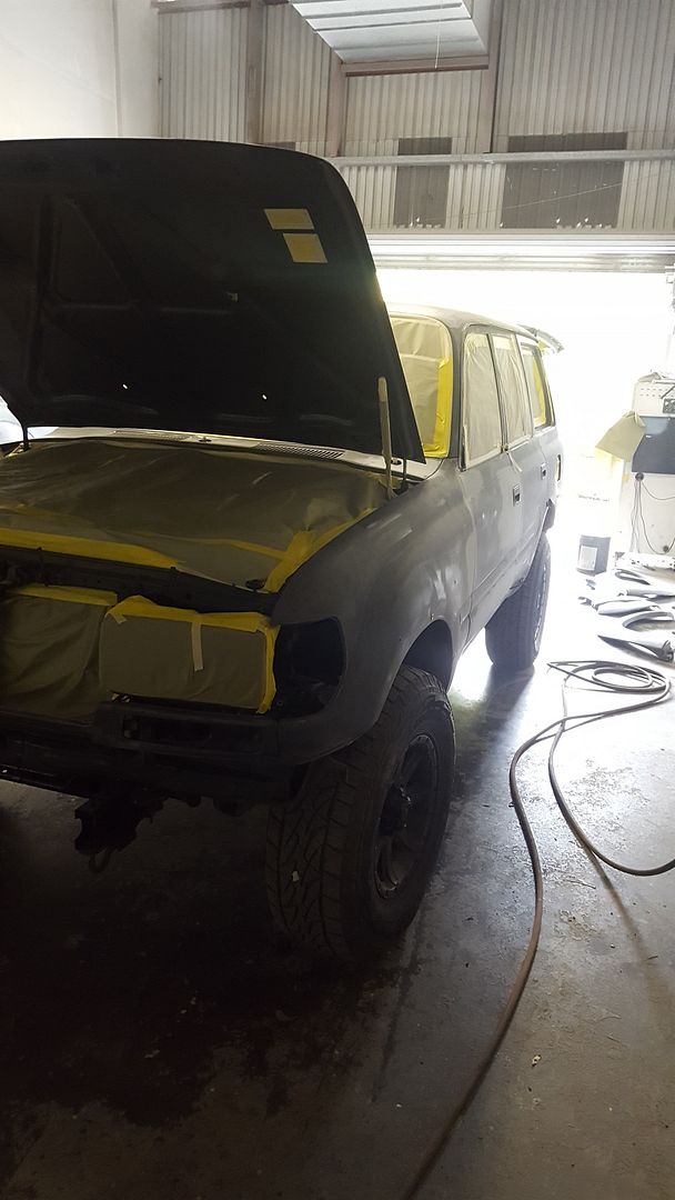

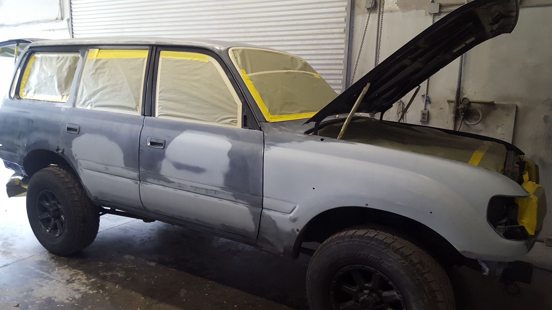

Still waiting on the truck to be finished up at paint. While waiting I decided to wash the rear carpet( nasty) and gather parts for the trash. Also started some CAD progress for the rear bumper. Thinking about running dual swing out/ rear light/ ect. Thinking about going with 35's and some trail gear sliders.

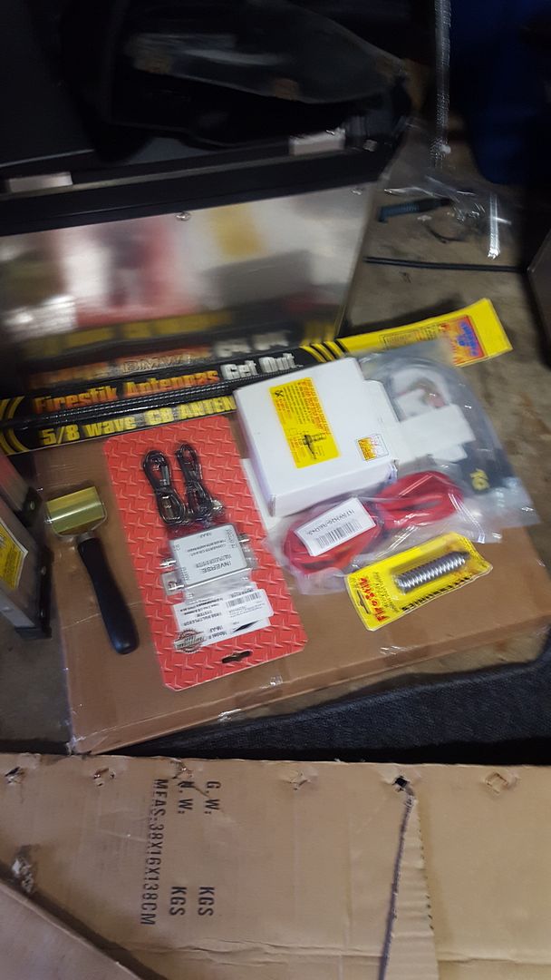

Oh...and some parts got in

Alsoi love the early cloth interior. Can you sow a few ore picture of it?
The rust has been cut out and replaced with fresh metal. No need to ruin a good cruiser to get the frame. I will post a some more interior pics in few day...the cruiser should be done this week.
Nice!
Same color?
Nope...I went with the new Toyota trd pro cement
