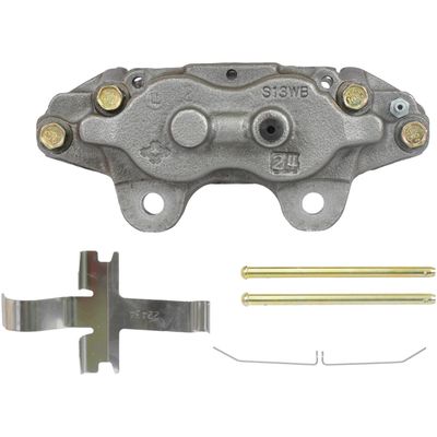

I ordered -Brake Caliper – Front 1990 Toyota Truck Pickup 4WD (6 cyl) 3.0L FI 6cyl, and -Brake Rotor – Front 1986 Toyota Truck Land Cruiser 4.2L 2BL 6cyl for my front end and want to confirm I don’t need any other parts.
According to Marlin this should work but I don’t know if I’m missing something else. https://www.marlincrawler.com/brake/caliper/v6-ifs-front-brake-caliper
Do you have the large pattern hubs?

I tried to order 95 4 Runner calipers from the auto parts store but one of the sides is backordered so I ordered the 1990 Toyota Truck Pickup calipers. I don’t know the difference other than they had different part numbers. In a nut shell I don’t have a clue what I’m doing or exactly what I ordered and figured I better starting asking questions now before I go too far down this path.
The brake lines will need to change. The flexible ones at each end, I believe they need to be longer to allow for more travel. Have not done mine yet but I think I remember thinking that when checking it out. I assume you could just order lines for a newer fj55 or 60 that came with disc.
Looks like factory 1985 60 calipers have one large and one small piston.
3
89-91 calipers with casting mark s12wb have four 43mm pistons.
3
92-95 calipers with casting mark s13wb have four 45mm pistons.

Thanks guys, I’m getting ready for round two on axles rebuild and it was mentioned to me that I should look into the V-6 4 Runner or V-6 Mini Truck caliper upgrade but no year was mentioned nor any other parts I might need to make this work.
So I incorrectly assumed all later V-6 calipers were the same and ordered s12wb’s when the driver’s side s13wb got backordered and rereading my original I can see it’s not clear what I’m asking.
My Toyota knowledge is very limited / nonexistent and I’m asking if someone has done this upgrade on a 60 front axle and used 15” rims 3.5 back spacing and if they could offer some assistance.
This is where I’m at now,
1) I have a set of 1986 FJ60 front rotors coming.
2) I have a set of 1990 V-6 Toyota Truck calipers coming (s12wb).
3) I have 15” 3.5” backspacing rims.
4) I have the 1986 FJ60 hubs and backing plates.
5) The brake lines will be aftermarket so length is not important to me at this point.
6) Is the change from the stock 60 caliper to the s12wb worth the effort?
7) Will the sw13wb caliper work with my setup and should I be looking for a set of them?
8) Am I missing any critical parts or process to make this change?
