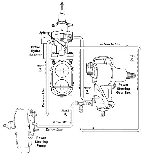

What type of vacuum are you using? Wonder why the hydro boost systems won't work.
Turbo diesel has no vacuum to run a vacuum boost without some sort of external pump.
The hydro boost unit has an impossible to buy internal rod with a springs and spacers that pushes on the master cylinder and when you buy a new unit they say to reuse your old parts because every model is slightly different, I never had an old one so I made a rod from some specs I found on the internet. Long story short the combination of Astro Van hydro boost parts I bought never worked all that well so I started reading the internet again and bought some complete full size truck units hoping to get some matched parts, the tolerance on the rod is +0.000”/-0.005” so I always blamed the one I made for some of my issues.
After reading more on the best setup I finally called a real expert and decided to stop stepping over dollars to pick up nickels and buy an aftermarket master cylinder designed to work with my parts and stop trying to piece together a system from miscellaneous donor vehicles.
On the bright side after three days of wandering around the local junk yards I now have a bucket of hydro boost’s, a tool bag full of the magic hard to find rods, springs and spacers, bloody knuckles ( I really should check when the last time I had a tetanus shot) and $300.00 less dollars in my wallet.
Hydroboost runs off the power steering pump.
