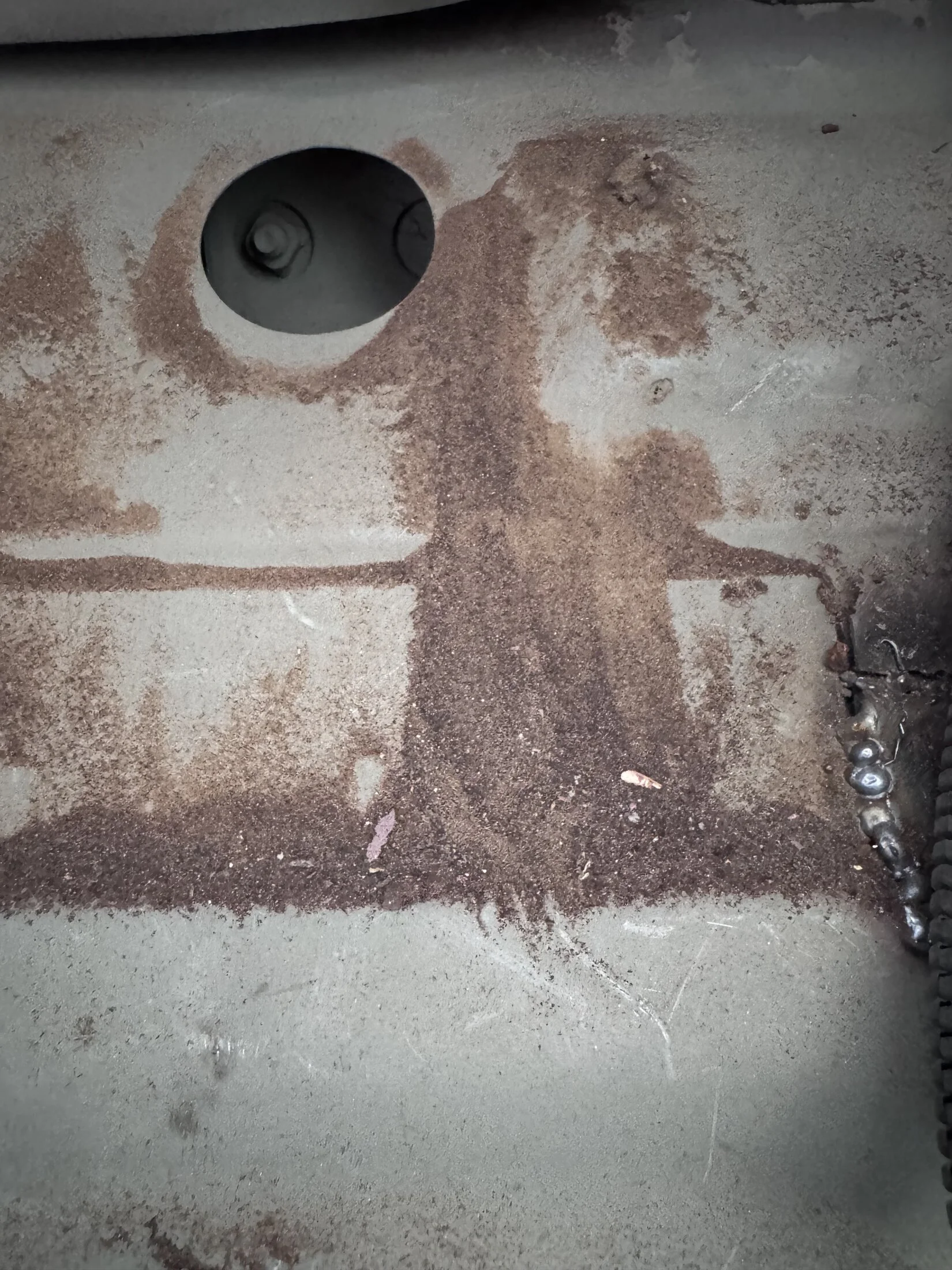

Also I’m doing insulation work everywhere, I might have to do vintage air because my condenser is dead and the whole system is so old it’s rusty and super dusty inside looks terrible lol

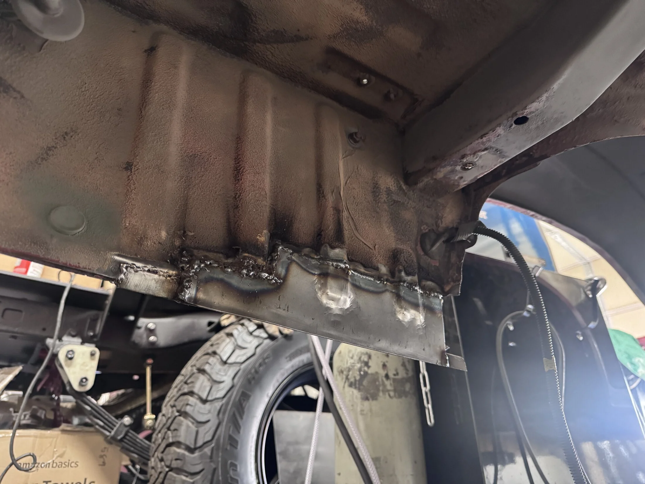

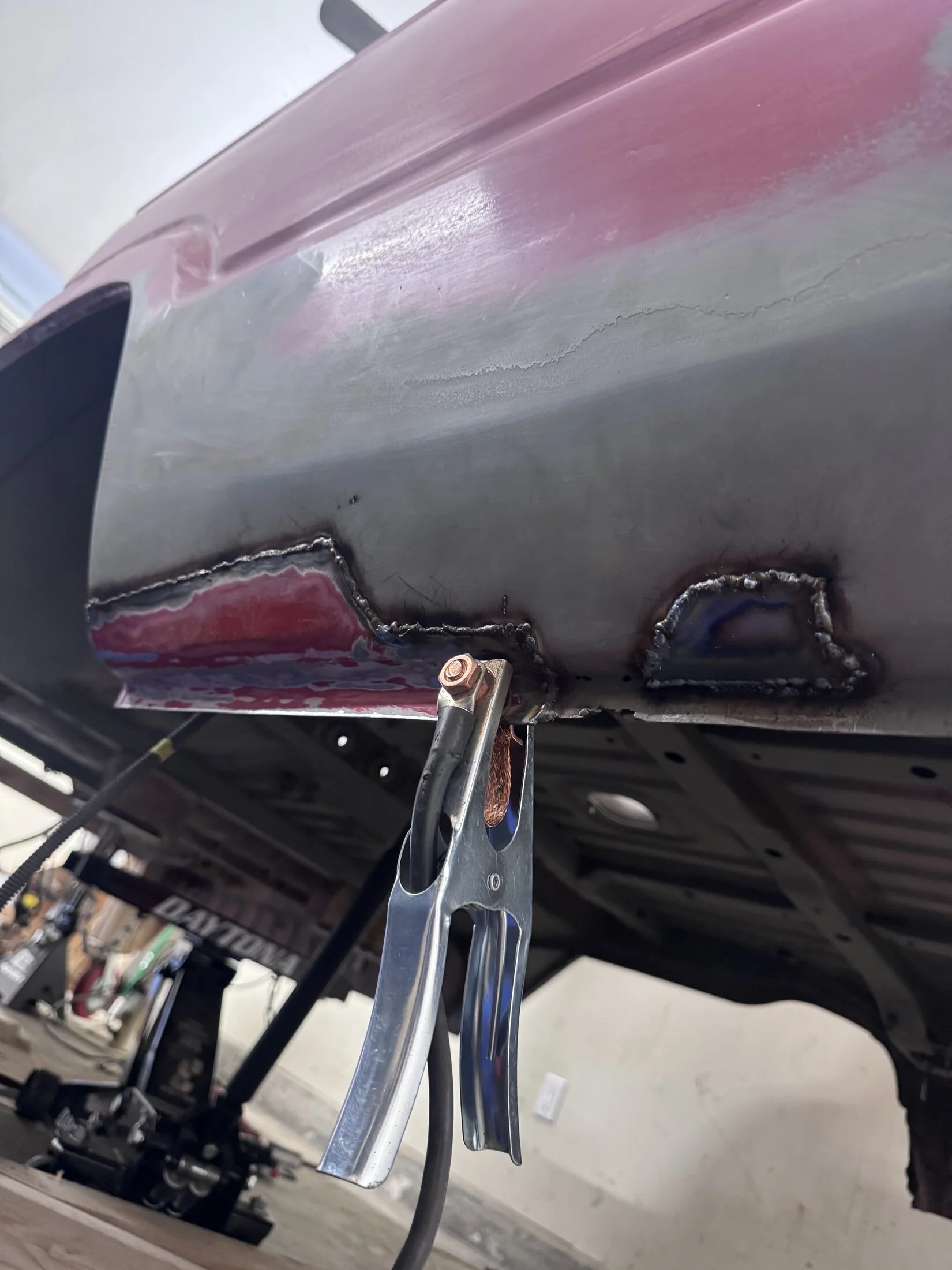

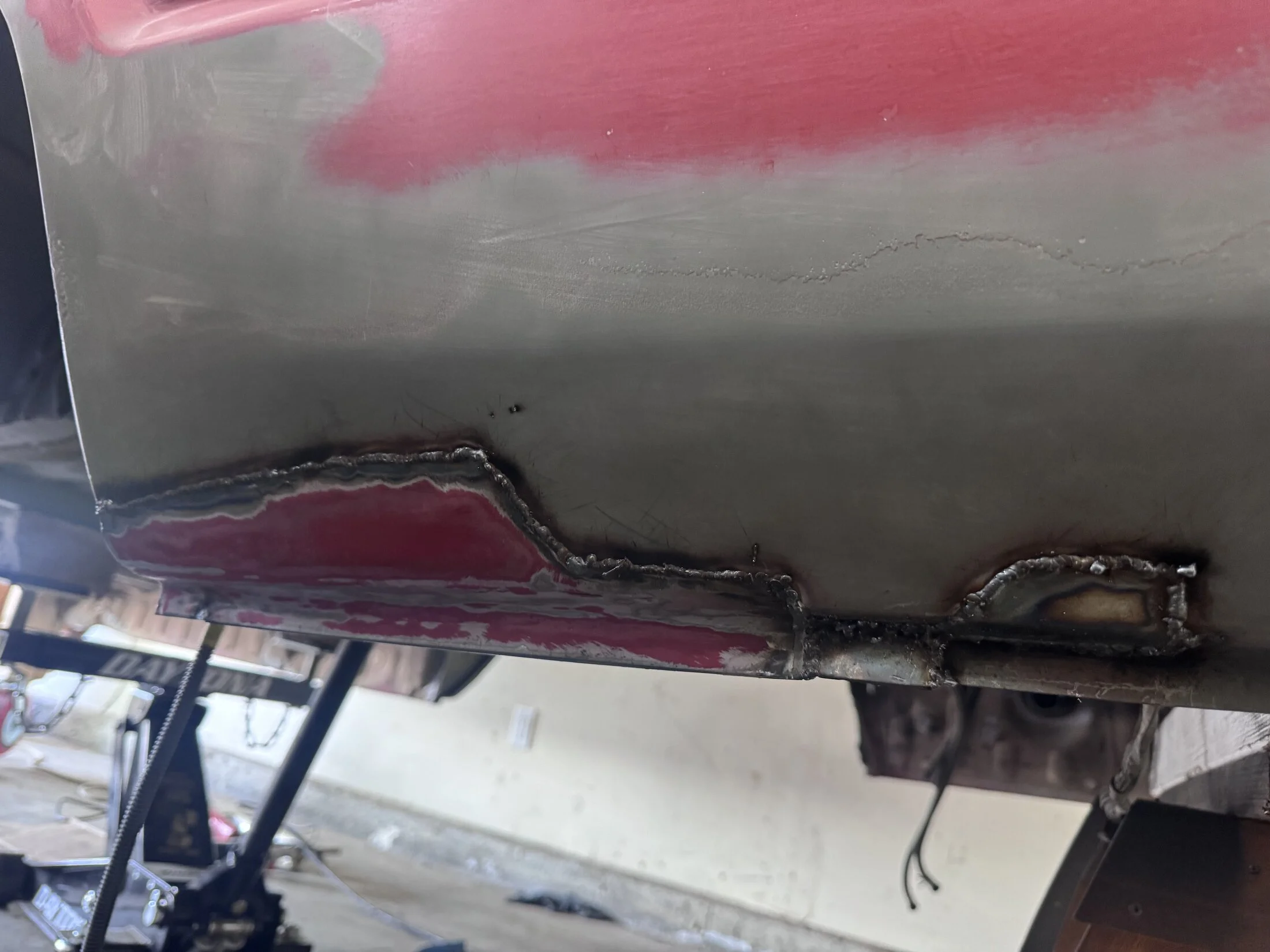

Finishing up all the welds finally. Almost Perfect

Nice welds.

Nice welds.
My trucks been parked for like 20 years and the inside of the components is disgusting lol like the knobs don’t work good and there’s tiny rust spots everywhere plus plastic is so old it’s like cracking

Cleaning up the welds today making it nice and clean.
