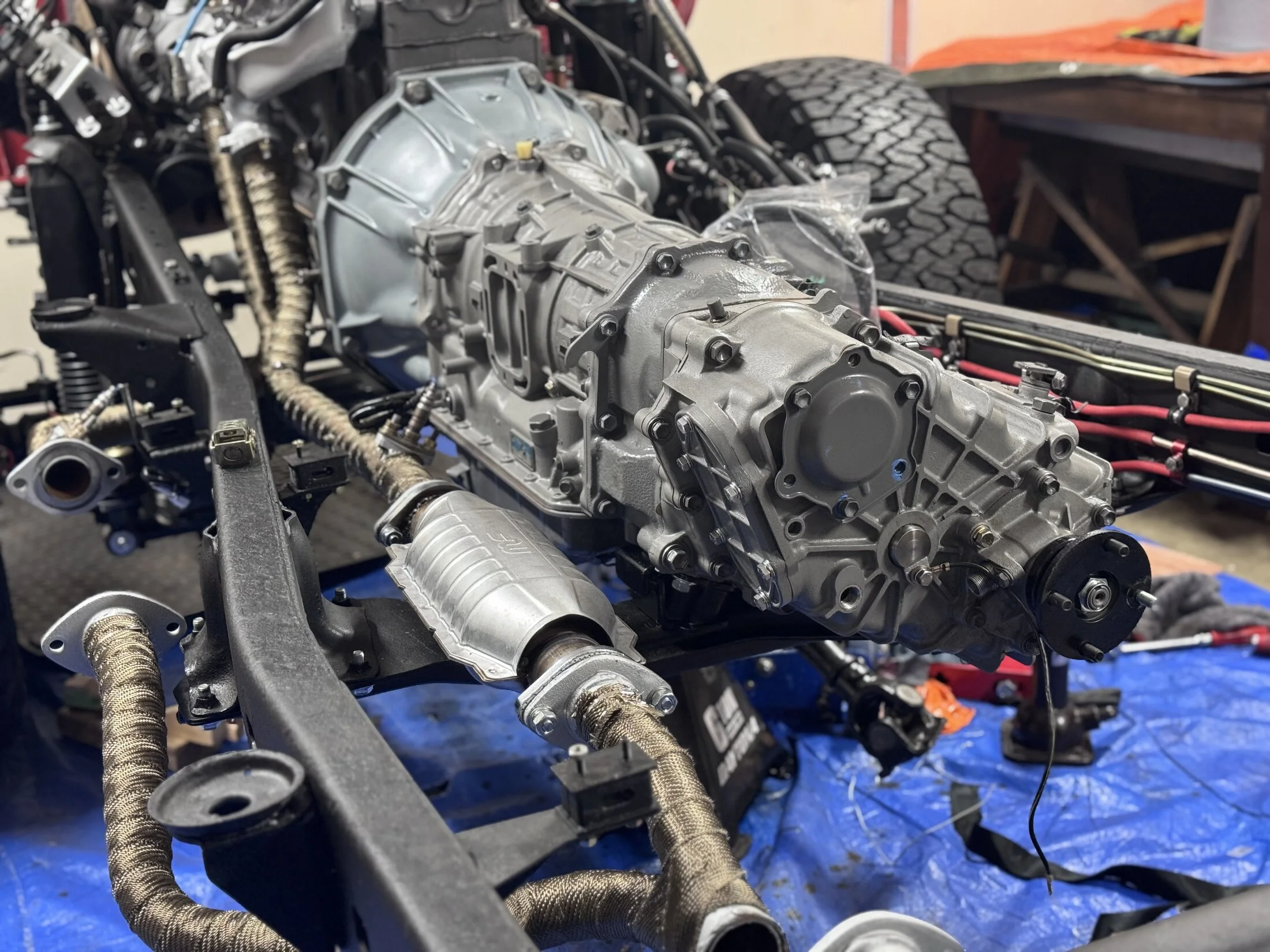

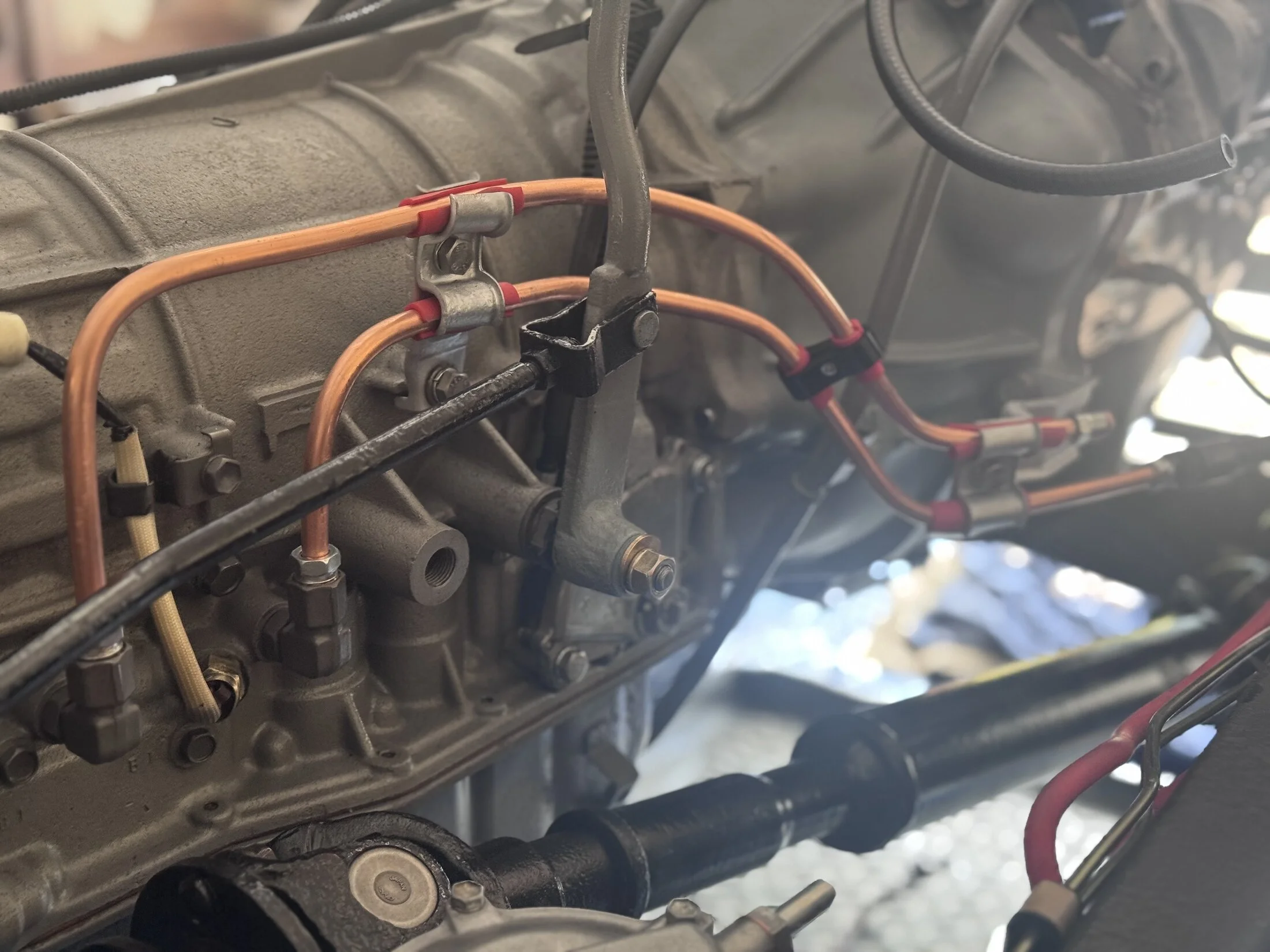

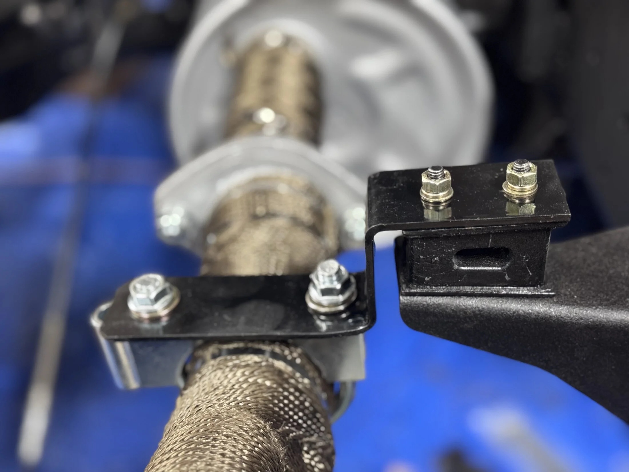

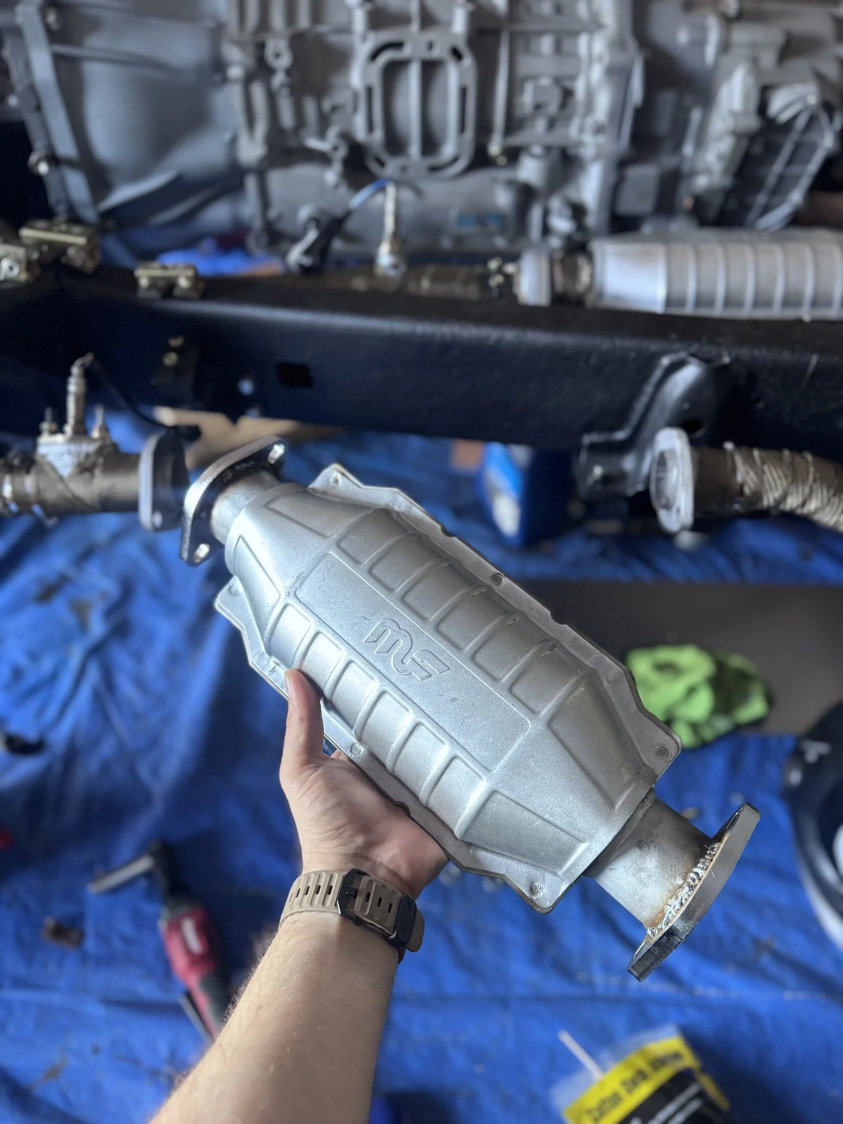

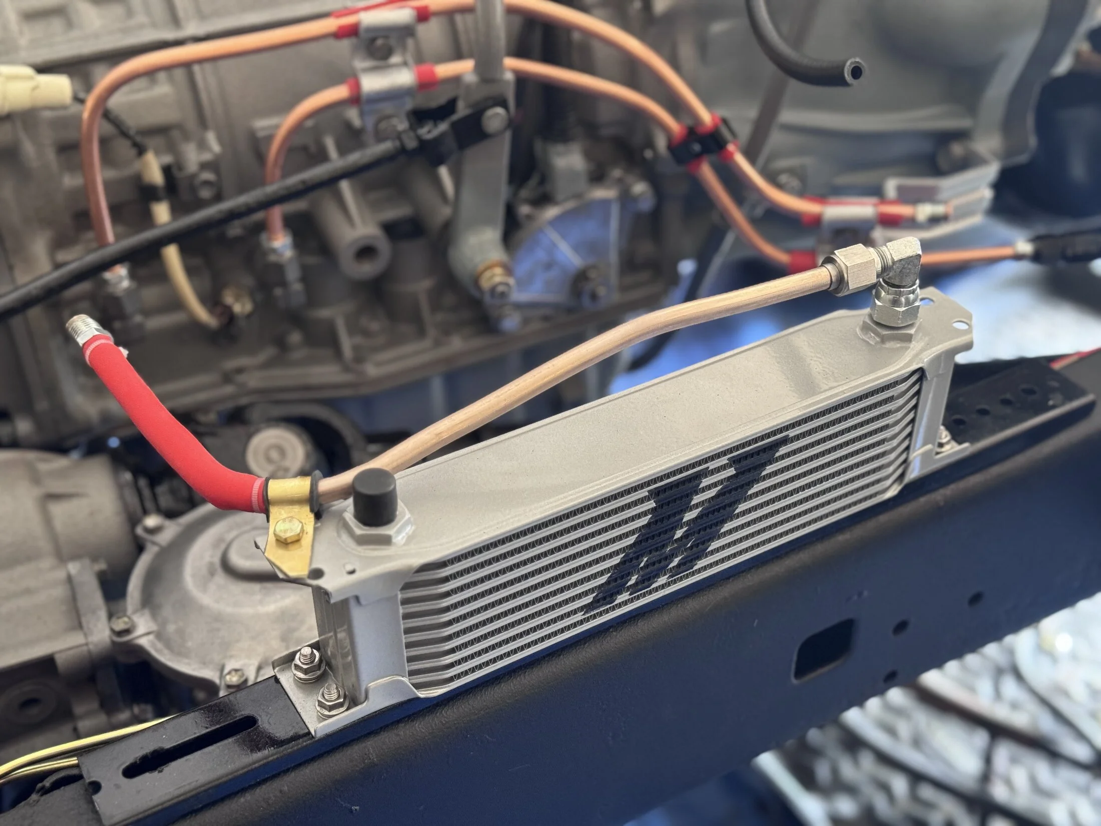

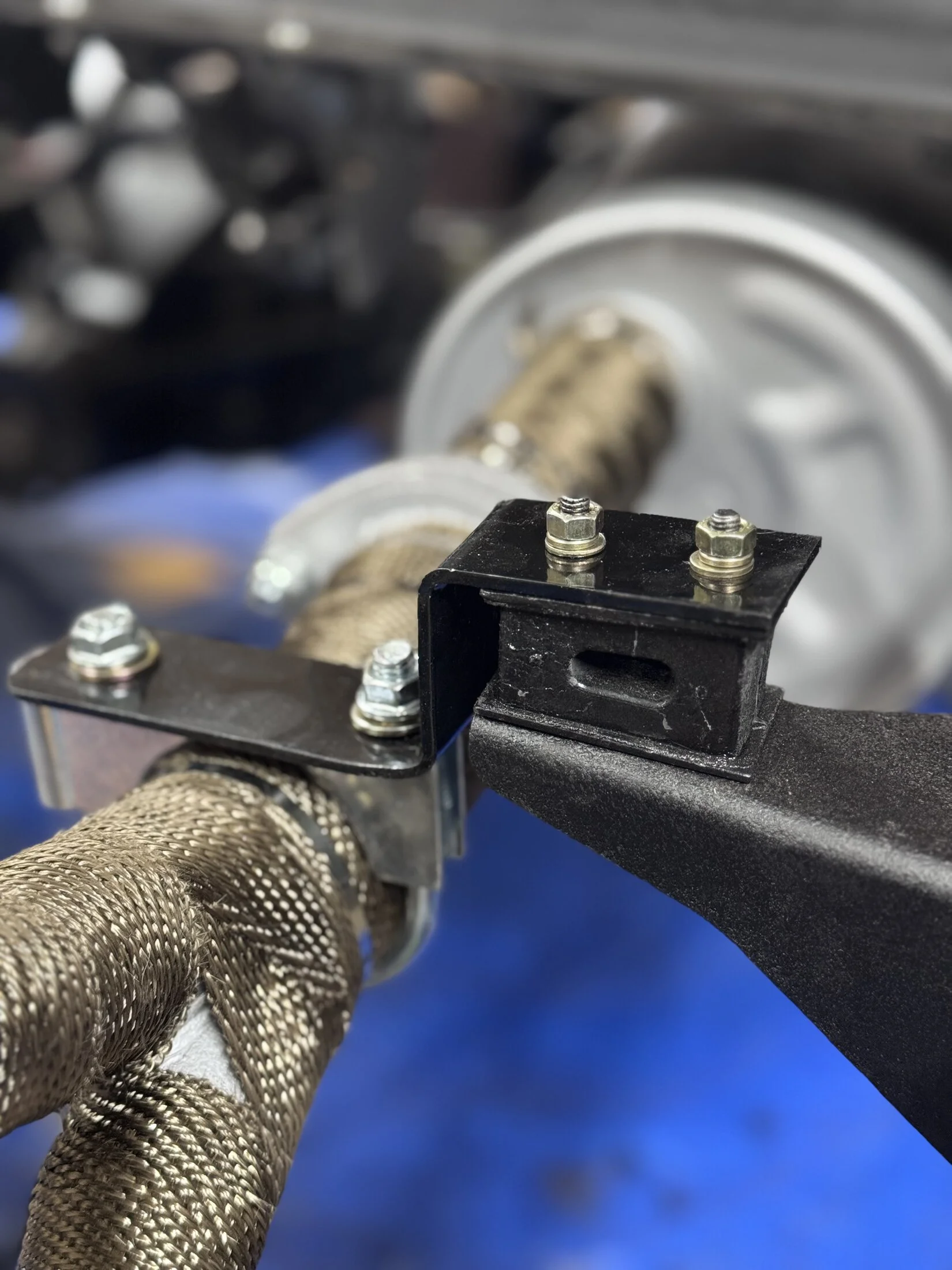

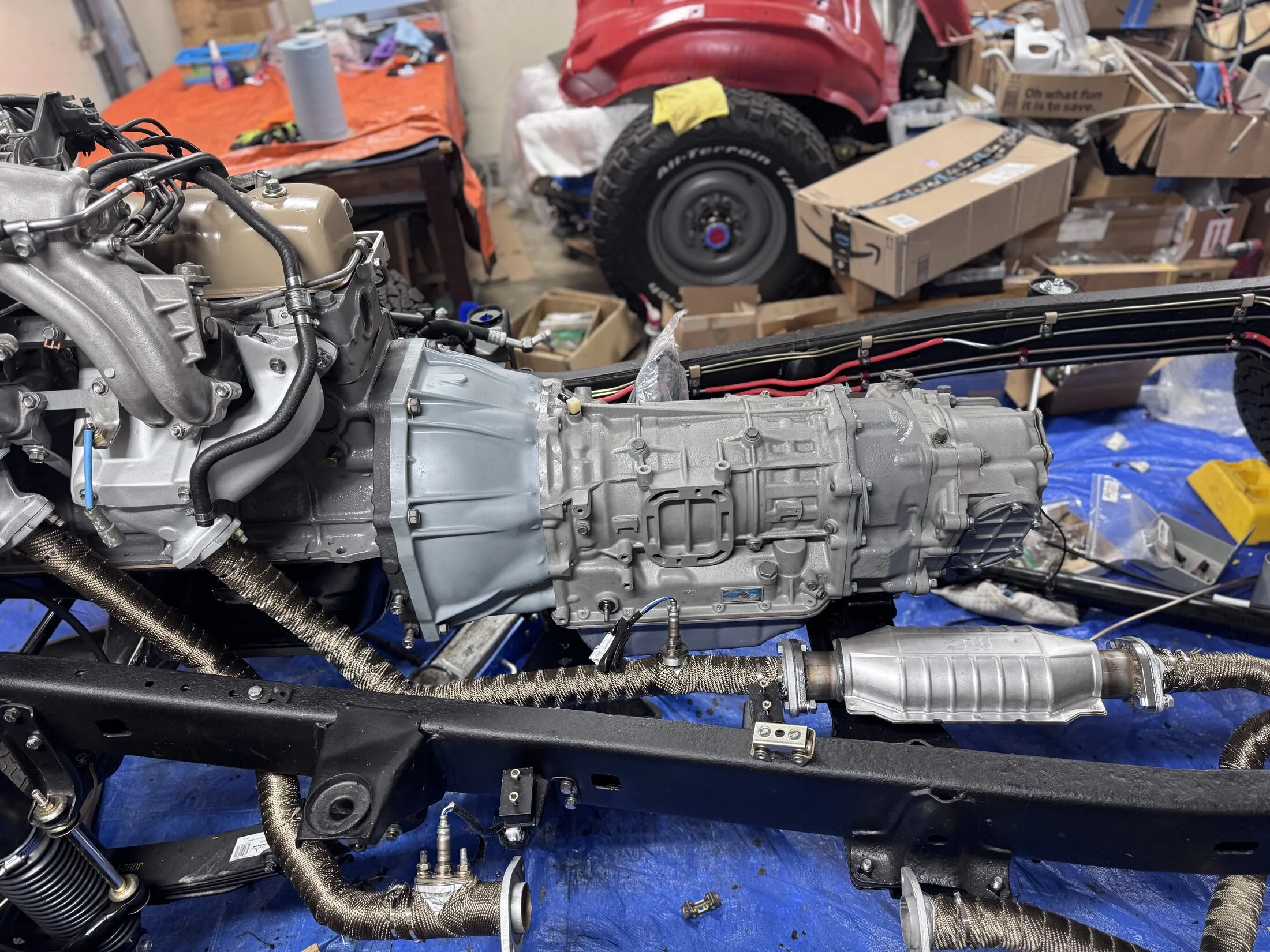

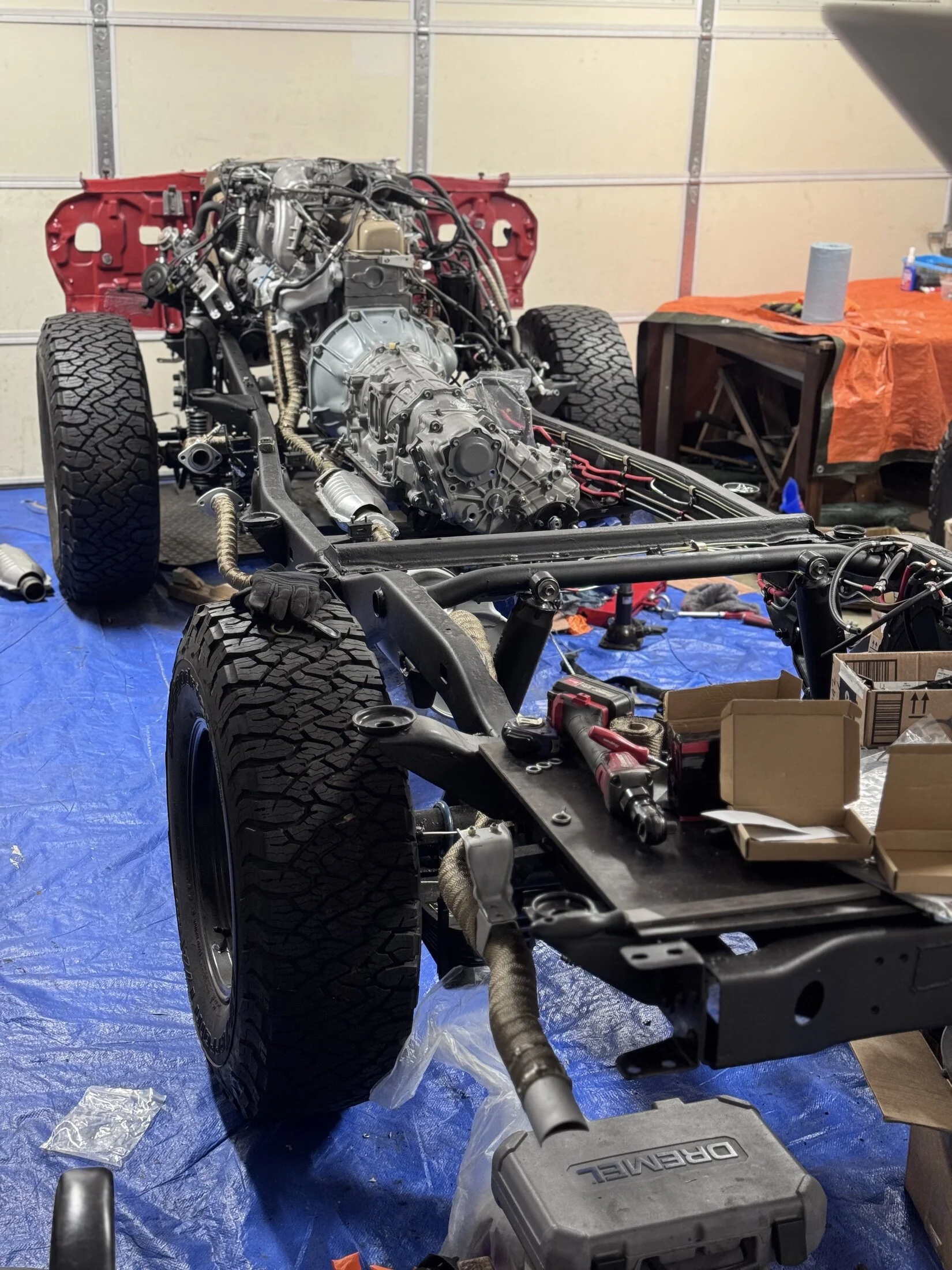

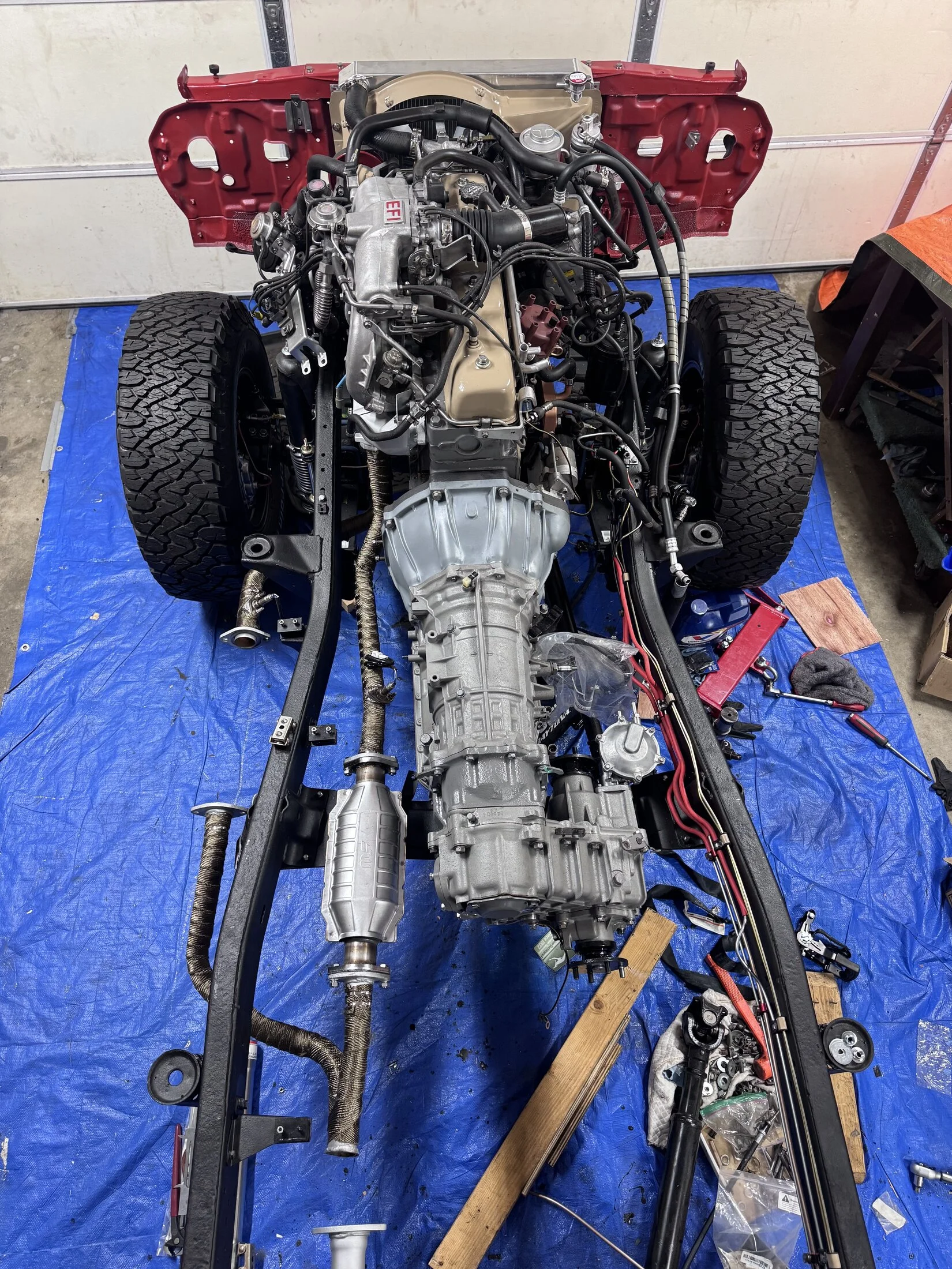

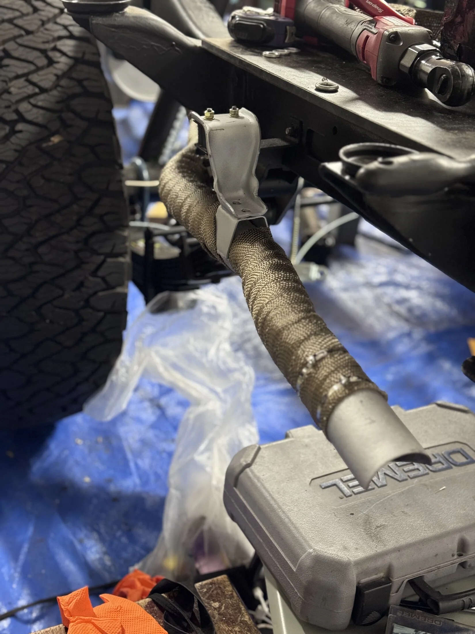

Transmission is on the chassis. And it’s all brand new. + exhaust wrap top to bottom.
Every time I look at your build, I realize what a slacker I am…. Could you please half a$$ just SOMETHING?!

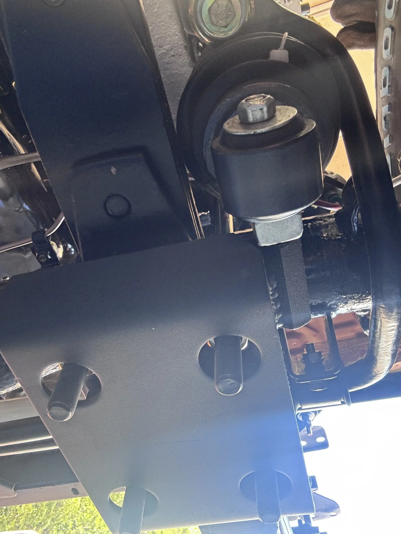

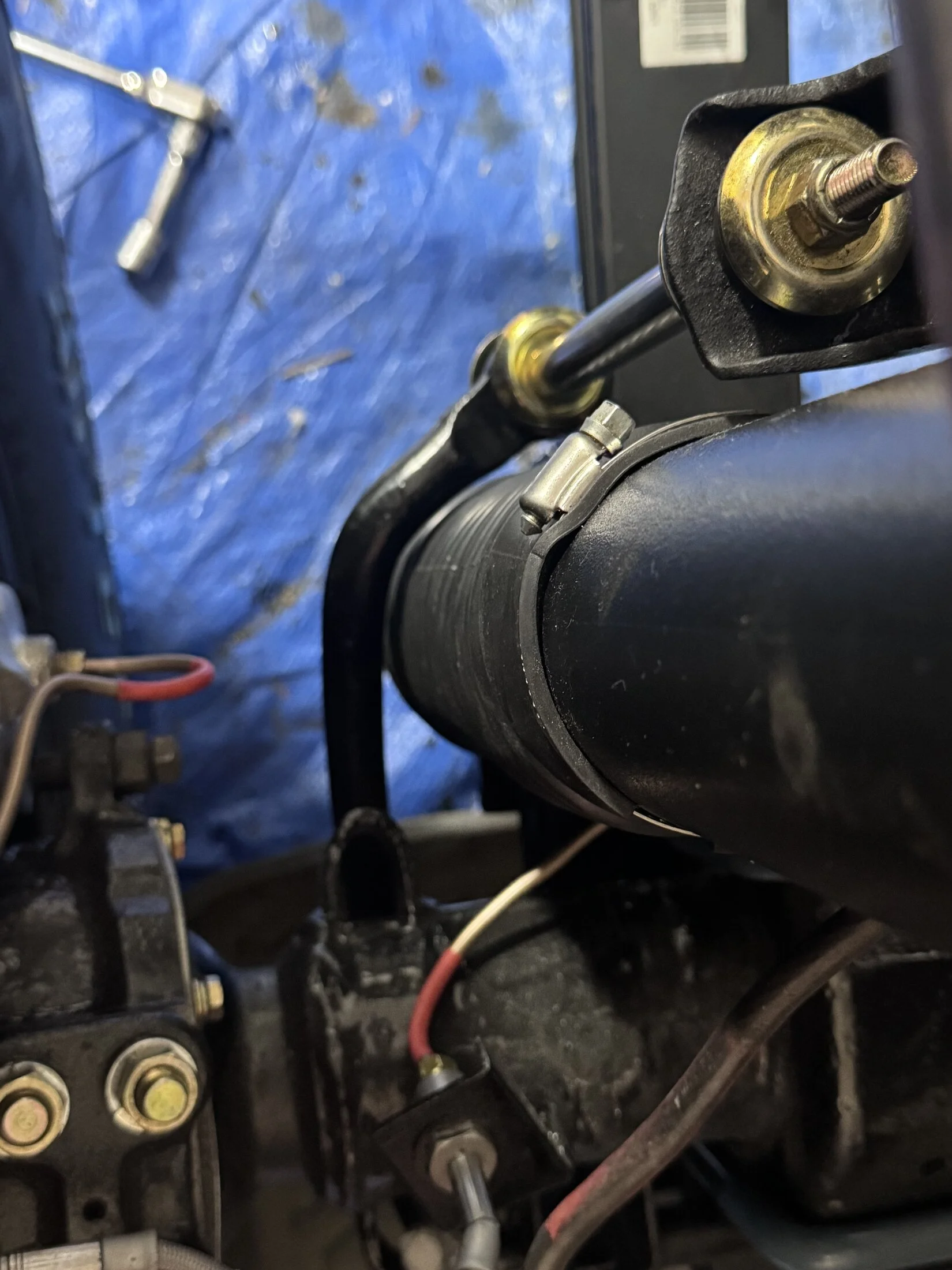

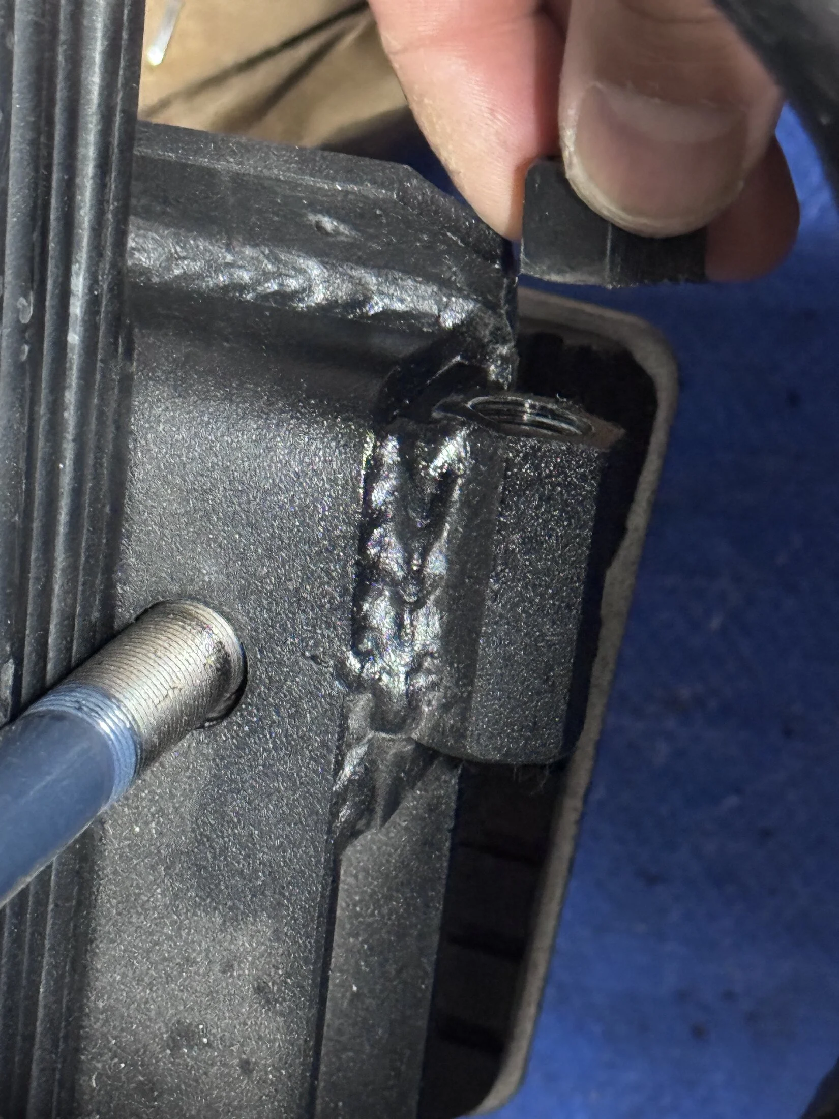

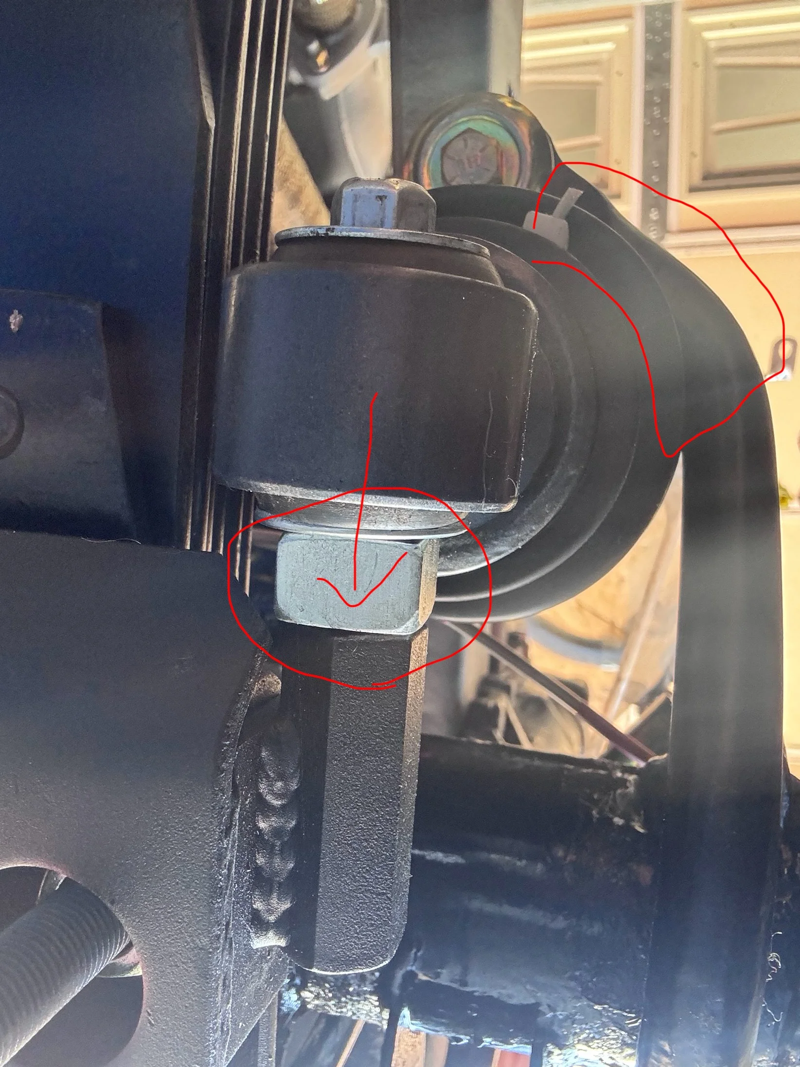

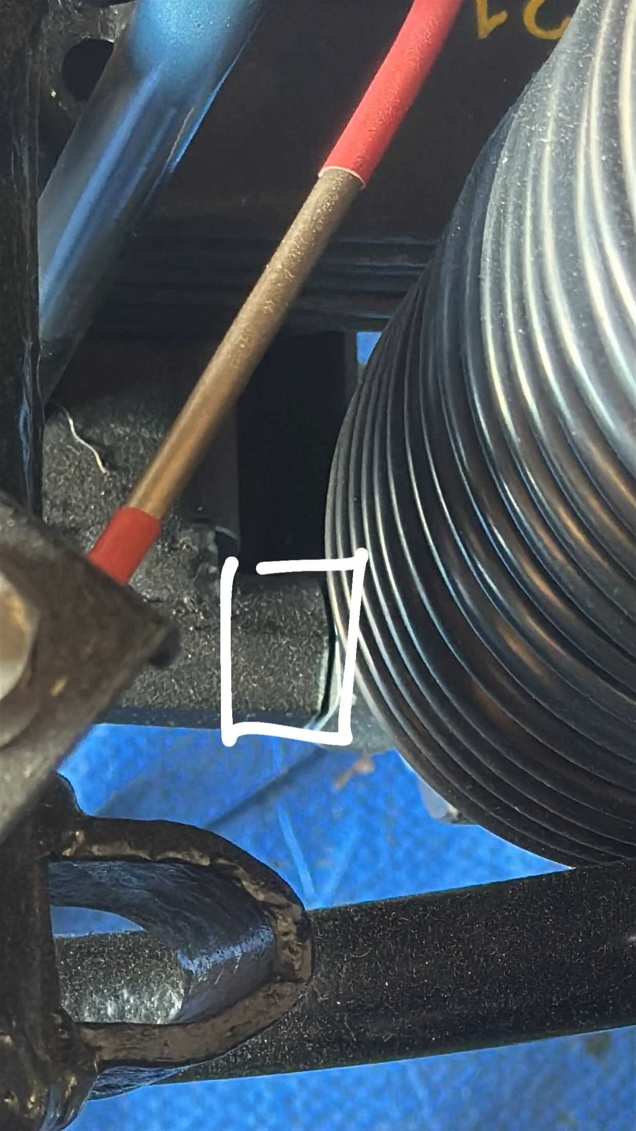

So with the Ironman lift kit and the specter off road u bolt skid plates there’s a pickle that some people might run into
The u bolt aftermarket bolt pushes the shock closer to the bar in the back that it touches,
So I’m going to cut off a piece of the skid plate because the thread is so long, it’ll push the shock on the bottom an inch forward so it doesn’t touch anything in the back

I still get the hives when I see an A440f…
Why? Lmao it’s a good trans if valve bod is adjusted correctly and the kick down cable
