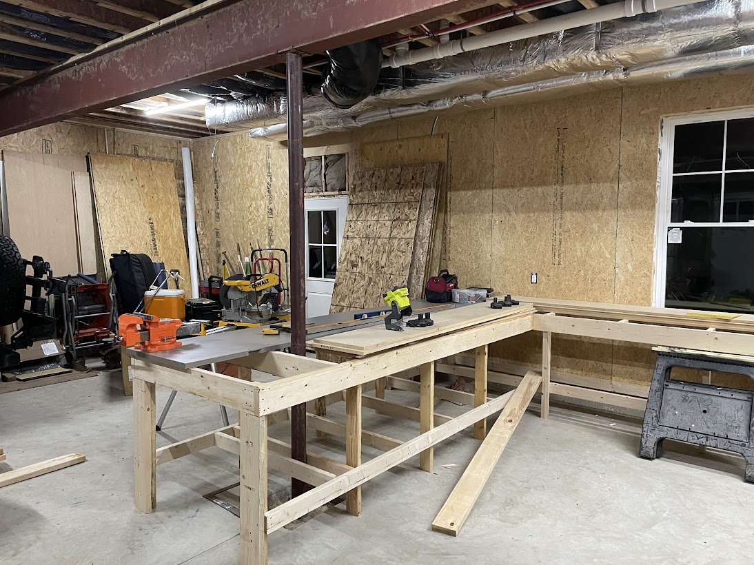

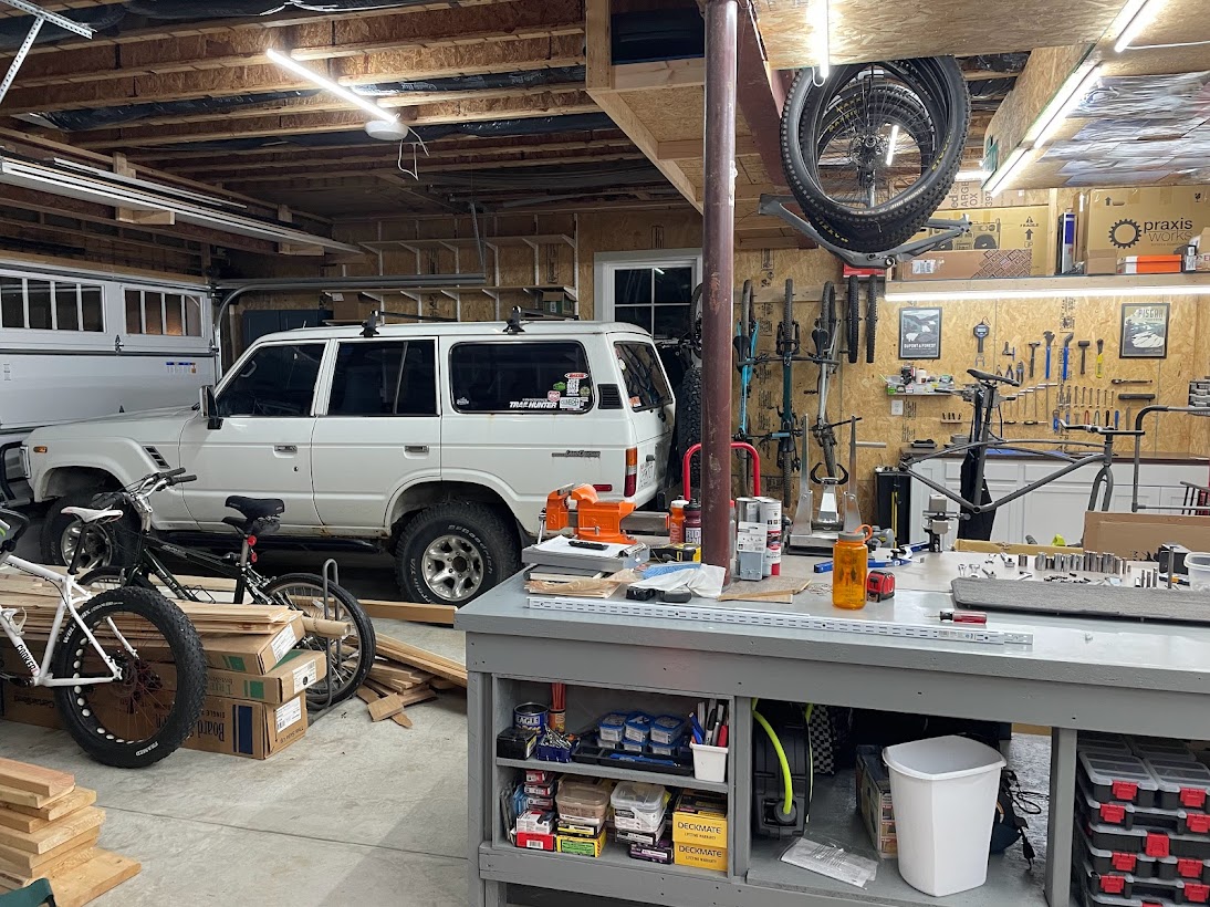

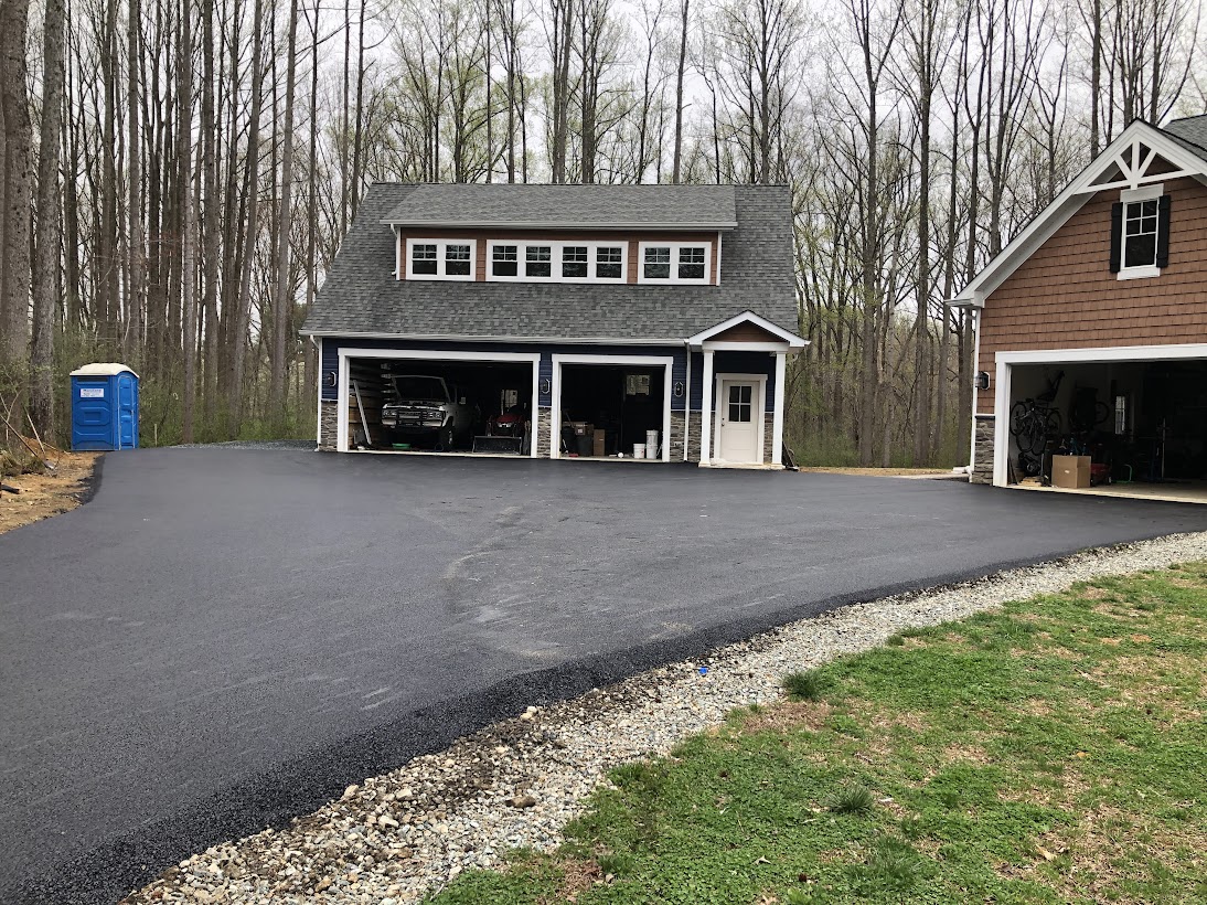

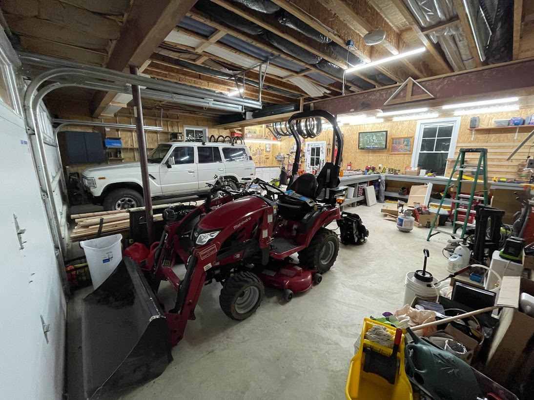

I'm a custom homebuilder by trade, when I built my house about 4 years ago I purposefully positioned it on the lot so that I could easily add a detached garage later. Even though my lot is Zoned Agricultural, our local building code stipulates that you have to have your primary structure 100% built before starting construction on a secondary structure. So after about a year and a half in the house I started work on the garage. It's 36'x28' with about 1000 square feet on the 2nd floor which is the office for my building company. A large chunk of the garage is used to store tools and various building materials but I also have a chunk of the garage that is my "bike shop" and another chunk that will be dedicated to the land cruiser build.
Forgive the Mess, my parents were living with us for 5 months while their house was being finished, so my garage also became a storage unit for them. The last bit of their stuff is almost out which has given me a little breathing room to get the rest of the Land Cruiser area setup.
