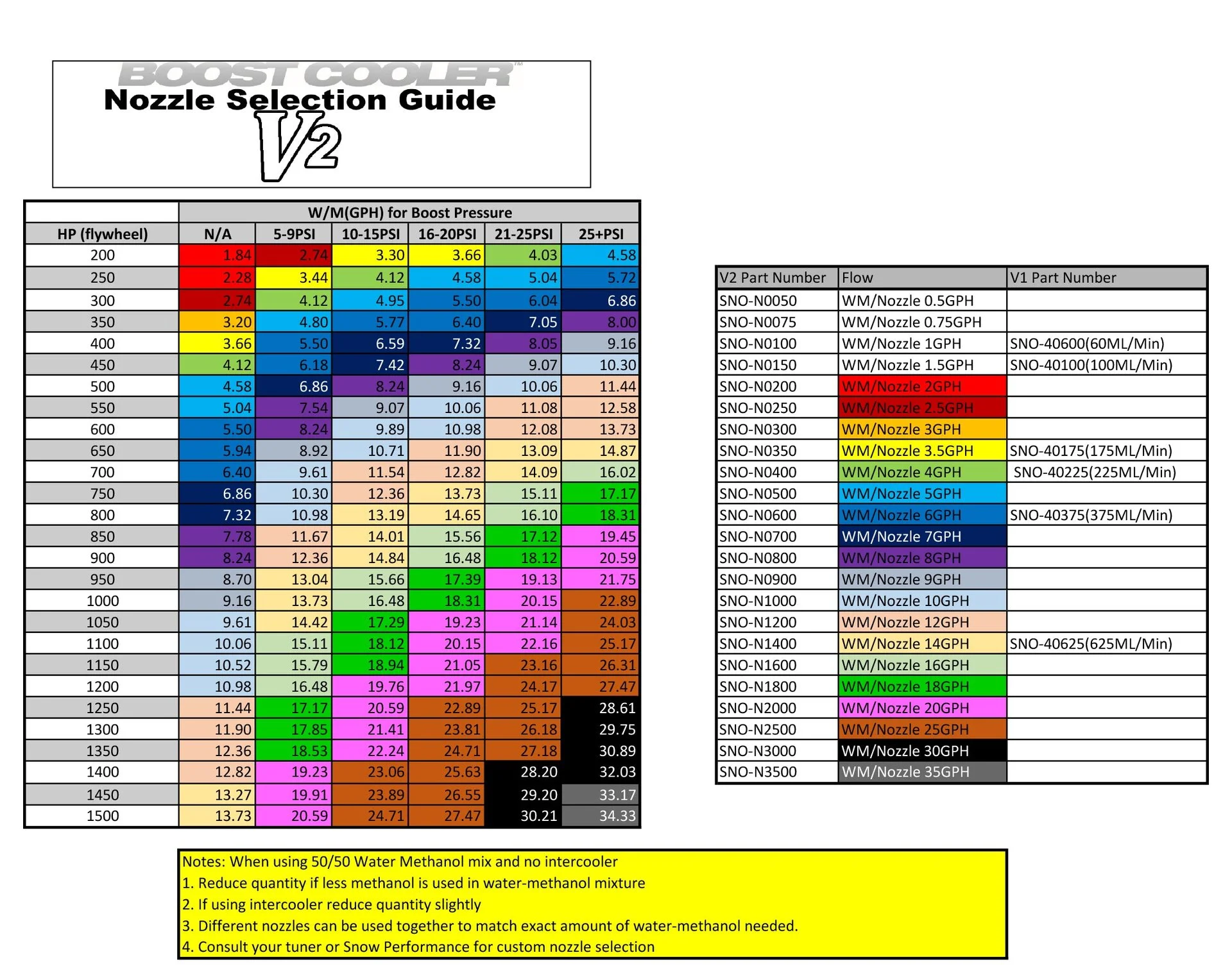

This little vague chart from snow performance only goes to 200hp crank numbers… :D
So by extrapolating these numbers (that’s a big word) at 150hp crank which seems pretty easily attainable on a fresh engine, upgraded turbo and up to 20psi boost looks like I would be in the orange to dark red numbers which is around 2.5 -3 gph (gallon per hour) assuming a 50/50 meth mix. Size down if less than that. So 2-2.5gph would seem to be fine.
This chart is based on 100psi from the pump. More on this later…anything less than 100psi apparently doesn’t work as well, doesn’t mist well, yadda yadda yadda

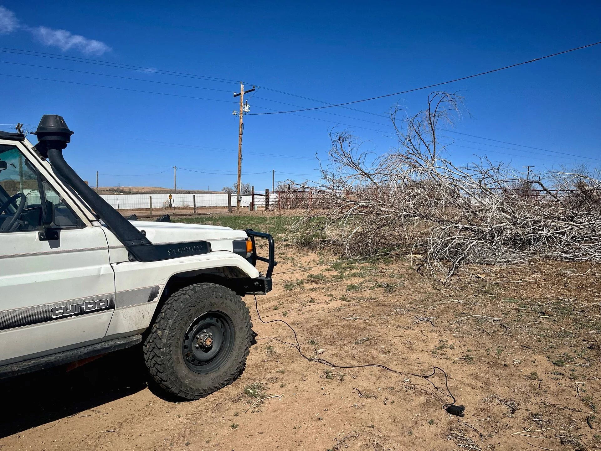

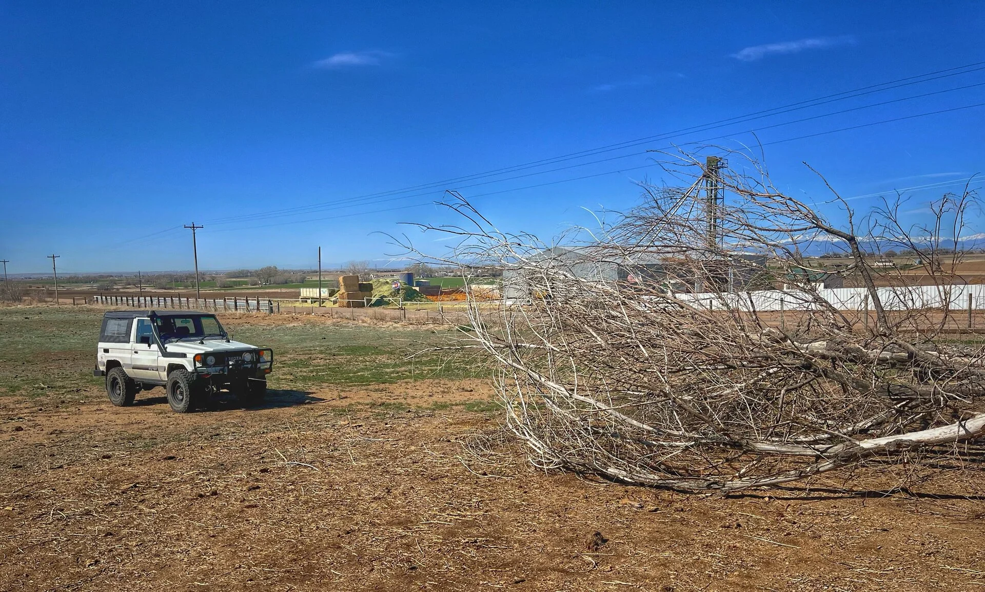

Big old dead tree blew over and took down some pasture fence on Friday. Time to get the chainsaw and cruiser out.
BJ74, 8274 to the rescue. Winch works fantastic.
My daughter then put the cruiser/winch to good use while we were working on another vehicle.
