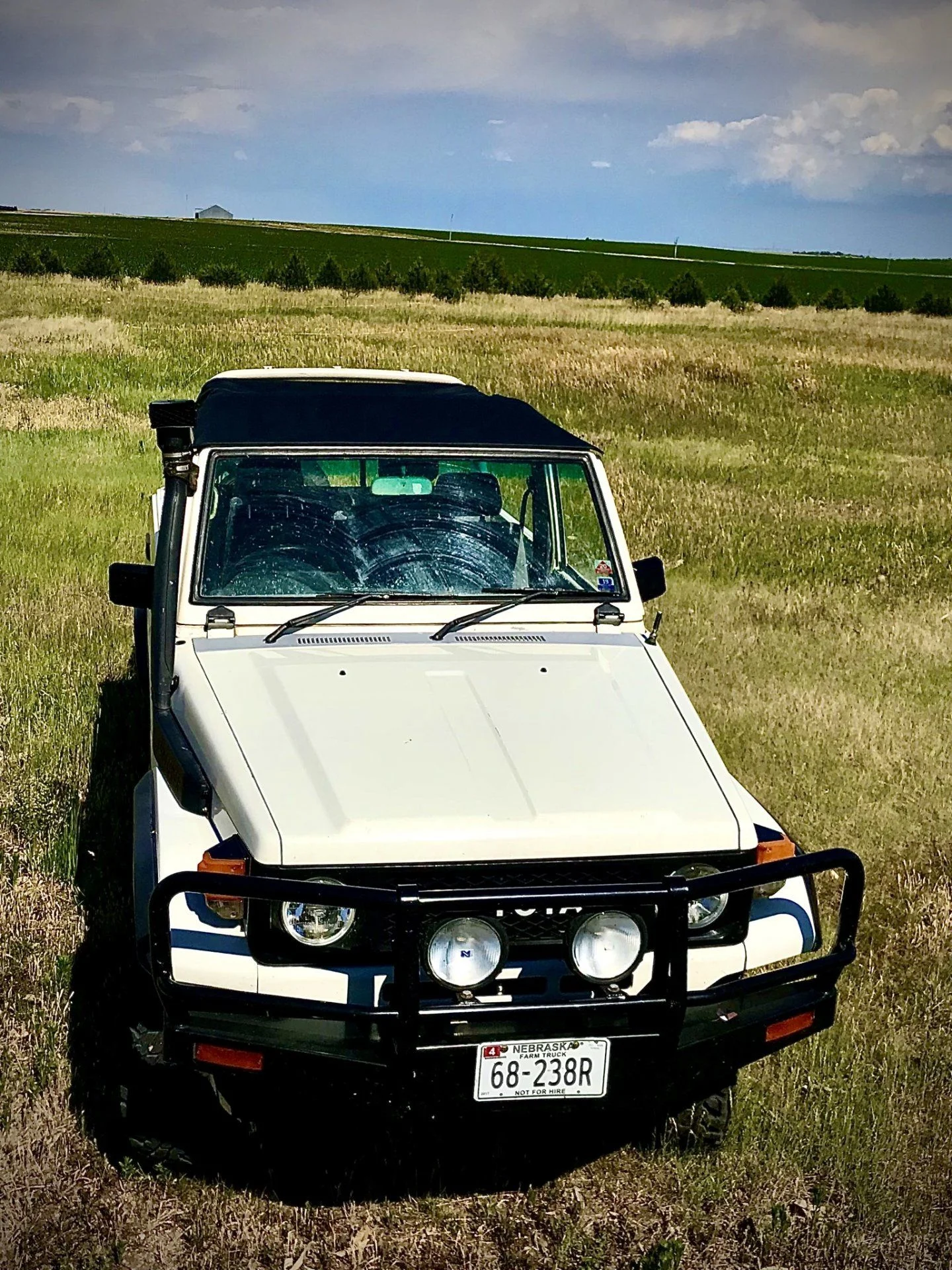

It was time. Not near as much rain this year yet so I decided to pull the top again.
Going to order a bikini/bimini top today to help keep some of the heat/sun out.
I used a top for a 1987-1995 Jeep Wrangler. Reason $83 shipped for everything. If it doesn’t work, I’m not out much.
I used the smittybilt extended top and CJ/YJ header bar.
Top
Smittybilt Extended Top For 92-95 Jeep Wrangler YJ
Header bar/windshield channel
Smittybilt 90101 Windshield Channel for 76-95 CJ-7, CJ-8 Scrambler & Wrangler YJ
. I grabbed some screws for the top as well.
So I have an FRP fiberglass windshield, so no worries about rust. The Jeep windshields are completely flat and the 70 series slightly curved. I put a few relief cuts and bent it slightly back to better match the windshield curve. One I slipped on the saw and took a bigger chunk.
On the back there is already a threaded hole to attach the back straps. On the Jeep you just hook this under a ledge.
Velcro straps go around the bars from windshield to main roll hoop.
Same Velcro and pull strap on the back oem rollbar.
Nice! That's a good idea. I will likely copy you on the top if I ever get my truck on the road.

Yeah, overall it's not a bad fit, but it definitely could be better. About 5~6" longer would cover the rear bar nicely. However since mine is Aussie it has seatbelt LATCH points on the top which might mess up a longer top. THose I think will help in another project I'm working on. The Jeep LJ 2004-2006 would probably be a better fit, but I could never find out how the front attached with the same lip or not. It seemed to be different. Either way it was cheap.

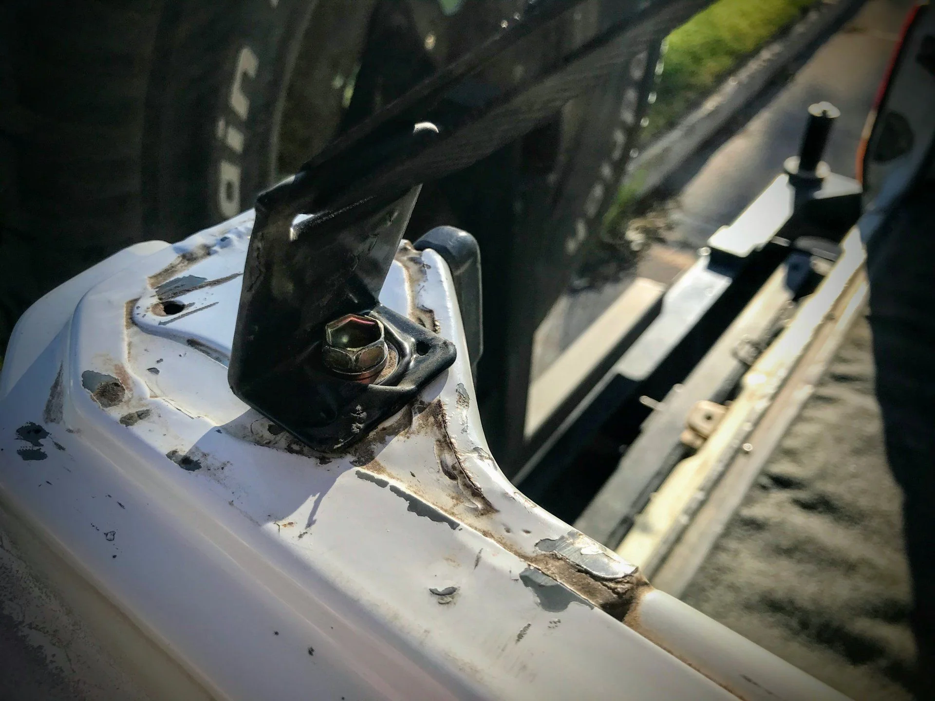

Here is the attachment point on the rear. After the drilling the hole in this bracket, the rubber gets a little loose to tighten down.
Looks like a good top for a middy. I like the velcro on the sides. Did you consider using the captive nuts on top of the windshield?
I think it's a pretty good option. THere are other brands, but this was the one I found that had the straps on the back to cinch it down which seemed like the best way with how the middy tops/roll bars are. They also make just "mesh" style that shade but no waterproof that would probably work as well if you just wanted shade. I hear people use these under softtops or bikini tops as well.
Which captive nuts? I have a fiberglass windshield frame and didnt see any captive nuts.
Sorry - I did read you had a FRP windshield frame. Likely does not have the captive nuts. My mistake.
