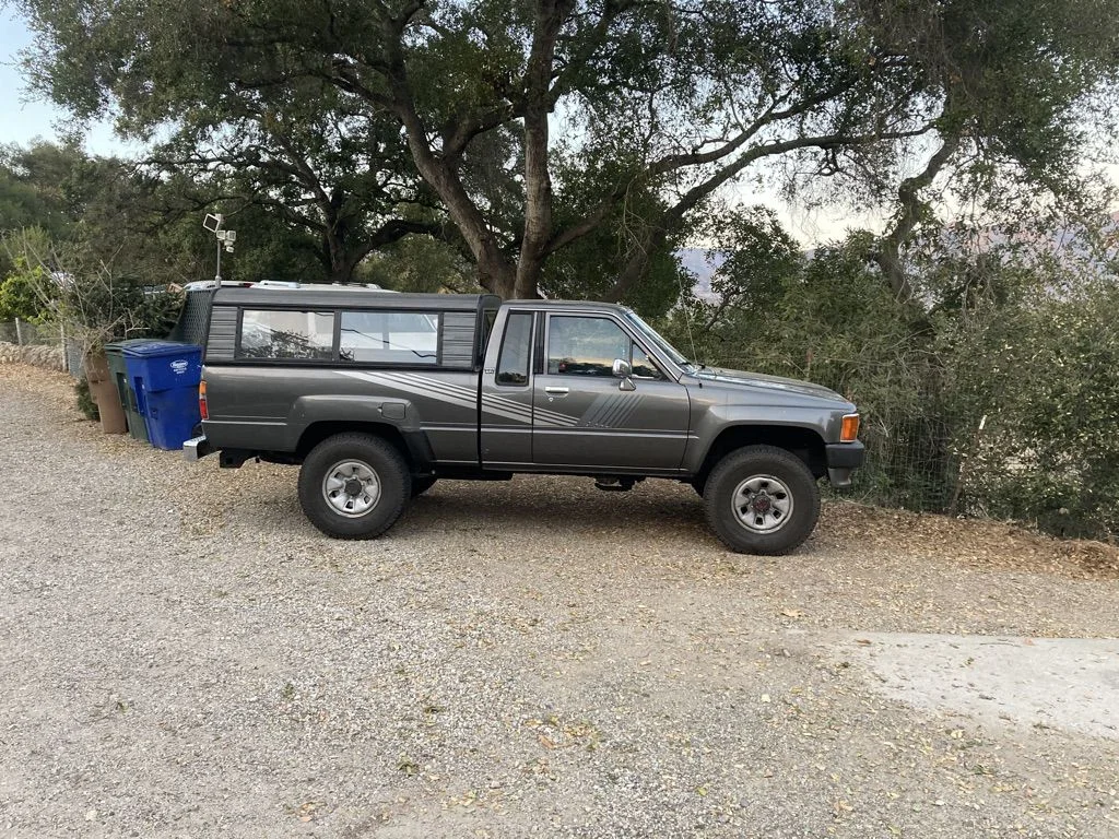

I have been slowly working on the 87 pickup, really didn't need much. For smaller trips and the daily driving, I would rather drive the 87 around than my F250.
I stripped the interior and sound deadened the whole truck.
I added a modern radio and put speakers in the door. I outsourced that work. I hate electrical. It's one of the few things i will not try and tackle myself.

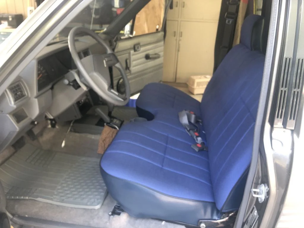

Then I installed a thicker felt liner and carpet. I traded my bench for a reupholstered one. This has caused a problem. I didn't realize the 2wd drive and 4wd bench seats were different. This one is a 2wd seat the seating position is extremely low. I am now on the hunt for a 4wd drive bench.

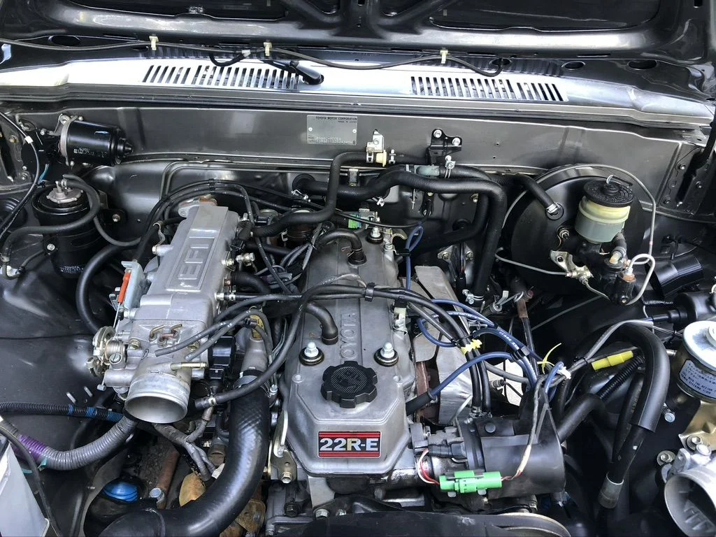

Then the truck started running really rough, so I started to get into the engine. I redid the spark plugs, vacuum lines, a few other items, while I was in there.
We are all good once again.

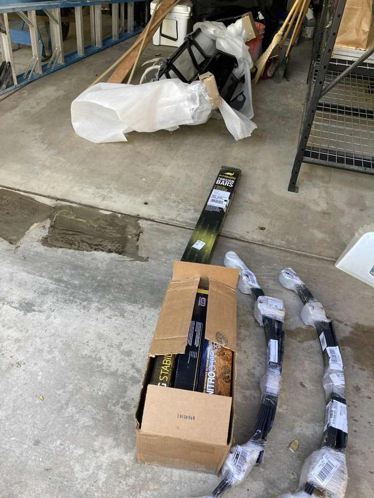

I am ordering a full OME suspension kit, Bumper and winch.
I am thinking the 31" tires will still look ok with the lift.
I am considering going to 4.88 gears.
My truck has 4.30 gears. I think with the added weight the 4.88 will help.
Also, I received my metal guides from LC Engineering, I will put those in sometime in the next few months.

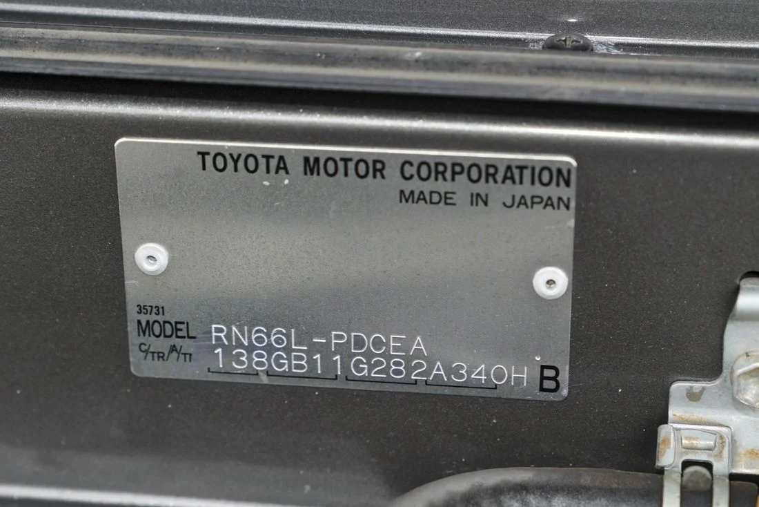

The truck did not come with the 31" I added them, I looked up my Gear Code and it is G282 which If I decoded it right is 8" diff with 4.30 . I could be wrong though
