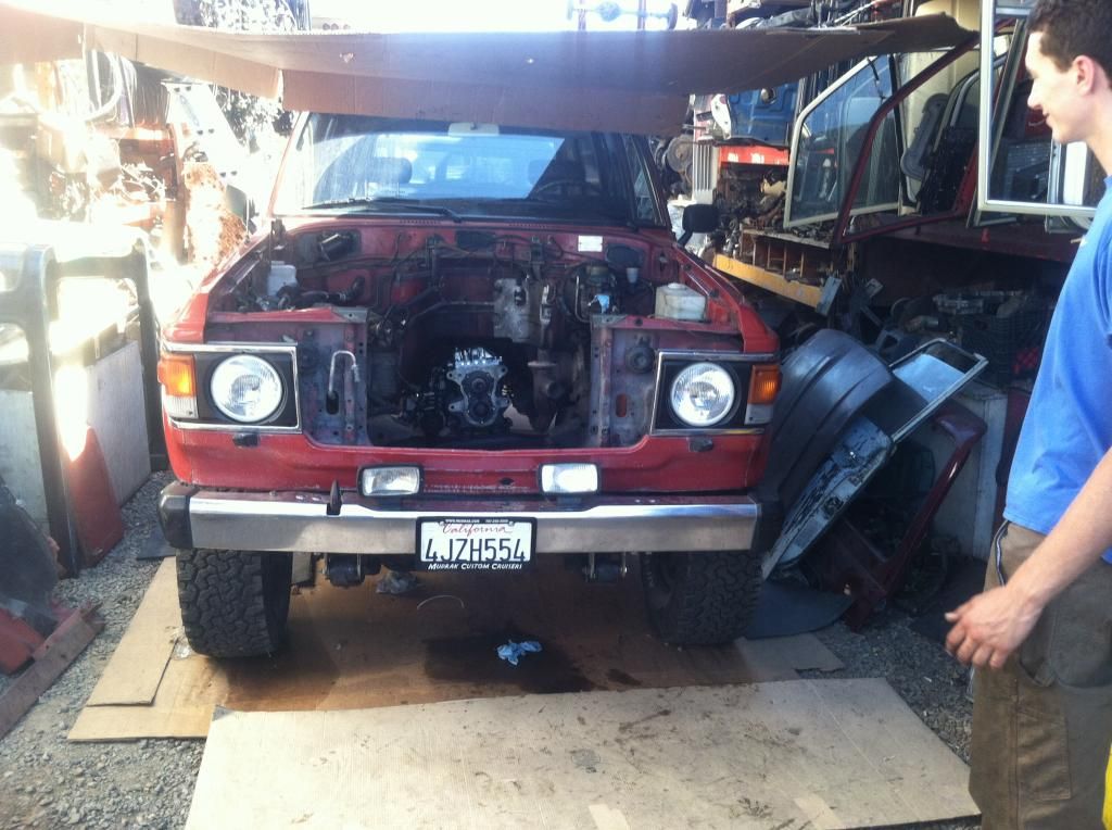

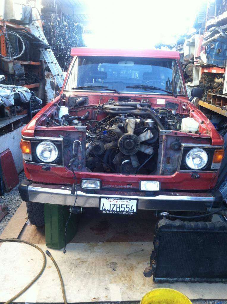

Well. Theres no going back now. Got started pulling the 2F.
By the end of the day the
-Alternator was out
-Fluids drained
-Radiator and AC out
-Battery out
-Hood off
-Bellhousing disconnected from transmission
-Engine unbolted from motor mounts (its just resting there now)
-Carb fan is out
-fuel lines removed and drained
-Started pulling apart the dash
More to come in the next week!

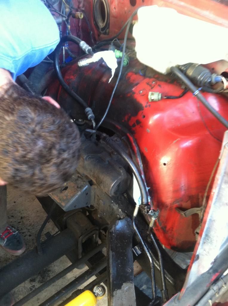

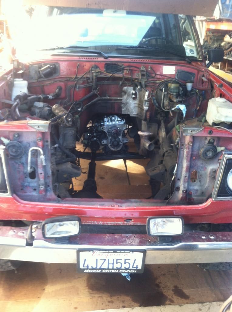

Day 2!!!
- Engine is OUT!
- All lines and pipes are sealed with silicon
- Power steering drained
- Engine sitting on blocks in storage
- Engine bay de-greased and prepped
- Front chassis and engine bay STEAM CLEANED

Regardless, Im getting so stoked for this diesel! Engine delivery date was pushed back AGAIN.... so as of now Ill be doing the swap in 4 days... TIME CRUNCH
The engine bay and chassis had paint missing, and spots of rust. I might run to the paint shop next door and get a color matched rattle can to do some touch ups here and there. The steam cleaner was AMAZING. It got everything so unbelievably clean.

This last picture gives a great contrast to BEFORE and AFTER with the steam cleaner. We just hit that one spot of lower fender to show how well it works
