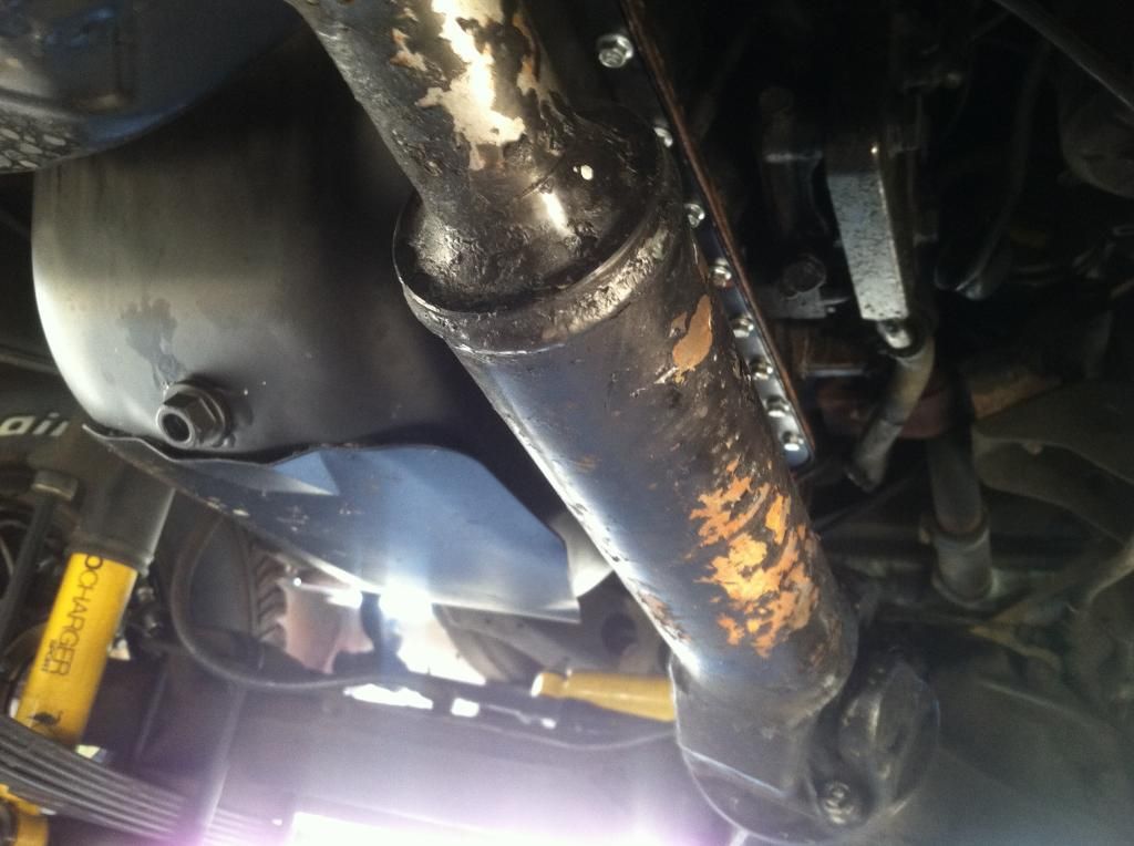

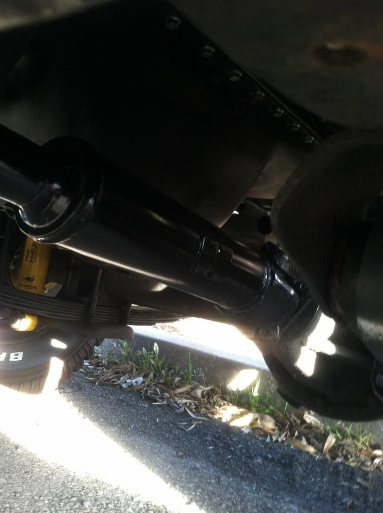

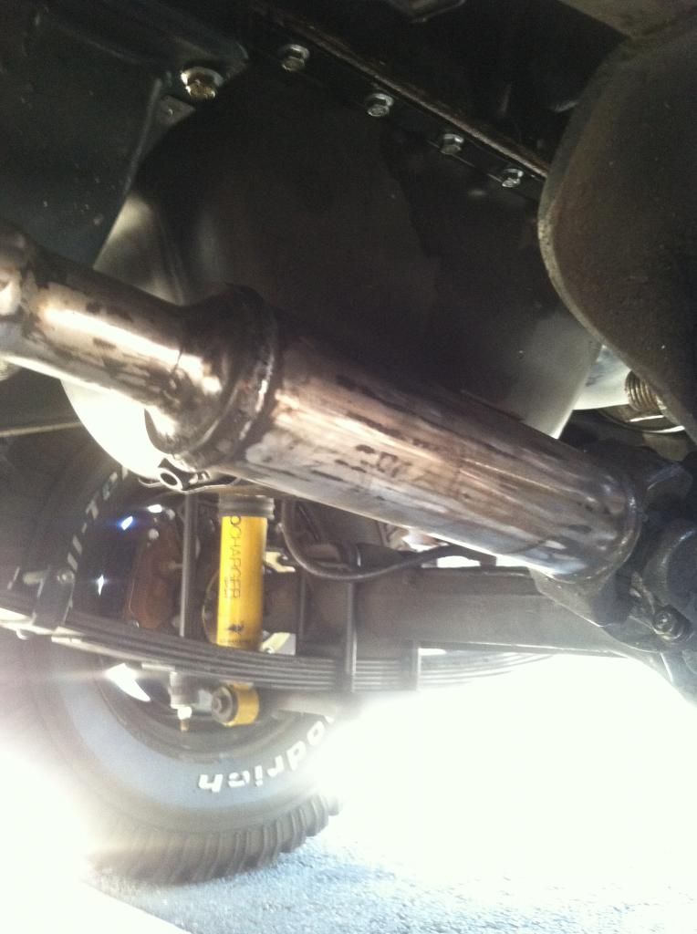

Ok guys, so I crawled under the cruiser to see how things were doing, and didnt like what I saw. My front driveshaft was looking like THIS -->
Rusty spots, and lots of flaking paint. I think it got repainted incorrectly when the 5 speed went in. By best guess is that the paint wasnt heat resistant enough, and it bubbled and flaked after being so close to the hot engine. Regardless, it needed to be fixed.

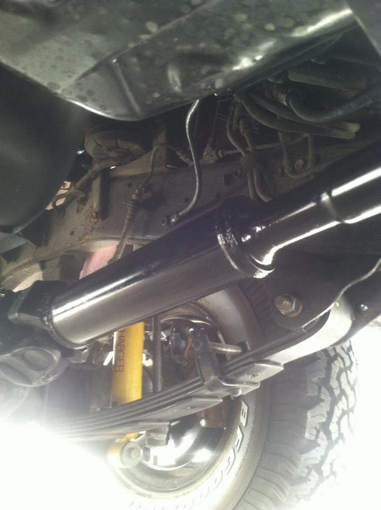

I used a pneumatic buffer and quickly took almost all the old paint off
Then I masked off the suspension and oil pan, and hit the drive shaft with some industrial, semi-gloss heat resistant paint.
I think it turned out great and the shaft looks new!
(sorry in advance for the crappy picture)

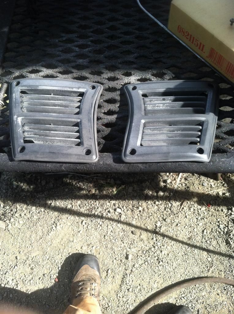

I also got a chance to finally re-paint my flaking rear vents.
Before=
Then I bead blasted them ever so slightly to take the remaining black paint off. Primed them, and painted them.

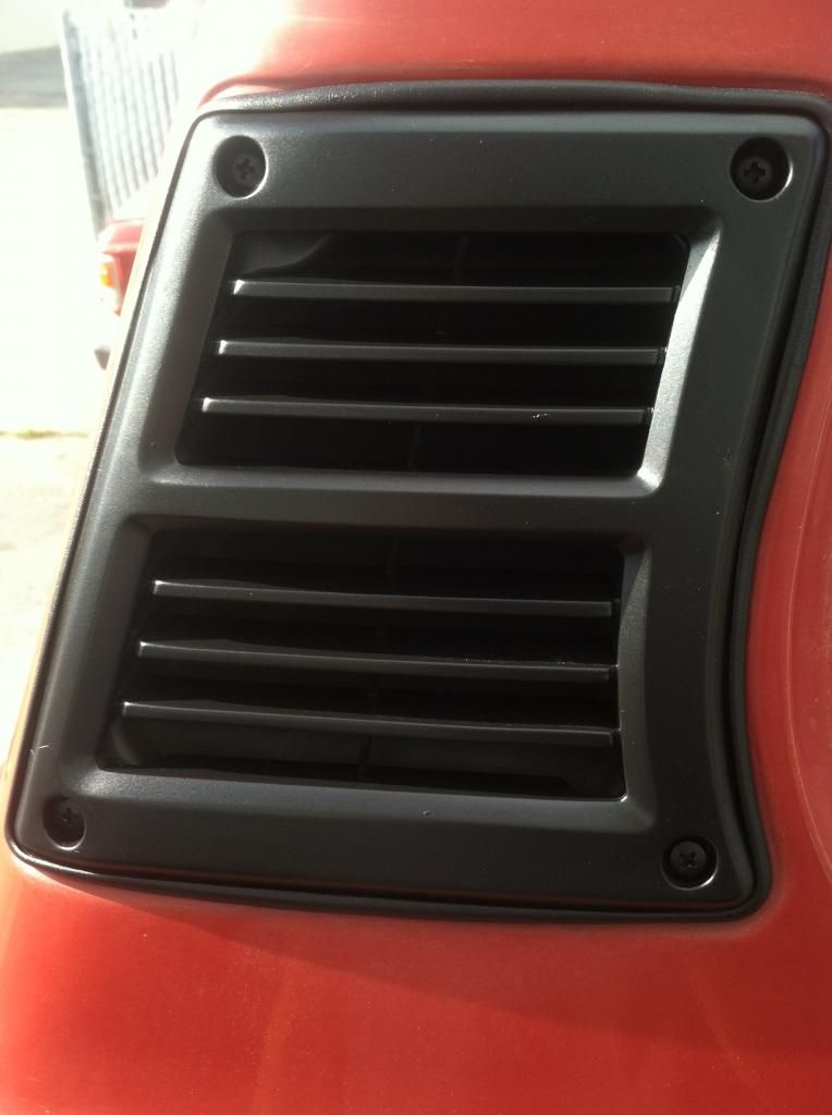

I also painted the screws... all in the little touches
After=

Also wanted to throw in a better picture of the repainted driveshaft

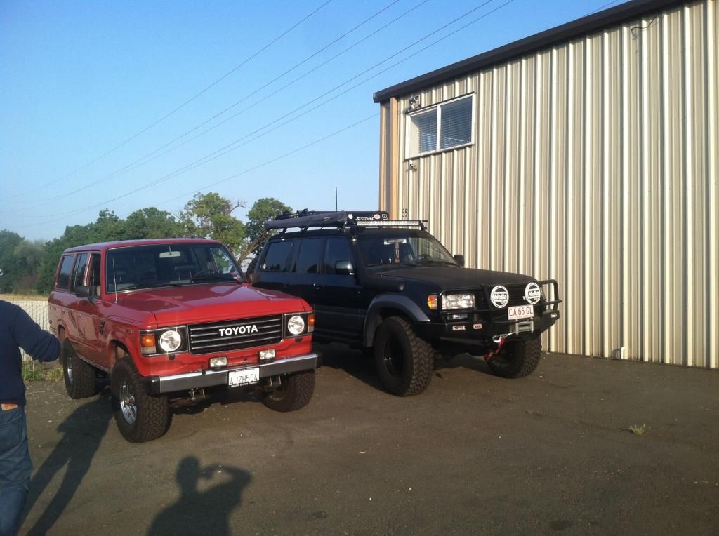

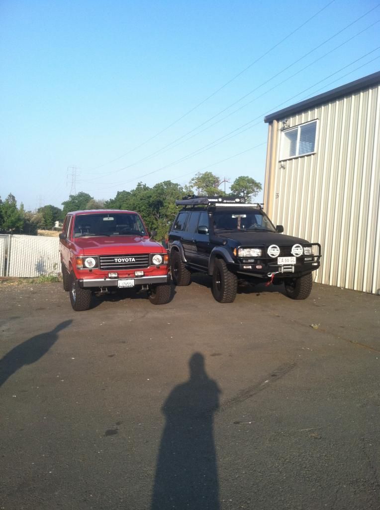

I can safely say these are the two baddest rigs in the lot (in my humble opinion). Shout out to the MUD member that owns this amazing 80 and its trailer! That thing is really awesome. I dont know your name on here.... but with all the Ih8mud stickers all over it.... im sure someone will know whos truck this is.

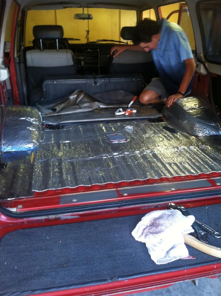

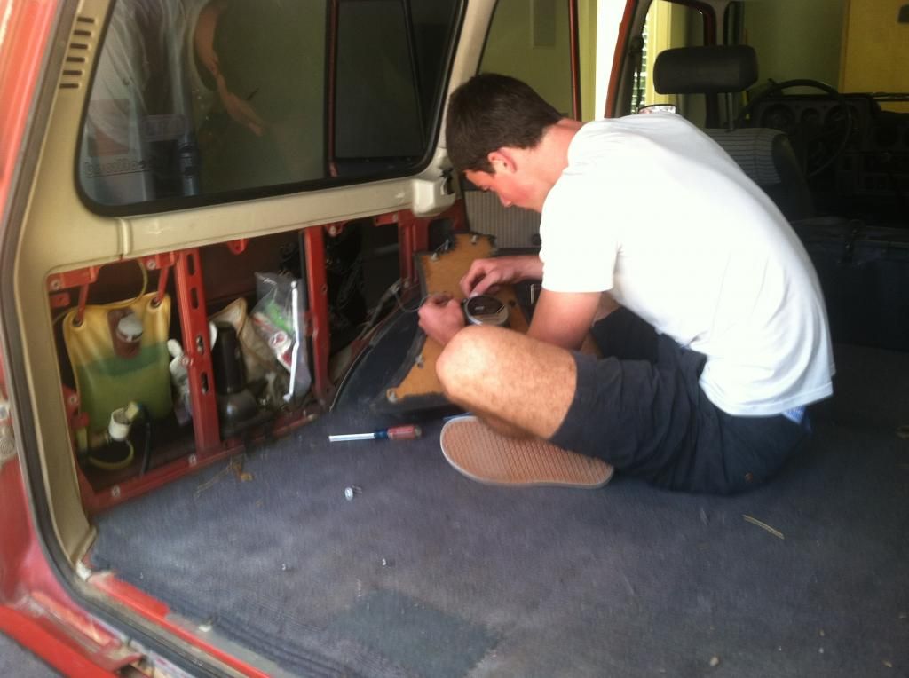

So I started the day with the intention of finally wiring up my front fog lights. I was going to have my friends Chris, Phillip and Eli over to help me with the wiring and cleaning up the rig. Chris stopped by NAPA to pick up a relay and some wiring gear, so phillip and I started cleaning up the cargo area.
Long story short, by the time Chris came over to do the wiring, we had the side panels off, the carpet peeled back, the wire brush out, and had decided to sound deaden the rear!!!
Removing the side panels and speakers:
After peeling back the thick sound mat, we had to cut cut away what was still glued to the metal. Once the chunks were cut off, we wire brushed it all down to the adhesive and painted metal.
What was left after the mat and carpet were removed:
We took the truck down to the 76 station and payed for the vacuum. In five minutes the whole truck was vacuumed out and we headed back to put in the deadener.
Then came the simple green, and denatured alchohol:
After everything was scrubbed down as best we could get it, we started measuring, cutting, and installing the deadener.
I cant remember the name of the product off the top of my head but ill post it bellow tomorrow.
Installing the deadener:
Final Product!!!!!!!
Let me say that your rig is one of the cleanest red 60 i have laid my eyes on,that 80 series next to you is a friend of mine he goes by Haring Bagsik here on mud i think he was there for his light bar install and some other stuff.Yeah that 80 is clean and well cared for he just purchased that trailer recently.
I envy your rig for getting all this nice upgrade man,i have a ton of stuff in the garage waiting to be installed by i always end up working on other people's rig before mine.:(
Love them pictures!!! That was when I got the 80 re-geared to 4:88's, installed the sliders, awning, skid plate....etc....etc....Love that 60 of yours!
