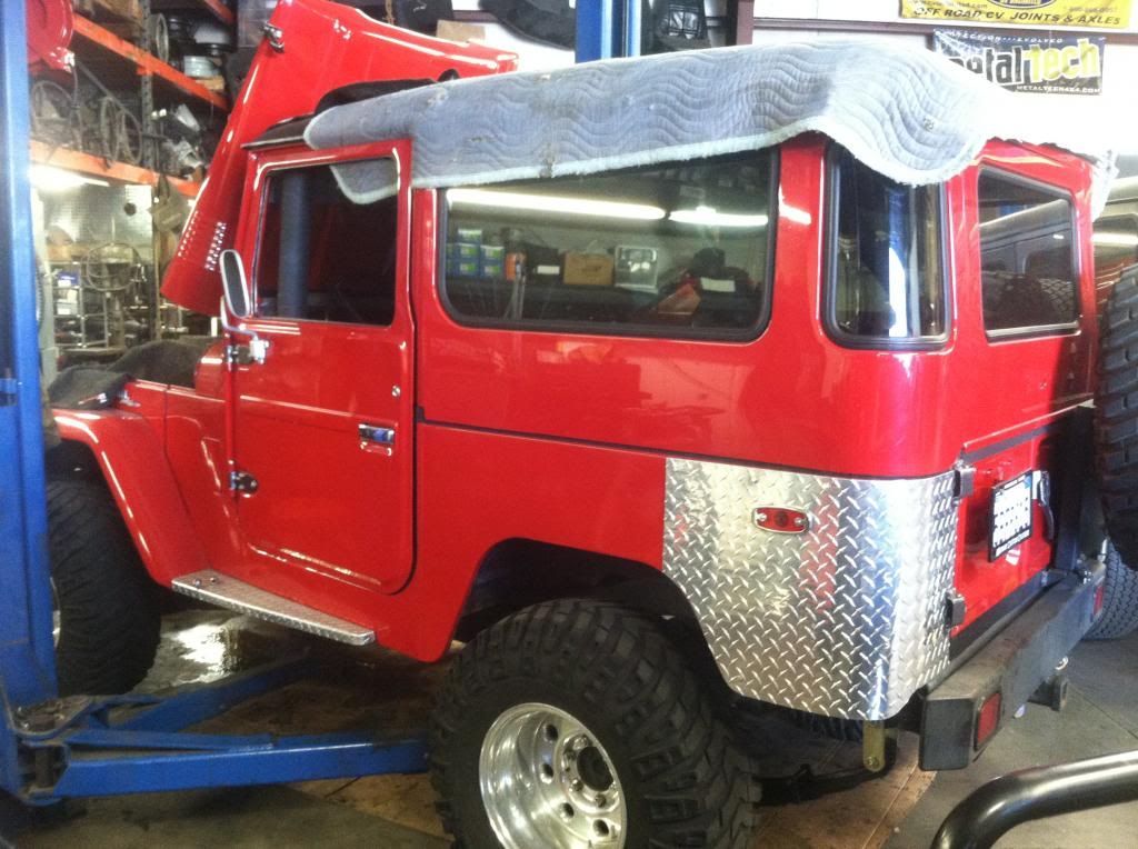

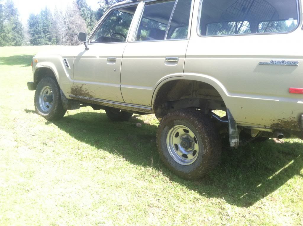

We lifted my dads work truck with new 4 inch OME springs and shocks. We flushed the radiator and added a new exhaust as well (it sounds sooooo good now. Kinda like a boat)
Heres some pictures I snapped when I took it out to test the new suspension.

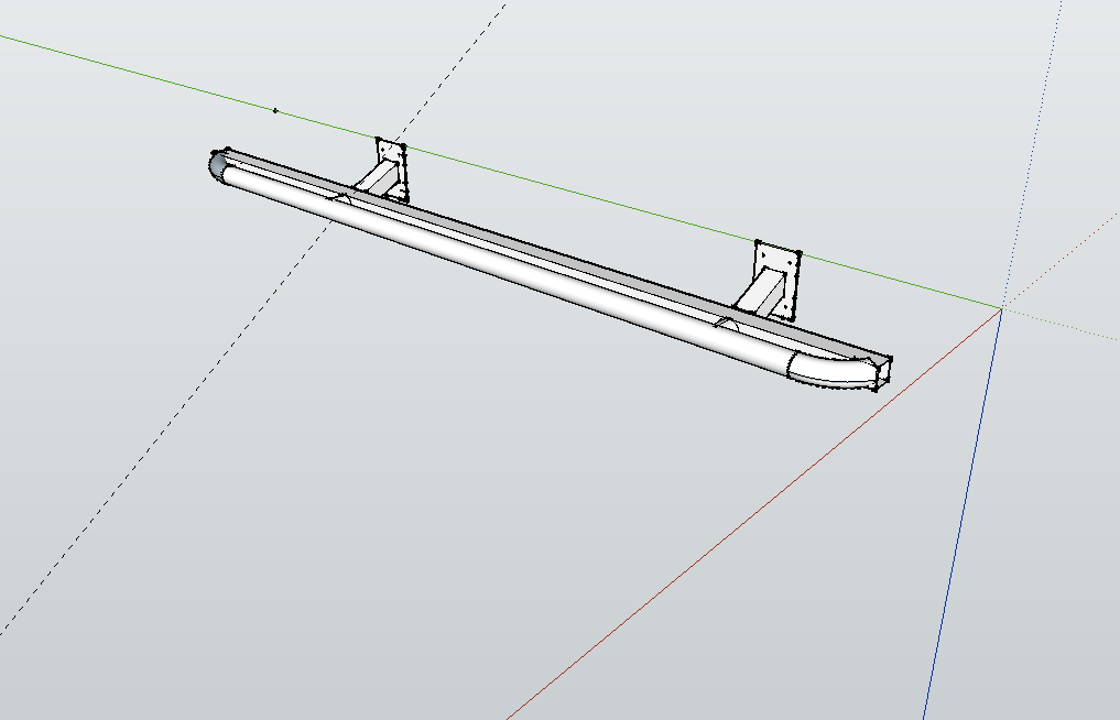

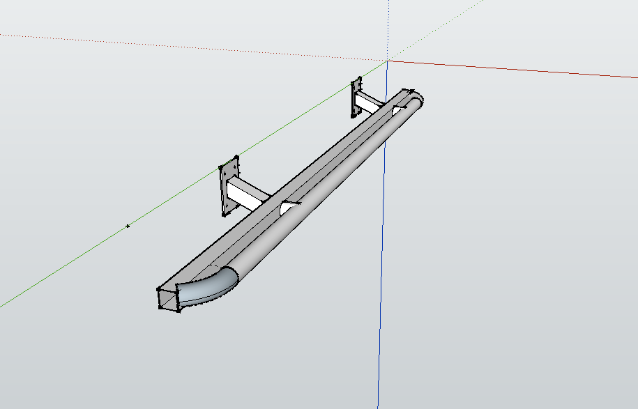

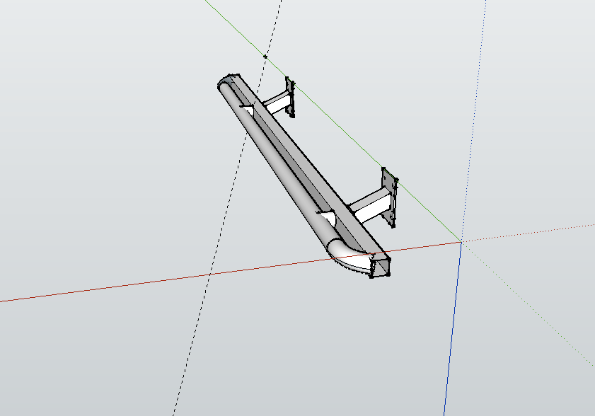

Continuing the roll, I got started on fabing my slider base mounts. My design is super basic, and the plans bellow are really just rough outlines so I dont miss anything.

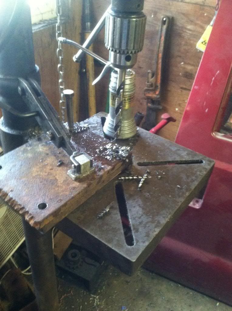

The bases are made of 1/4inch steel plate that I cut from a long strip. One plate will be welded to the inner side of the chassis, and the opposite plate (pictured in plans above) will bolt over and under the chassis to secure the slider in place. This will allow the sliders to be easily removable, yet very sturdy and secure. I dont plan on rock crawling in this rig, but Id love to have a step and some simple body protection, even if all it does is keep away dents from doors in the parking lot.
Heres a couple pictures of the bases cut and drilled.
^The top plate is just a template for the bolt holes. The cut on the end was done with a torch, the rest were cut with a cut-off saw.

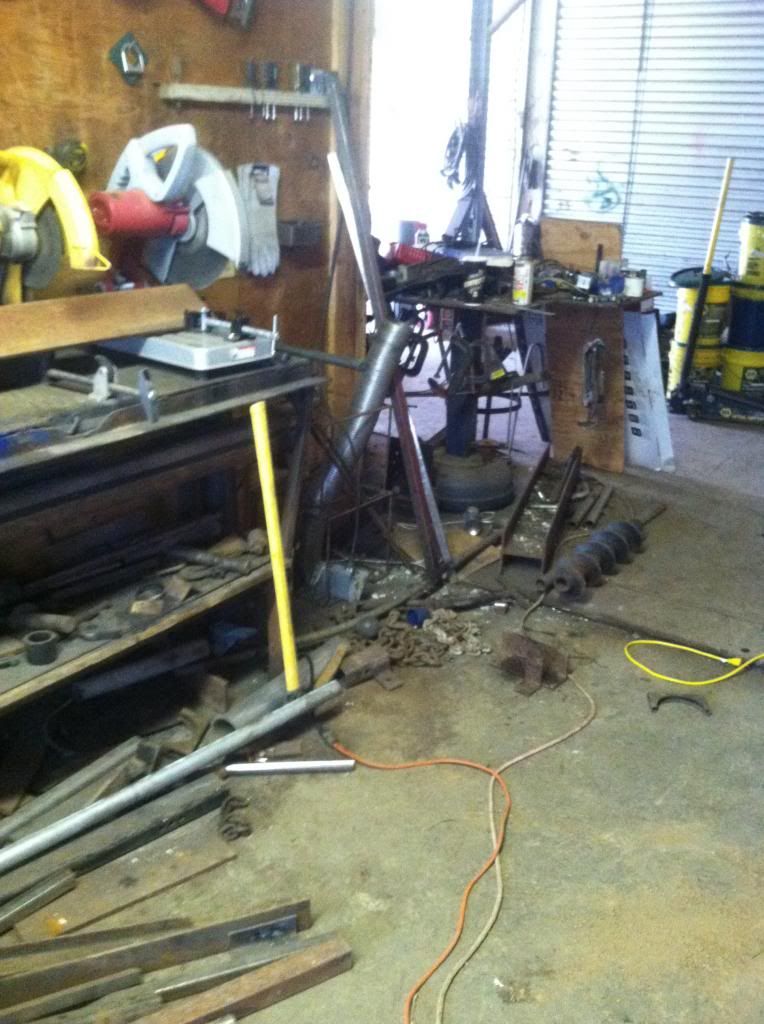

Our shop is a complete mess after a fire destroyed almost all of the roof a month or so ago.

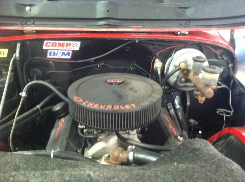

As a last thing. Heres a FJ40 that I was working on at work.
I put in a new OME lift and shocks while Chris and Chemma worked on the engine. It has a chevy 350 under the hood and can literally do a burnout in 3 out of the 4 gears. I wish Id got some pictures of the interior because it was pristine.
Too bad the thing runs like s*** ever since they put in the chevy engine :bang:
