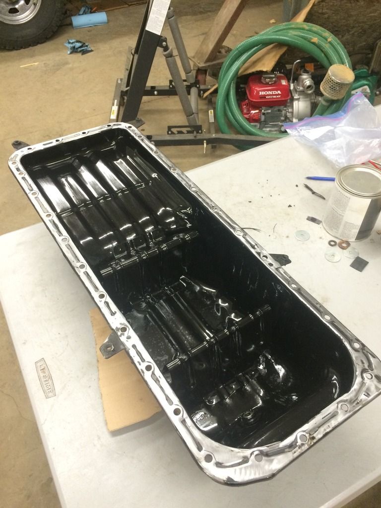

Did an oil change.
Took the chance to drop the pan, check it for holes, and put in a new gasket. I just used Dirko as the gasket. So far so good.
Also changed to NAPA filters because the toyota ones are tough to get and my order didnt come in time.
All was well inside the engine as far as i could tell. Minimal material and metal shavings in the oil sump.
NAPA filters are good stuff.. never had an issue with them in the years I have had BeBe. Dropping the oilpan on her is on the agenda for next year when I don't mind having her down for more than a day (as the 2F pan is usually concreted on there).

Did you bother to check your main bearings while you had the pan out? Just curious, I need to reseal my pan too.

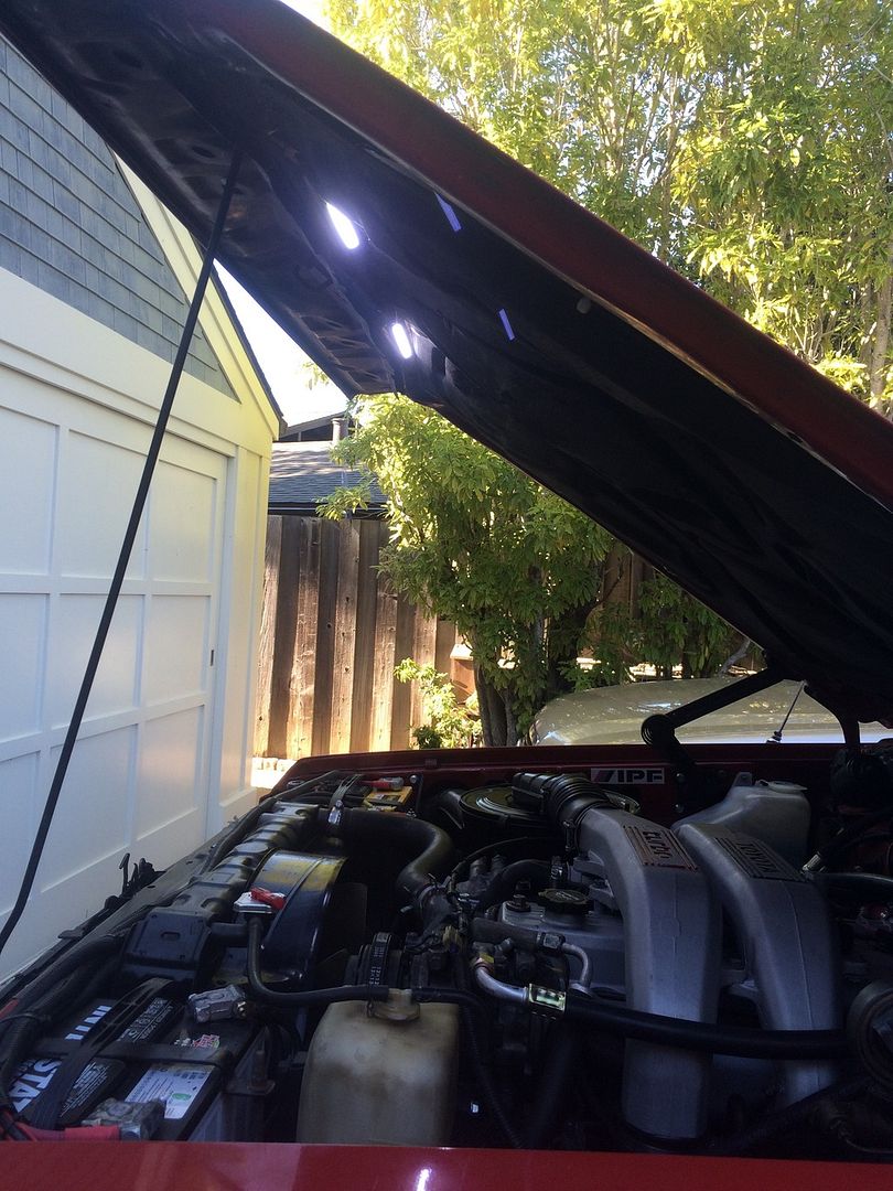

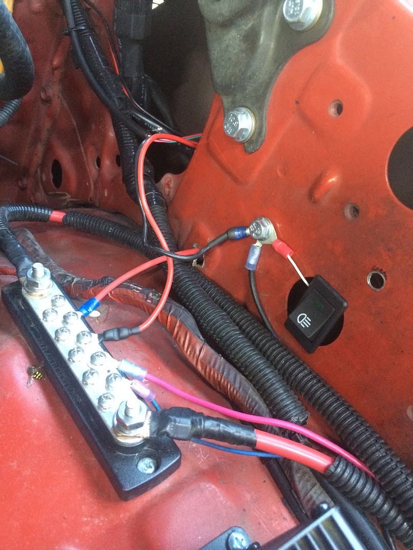

Did another wiring/lighting project today.

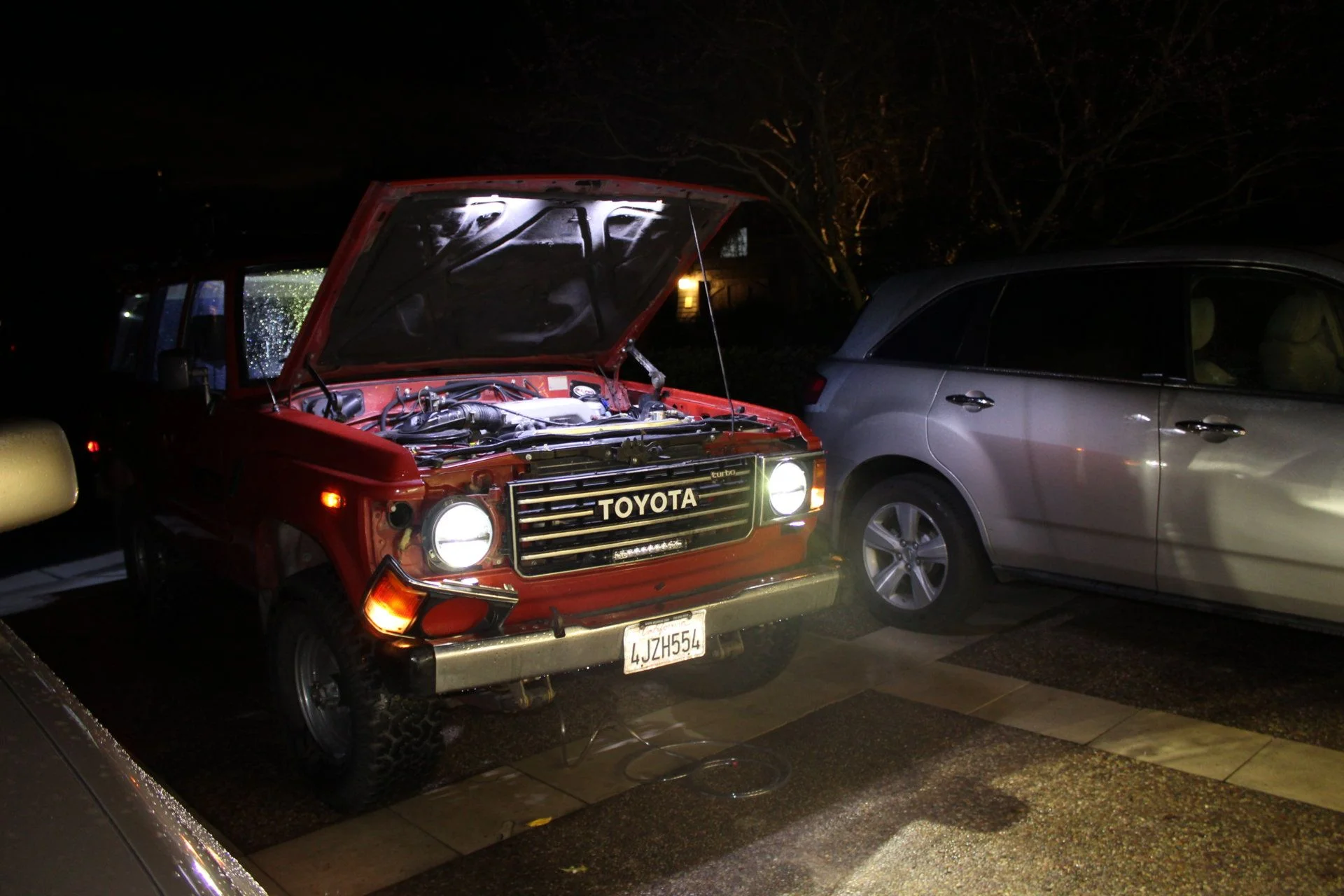

I put two 6 inch led strips under the hood with a switch in the engine bay so I can see what Im doing when I tinker in the evenings or when I have a problem at night.
Its a pretty straightforward setup, but gosh is it a great mod for 15$.

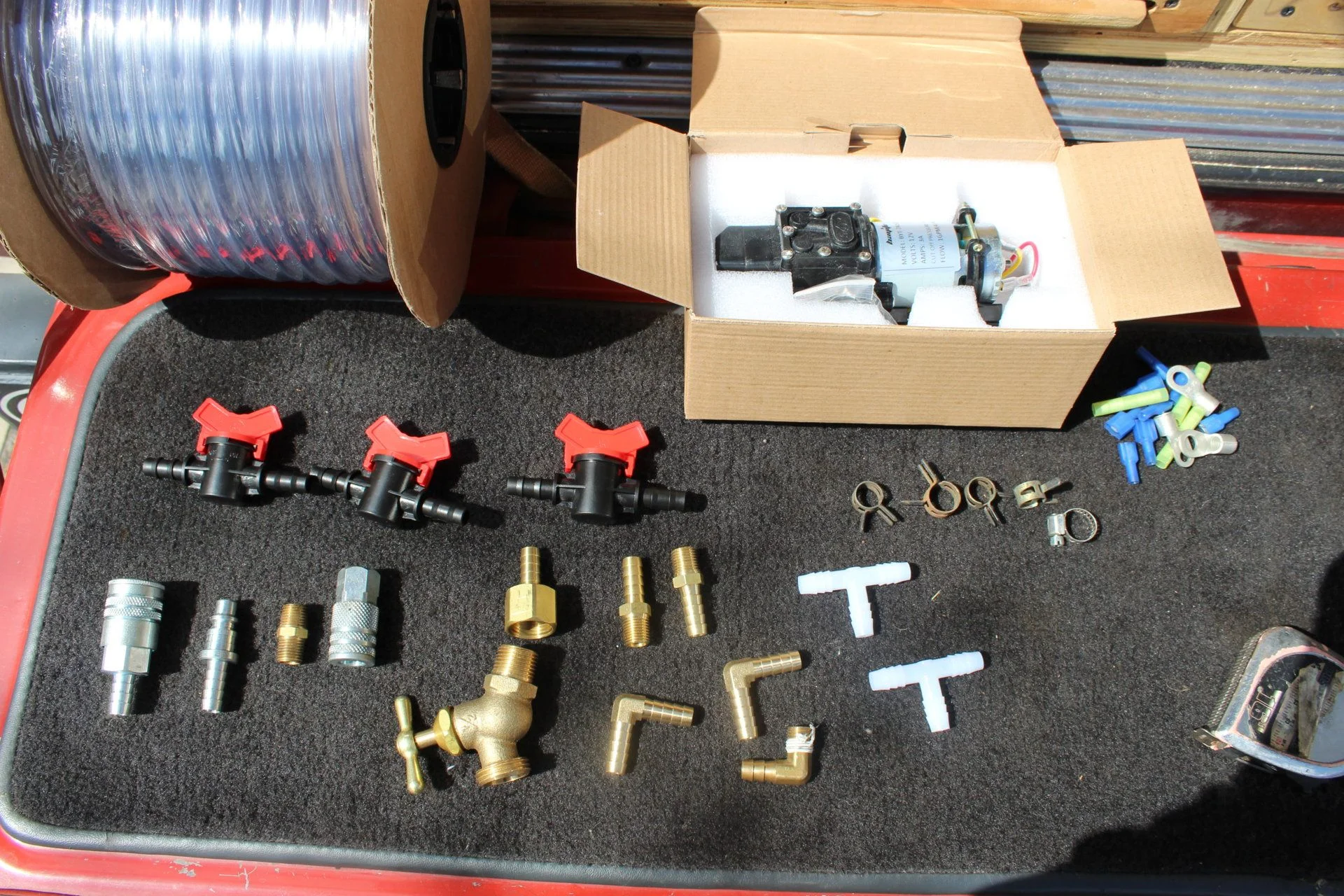

Ok so we got a lot done today. I figured out how I want to run the hot water system, and started installing fittings and lines and drilled a LOT of holes in my bumper. Basically the system has two settings: Re-circulate, and Dump. Just two ball valves control it all, and I should be able to get the water as hot as I want it depending on how long I let the tank circulate.
No real photographic progress yet, more setup and parts acquisition today.
Basically there is going to be two valves on the bumper, then a simple "garden hose" type spigot, and then a Quick-Disconnect fitting for a shower head or hose for kitchen use etc.

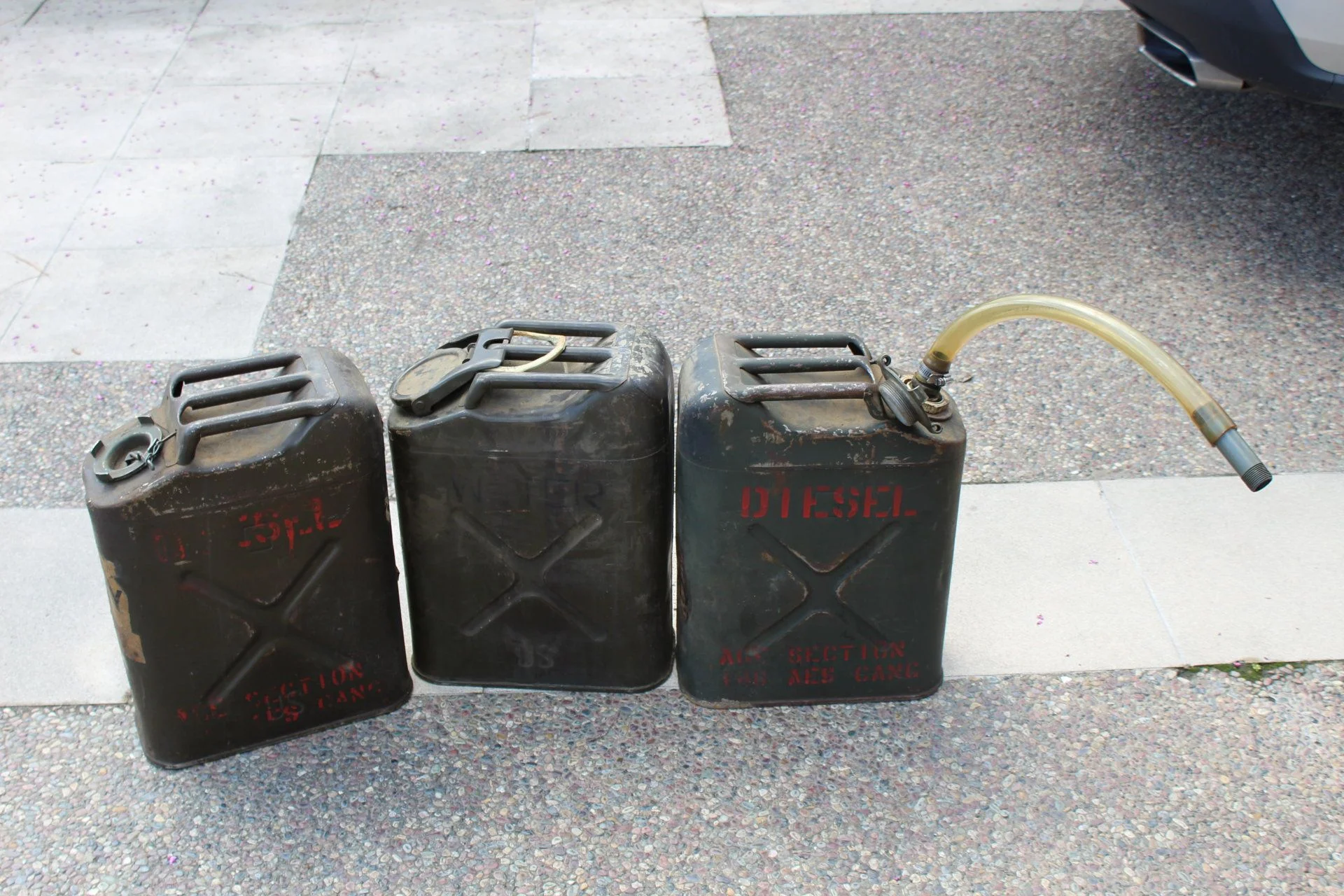

Got my hands on some FREE old US Army fuel cans. One of them came with a pretty sweet filler hose made out of PVC. All the cans are in great shape and should come in handy on my trip up to British Columbia this summer.

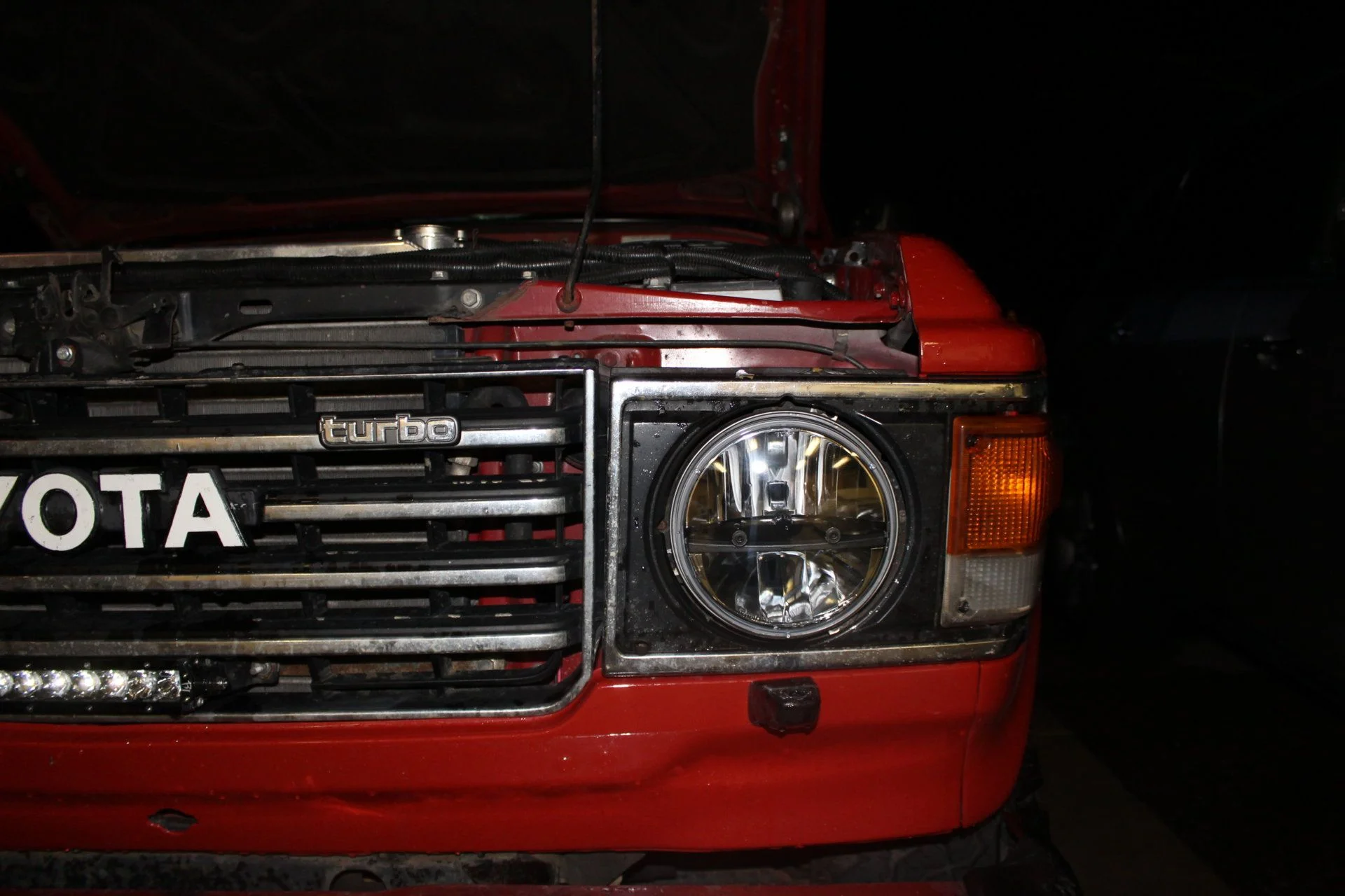

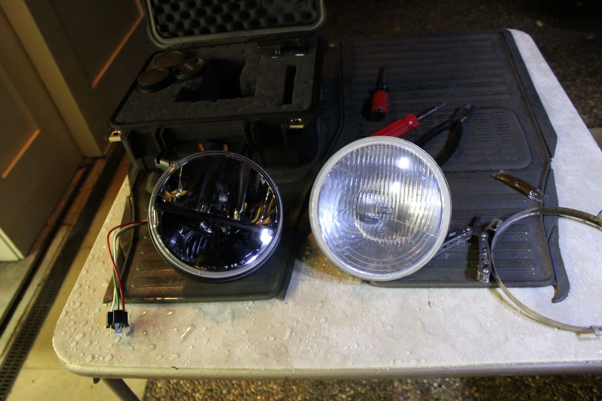

BOOM. LED headlights are IN! Got the trucklight 7" replacement headlights. Definately a more expensive option but Im excited to see how they turn out. So far they seem pretty bright but They have some kinda strange patterns in the beams. Its almost like there is a flat plane and a nice spread of light, then a star shape in the center. The effect isnt noticeable on the open road, but if you point them at a wall or trees or something its pretty pronounced.
They bolted up SO easily. The install was such a breeze I think I did it in 15 minutes. They plug right into the factory harness and the highbeams and lights work with all the factory stuff. 100% plug and play. Pics to follow.
