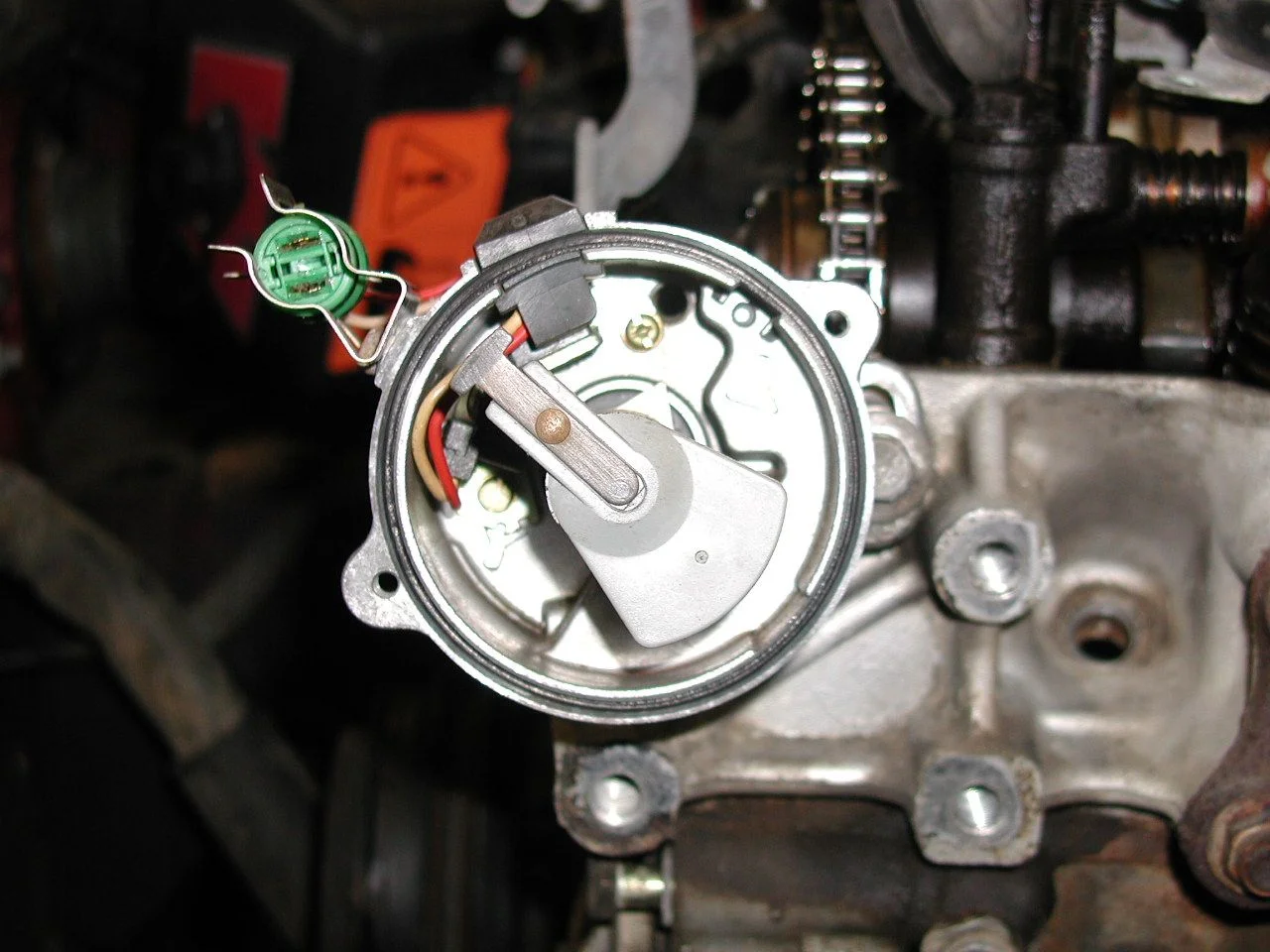

I would start from the beginning. Put your motor at TDC and remove the distributor. When you go to stab it in point the rotor at 12 o'clock and when you put it in you should see it go to 11 o'clock. Adjust from there.
