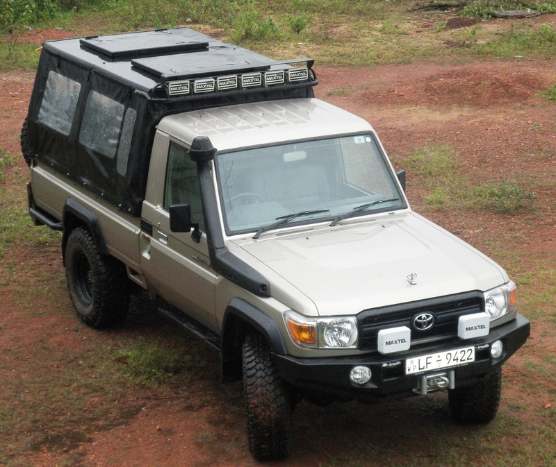

Something like this looks great with a factory tub(or tray)
That design is certainly nicer than what I have in mind and if my truck was my daily driver I would seriously consider it. I have had several vintage Land Rovers with full canvas covers and even with "windows" it can be somewhat of a challenge operating a RHD vehicle in a LHD world. Only time will tell if I have made an error in my judgment.:D
