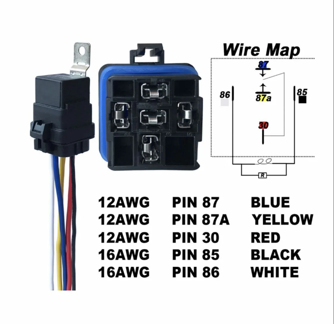

Question on the Relay and Fusible link. How is this connected?
I ran a 30/40 amp relay. 87 ran to sniper, 30 to battery (put fuse close to battery) , 85 grounded to body, 86 to coil for switched 12, capped 87a. Runs great.
