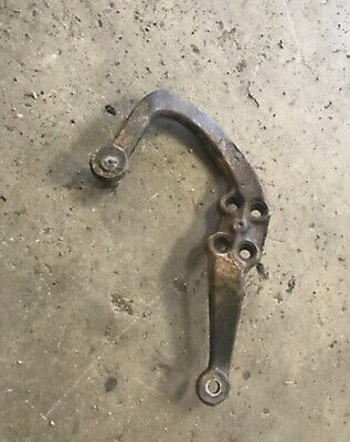

do you have a modded ds steering arm? Just noticed you draglink is technically upside down.
Attaching photos. Does this look stock or modded?
I don't have a baseline, this is the only factory solid front axle Toyota I've owned. A lot has been touched on this truck before I bought it.
Drag link is not stock.
It almost looks like an Ironman adjustable one.
not stock.
example of stock.
