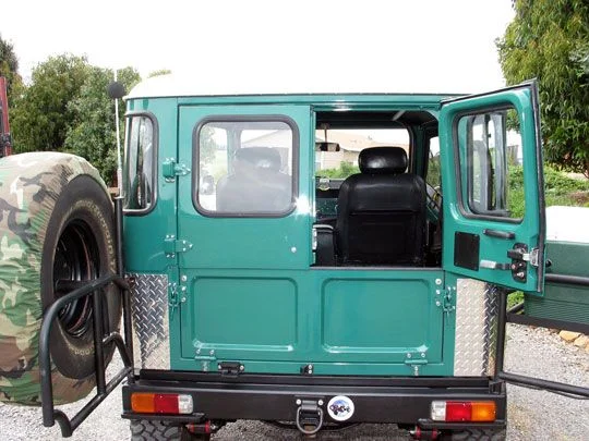

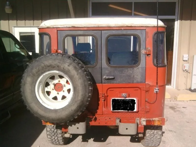

your body shop doesnt want to do it.... its done like this .... IF this is what your looking for
keep your lowers and add the top and doors this way... see link
Half Ambulance Doors
VVV Deckers tub below VVV (the original ambi door modder)

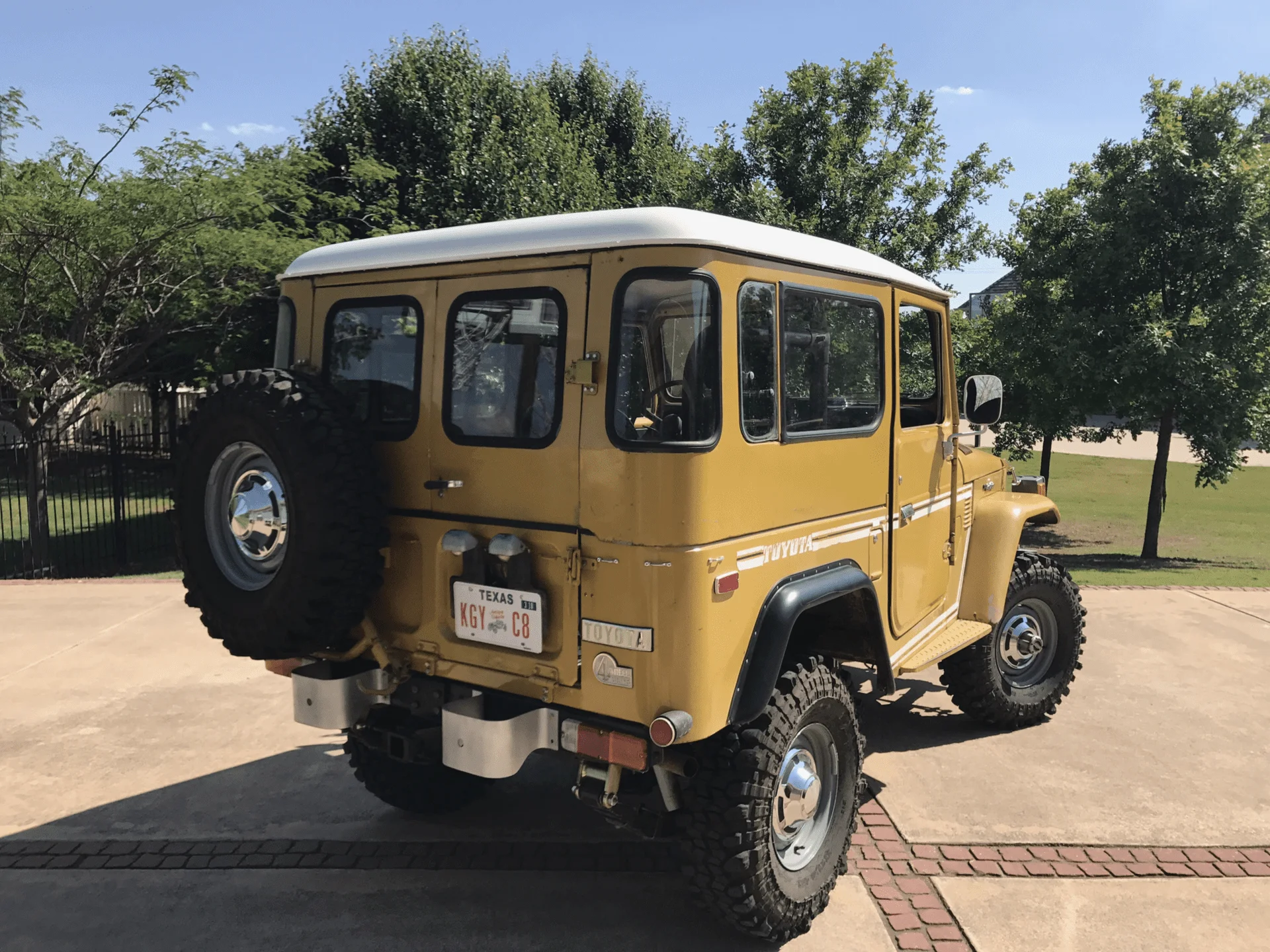

FYI, I’m running an 81 hardtop on my ‘74. I converted it to keep the ‘74 hatch. I can’t see why you couldn’t do the same. Even if the hatch needed to be modified slightly it would be better than messing with your tub.
BTW, the thread linked below has details on hardtops pre/post ‘75.

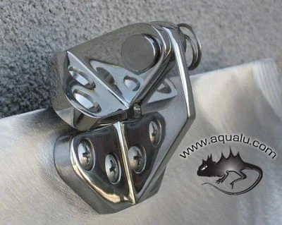

Aqualu Industries makes new hatches... or someone local could fab up one in a few hours.
Land Cruiser #4042 Rear Flip-Up Hatch
I’d suspect it could be fabricated for less than the cost after shipping. Price has sure gone up in the last 27 years :eek:

Would this conversion then include relocating the spare tyre carrier and a new bumper?
If you click on the link... you’ll see @fjgoober cruiser with stock tire carrier and bumperettes
There is also a few pics of @woytovich cruiser as well
Would like to see updated pics of their trucks however :)
Hint hint @fjgoober and @woytovich :)

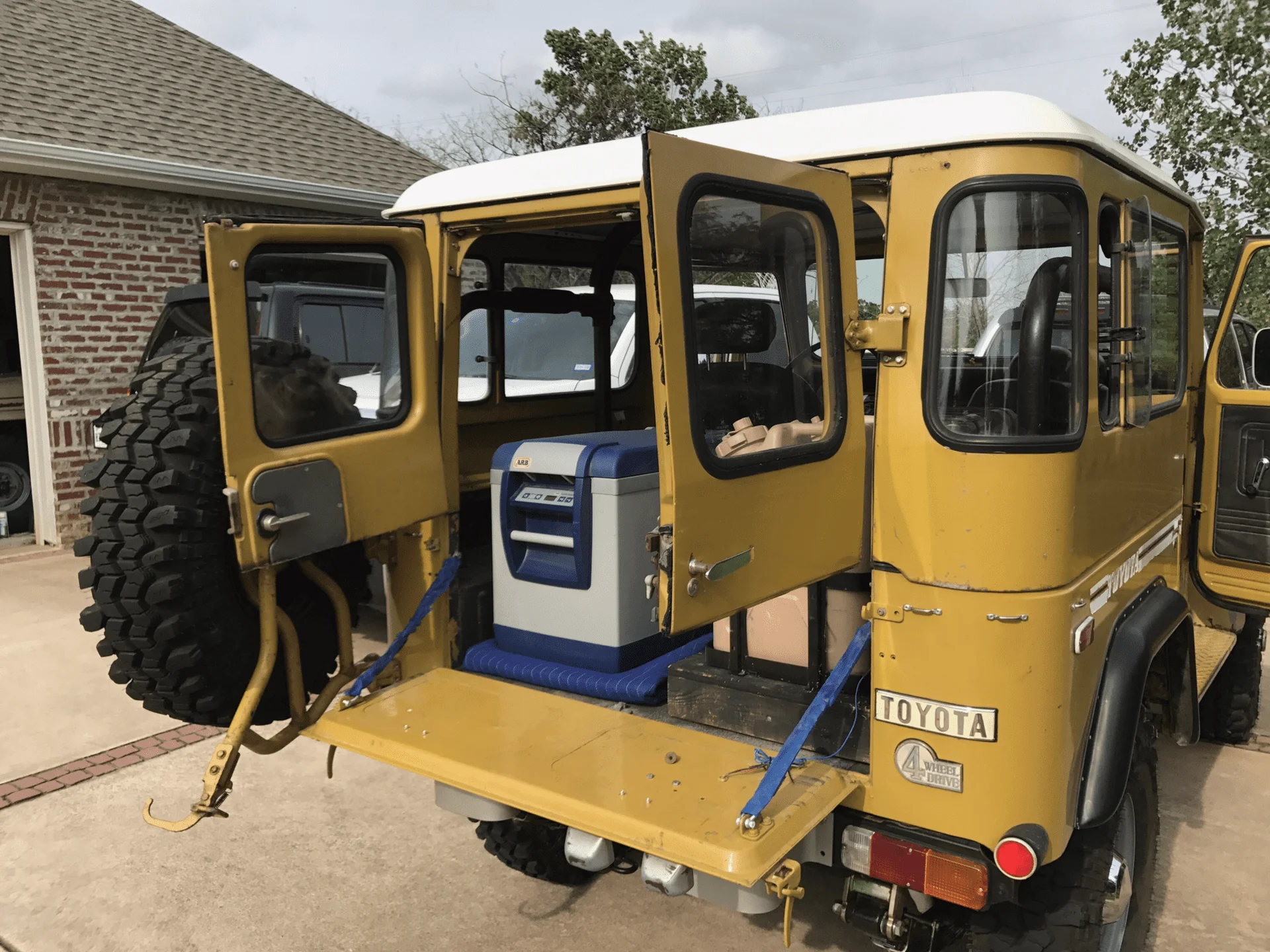

I installed a FST tailgate on my 1977 and wanted to be able to switch between my hard top and soft top without removing the tailgate. So, I found a set of ambulance doors that had severe rust on the lower half and chopped them.
This setup works beautifully and is even water tight, especially with the rubber seal on the top lip of the tailgate.
I sold my hardtop and half ambulance doors, full time with FST now.
