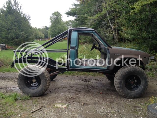

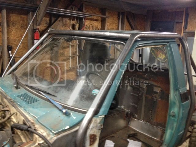

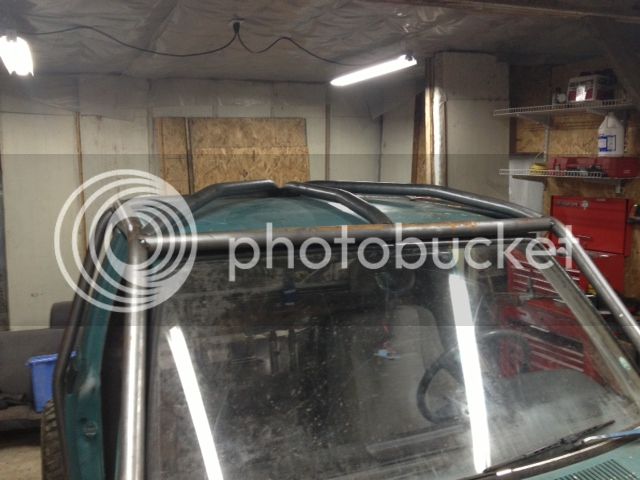

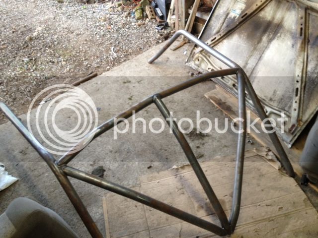

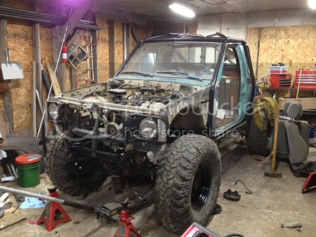

Been tinkering on it here and there slowly making progress. Got the a pillar tubes tacked in place along with the upper windshield tube last weekend.

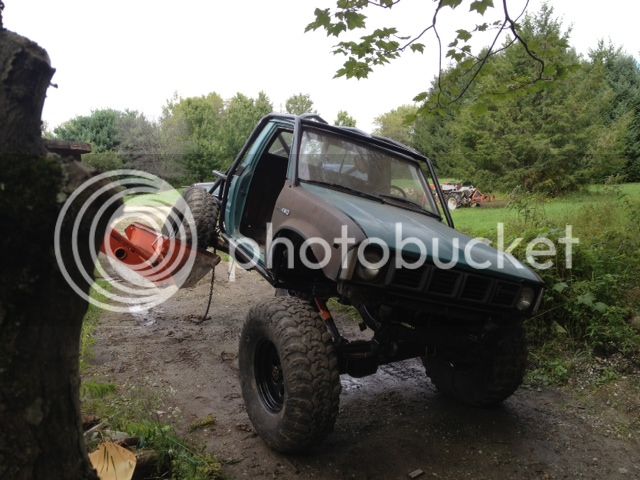

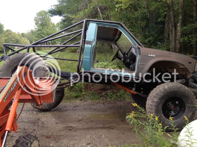

Cool poser tractor flex shot...

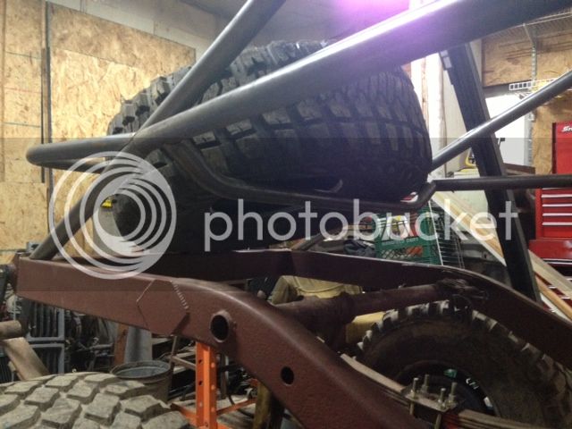

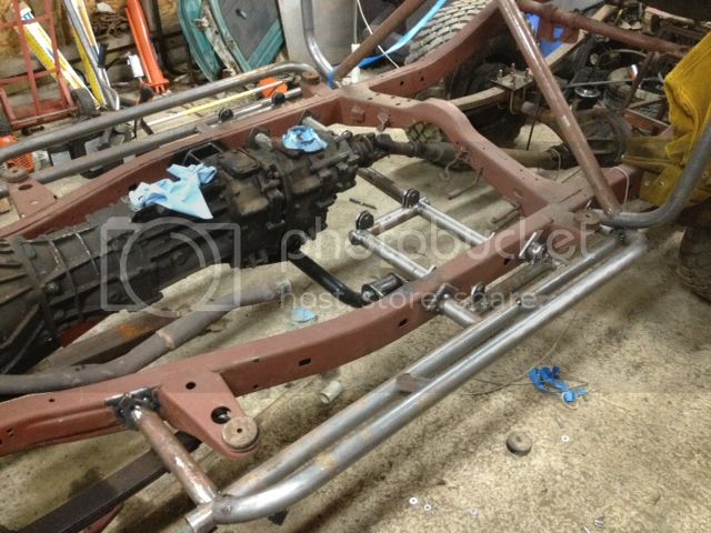

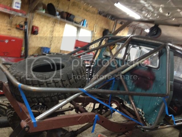

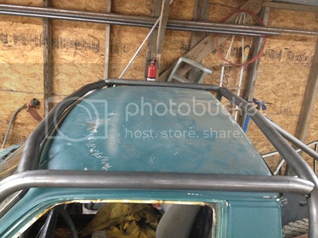

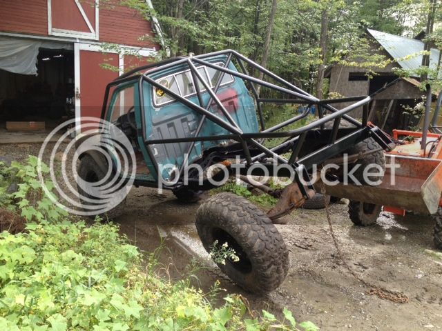

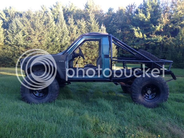

I got a decent bit done on the exo. I need to figure out seat mounts, then I can pull the front part of the cage off, then yank the cab off again so I can finish the floors and finish welding the cage. Its getting closer.
Roof:
Spare tire mount/shock crossmember:
Cage:
Obviously I still need to add more member to the cage. But the main structure is done.
pretty sweet build!
I used to hate exo cages but know that I have an internal cage I hate that more! im about to cut it out and build an exo around the passenger compartment.
I'll post up some more pics of the floor when I take the cab off to finish it. The only thing holding that up is figuring out seat mounts.
I too was never a fan of exo's but I definitely wouldnt fit with an incab cage. I've grown to like well executed exo's. Unfortunately there are a lot of horribly built exo's floating around.

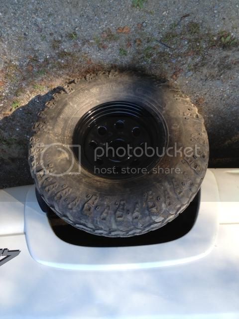

Well time to get this thing finished. I bought some tires, not exactly what I wanted, but I got a good deal on them so they'll have to do. 39.5in Iroks...17in wheels will be arriving tomorrow. Hopefully I can get my friend to mount them up this week.

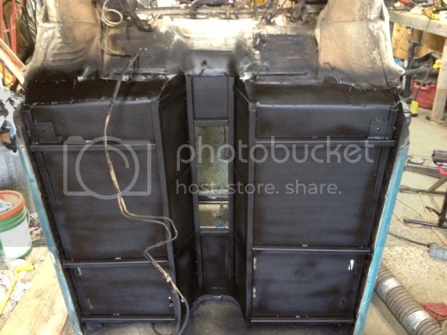

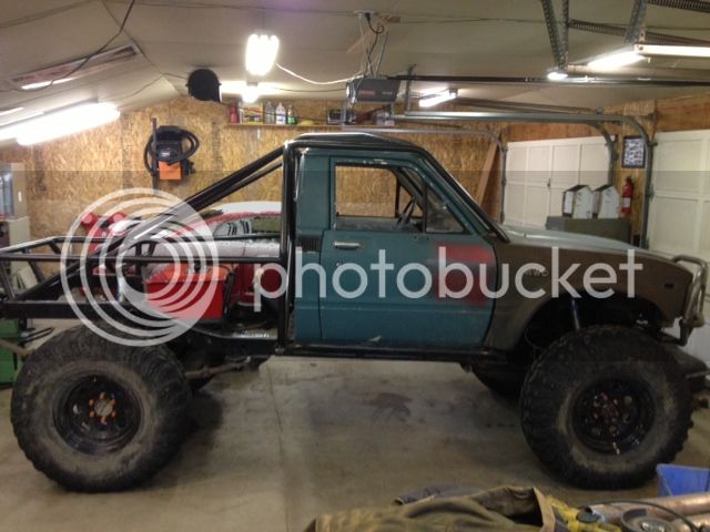

Over the long weekend I got quite a bit done. I had been stalled out on making seat mounts. But once I got over that hurtle it hopefully will be smooth sailing. Last night my friend and I lifted the body off the frame so that I could finish the bottom of the floor and finish all the welding that would be more difficult to do with the cab on. Today I got the floor finished and almost all of the cage work tacked. Hopefully tomorrow after work I can get a bunch of the finish welding done and maybe some paint on it so the cab can go back on.
Anyway here are pictures.
So this weekend was fairly productive. Saturday I got all of the chassis work welded that would otherwise be inaccessible with the cab on. Then a couple friends came over and helped me paint and put the cab back on. Today I got the front part of the exo finished and the IFS outers on. I'm going to run slip on Tacoma rotors with V6 mini truck calipers. Tomorrow night if I'm motivated I want to get the IFS rear axle in the truck and the front fenders clearanced for the cage and tires.

Anyway I rolled the truck out today to measure for shocks. I still need to reinstall shifters, bedline the floor, install seats and harnesses, move the front axle even further forward, decide on my fuel system and whether or not I'm going to put the RE in now. I'm also in search of some stock LWB bed sides, I really want to put the skins on. But here are some pictures.

Really like the tube work over the cab and the way it tucks nicely behind the fenders.Any plans to run bedsides over the tube?
Thanks!
I'm hoping to find some bedsides to run on it. But so far I've only found one 1st gen bed locally and they want more for it than I want to pay for 2 bedsides.

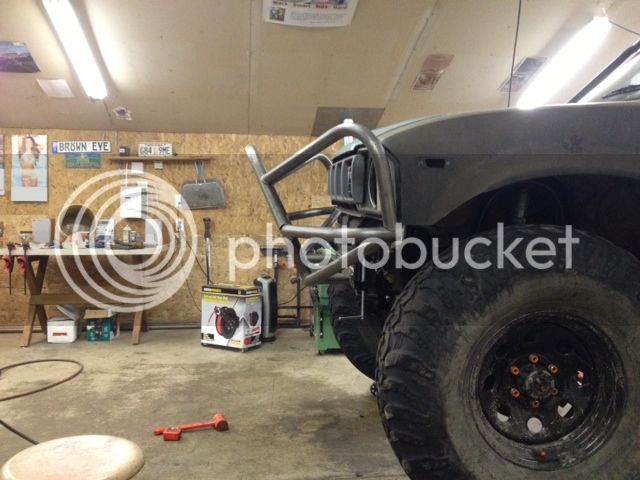

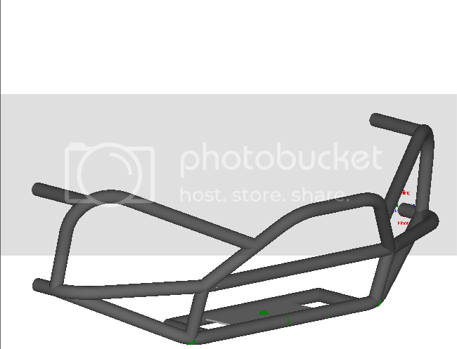

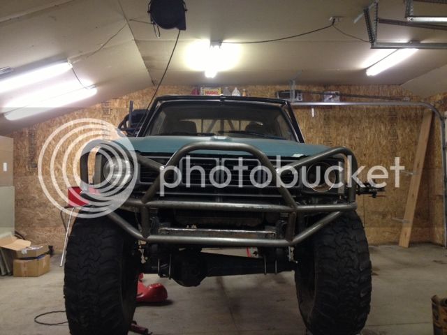

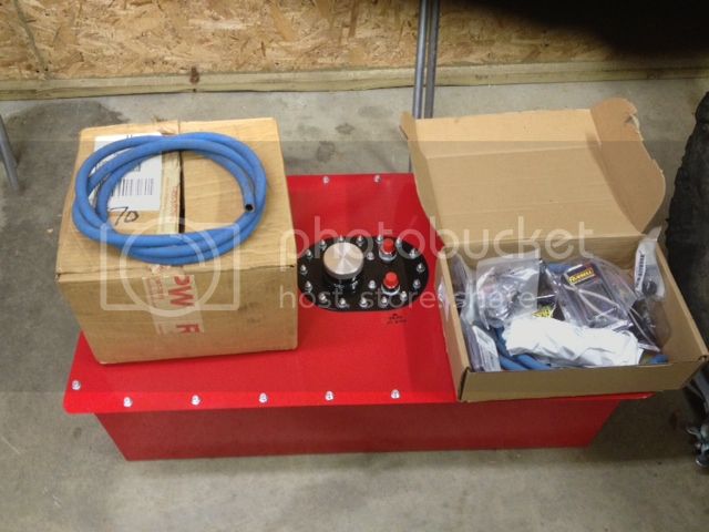

I worked on my truck a bit recently. Most of my fuel system parts came in Friday, still waiting on the Aeroquip hose and 2 fittings. So I started getting ideas on where to mount my cell. I also whipped up a front bumper with the help of a friend. I designed it on Bend Tech Pro and then built it according to the printouts. It worked great, I dont know why I waited so long to buy it.
Pictures...
I ended up moving the whole bumper 1in closer to the truck after I took the pictures. I think that was a big improvement. I'm going to tie the top hoops into the a-pillar tubes over the headlights and through the fenders.

So I have the bottom of the fuel cell mount built, fuel system plumbed as far as I can without having the EFI parts on the engine and I added a leaf to each front pack and welded a spacer on the the drivers side perch.
Going to have to redo my exhaust, probably going to lose the flapper.
For the straps on my cell I'm going to run 2 pieces of flat stock vertically both on the front and back of the cell with a 1in flange on the top to match the flange on the cell. Then run 2 lengths of flat stock over the top of the cell sandwiching it. Is it necessary to use 2 bolts per corner of the cell (8 bolts in total) or is using 1 bolt per corner sufficient? Hope that makes sense...
Last but not least, my cell has a rollover valve on the vent. Should I still run the vent line as described in the BillaVista tech post? Or is just running the vent somewhere out of the way good enough?

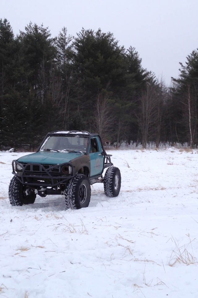

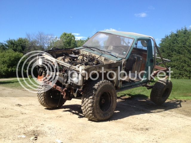

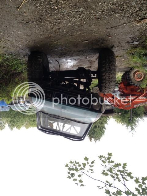

I havent updated this in a bit. But the RE is in and running decently. It loads up at low RPM under heavy load. But I ripped it around in a field for a couple hours last weekend and plan to do the same this weekend since we're getting snow dumped on us currently. Here are some pictures.
