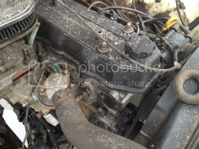

Anyway those are my ramblings for now. Here are a bunch of pictures. I'm new to these mini trucks, so if you see something in the pictures that looks obviously out of place let me know. I need to rewire the fuel pump, get a breather for the valve cover, make a better air rail block off plate among other things. Or just swap in the RE, see the dilemma?

That engine looks like a hacked up mess to me. Later valve cover, busted sensors, and at least one important hose is missing. Just swap in the 22RE, assuming you have everything and it's running well. You will need a different fuel pump, the EFI wants ~70psi.
If it has a later model valve cover I wonder if it has a later model head too. I'll have to look and see tomorrow. The only downside is the RE has 200k. This engine was supposedly recently rebuilt. If I could toss the EFI parts on this engine that may be the best bet. I'm probably going to end up with a cell because I plan to back half it and run a 4link.
EDIT:
Correct me if I'm wrong but in this picture you can see the threaded holes the EFI manifold would use? So it is a later head and my EFI parts would bolt right to it?
I may be wrong, but I don't think you can put a later head on an early 22R. The earlier engine uses domed pistons. So, if that is a later head, then it's likely the entire engine has been swapped, just not the intake.
Measure the deck height of the block, if you can. You can do it with a tape measure. The early (pre-85) blocks are 11.280" ("tall" block), but in '85+ the block height is reduced to 11.090", a difference of almost 1/4".
Pop off the valve cover and look at the timing chain. The original '81 22R had a double-row chain.
That dipstick is also from a later engine.

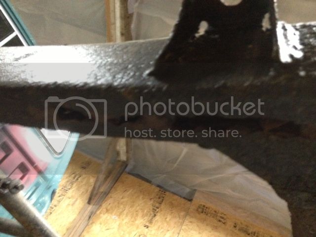

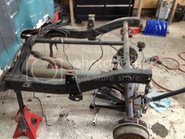

I pulled the truck into the shop today and did a little work on it. Started scoping out the 63s, which is when I found out the rear frame on the drivers side is rotten. I also removed the bench seat and carpet and found a surprise.
Frame, plan is to cut the factory frame off just behind the gas tank crossmember and build my own frame from 2x4 rectangular tubing.

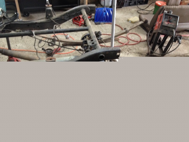

Put in a little time on it today. I hit a roadblock when I realized I hadnt finished bringing all the tools I needed to my new shop. So basically all I did was unbolt the suspension and cut off the back of the frame. Tomorrow I hope to rebuild the back section of the frame and get the 63s in.

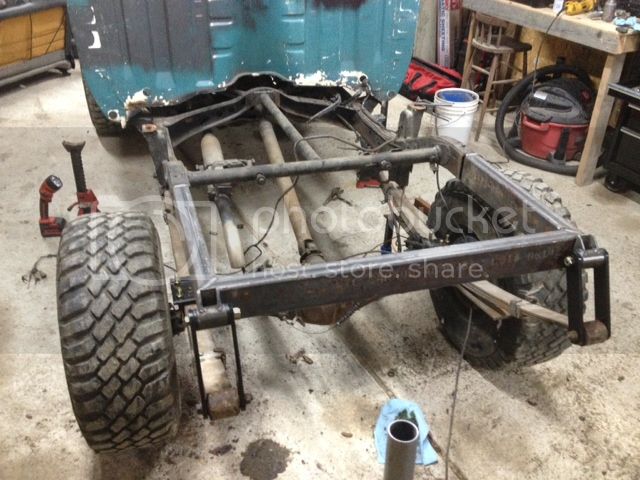

I succeeded in my goal to get everything tacked together tonight. So tomorrow I just have to burn it all in and make some fish plates for the frame. Shouldnt be too bad. I also need to pull the rear axle from the parts truck and put that in, but there's no huge rush. I'm hoping I guessed right and once the cage, propane tank and spare are sitting in it the shackle angle works out ok. I think it will.
Everything removed...
Quite the size difference
