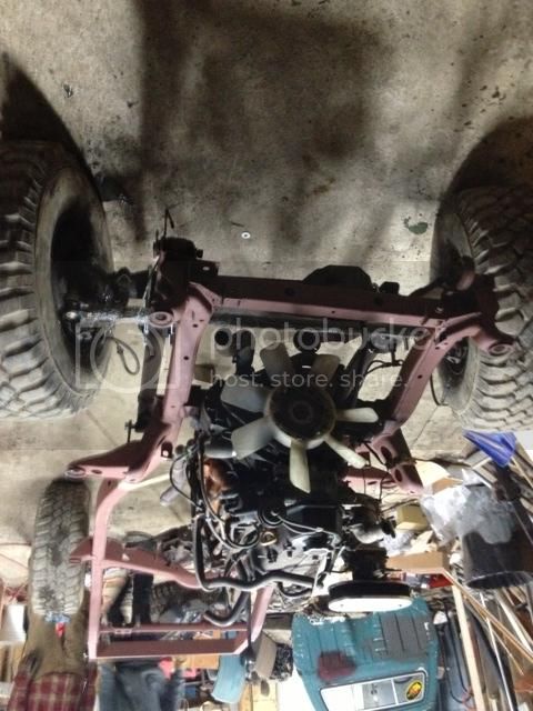

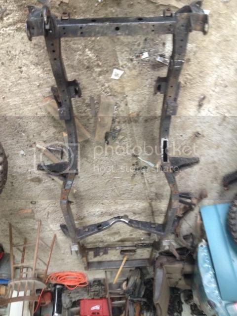

As you can see in the above picture I pulled the cab off the frame. I wire brushed the whole thing, found a bunch of rot. So Thursday with the help of my brother and a friend we stripped the truck to a bare frame.
Friday I cut out all the rot, welded in new material and got the frame in primer and back to a rolling chassis.
Saturday the drivetrain went back in and we set the cab back on the frame.

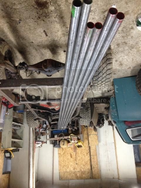

Bunch of 1.75 .120 wall DOM
Stripped frame, you can see one of the holes I patched.

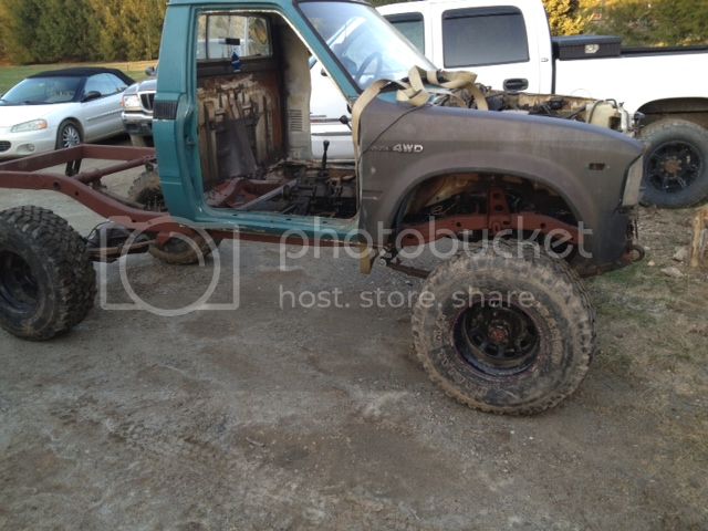

Outside shot, you can see that the floor isnt there.

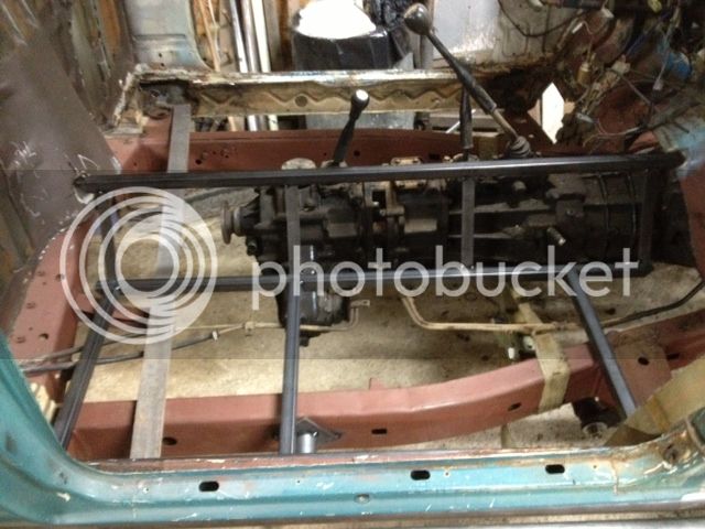

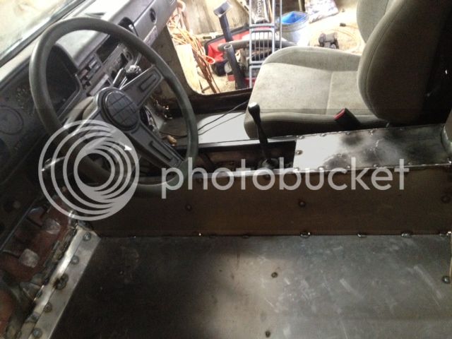

I'm 6'4" and as anyone with one of these trucks knows, the cab is tiny. So to give myself some space to sit I cut out the floor and lowered it 2in.
Its mostly done, still needs some finish work. Basically just dress the welds, seam sealer and some bed liner. As you can see the dash is now back in too.

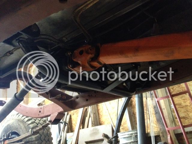

I made a basic t-case crossmember and a square D-shaft. Doesnt hang too far below the frame.

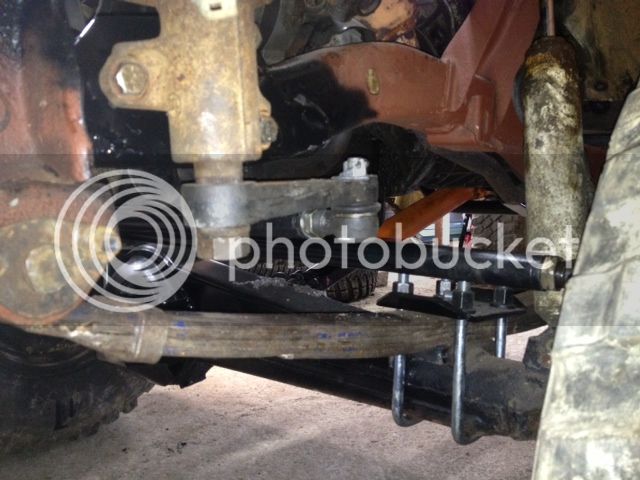

High steer, RUF, ubolt flips, gusset, armor, IFS box and power steering.

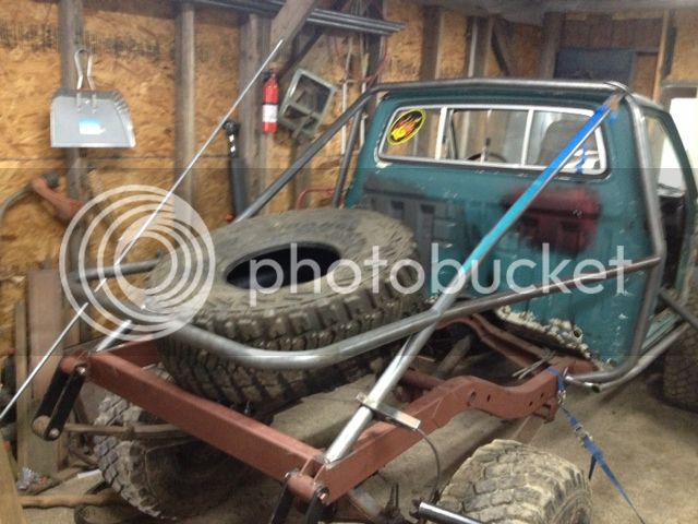

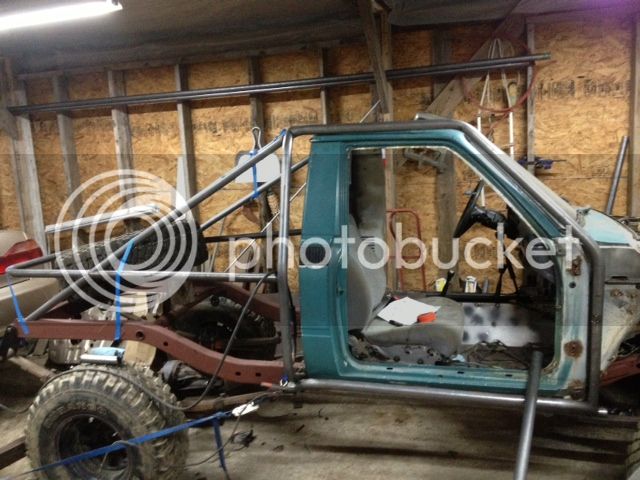

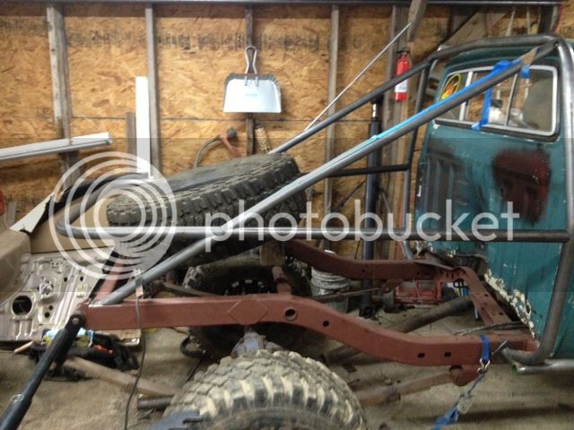

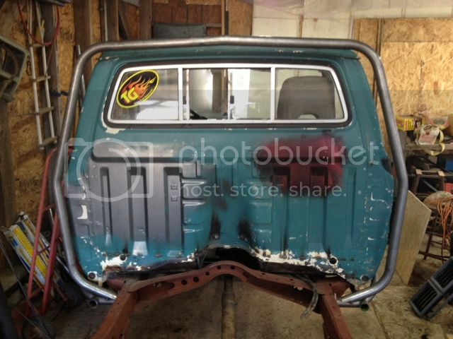

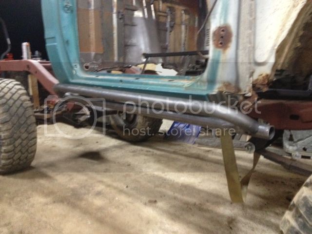

Here are 2 pictures of where the exo is now. I got the first a-pillar tube bent today also but I have a little fine tuning to do before I tack it in and nobody was there to hold in it position when I took pictures. Hopefully tomorrow I can get the a-pillars tacked. Then I can go through and make all the braces and such.
I got my a-pillar tubes bent and tacked on.

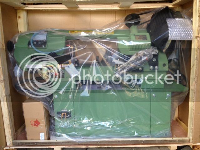

Then this followed me home.
Havent gotten it set up yet as there is a Honda Accord in the midst of a gas tank swap in the way of bringing it into the shop.
