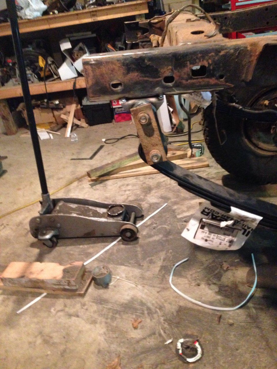

Got the back end mocked up today. I think the shackle is too vertical, but I'm not sure how much it will change with the bed on the frame. It goes vertical with me (~200lbs) sitting on the rear of the frame. TG also says the springs will settle some. Thoughts?
I've also read they'll settle but don't think enough to get the desired angle from that location. I'd move it forward so you get ~15* or so, hopefully they end up about right after that.

Moved the shackle hangers up about an inch for a much more acceptable angle:

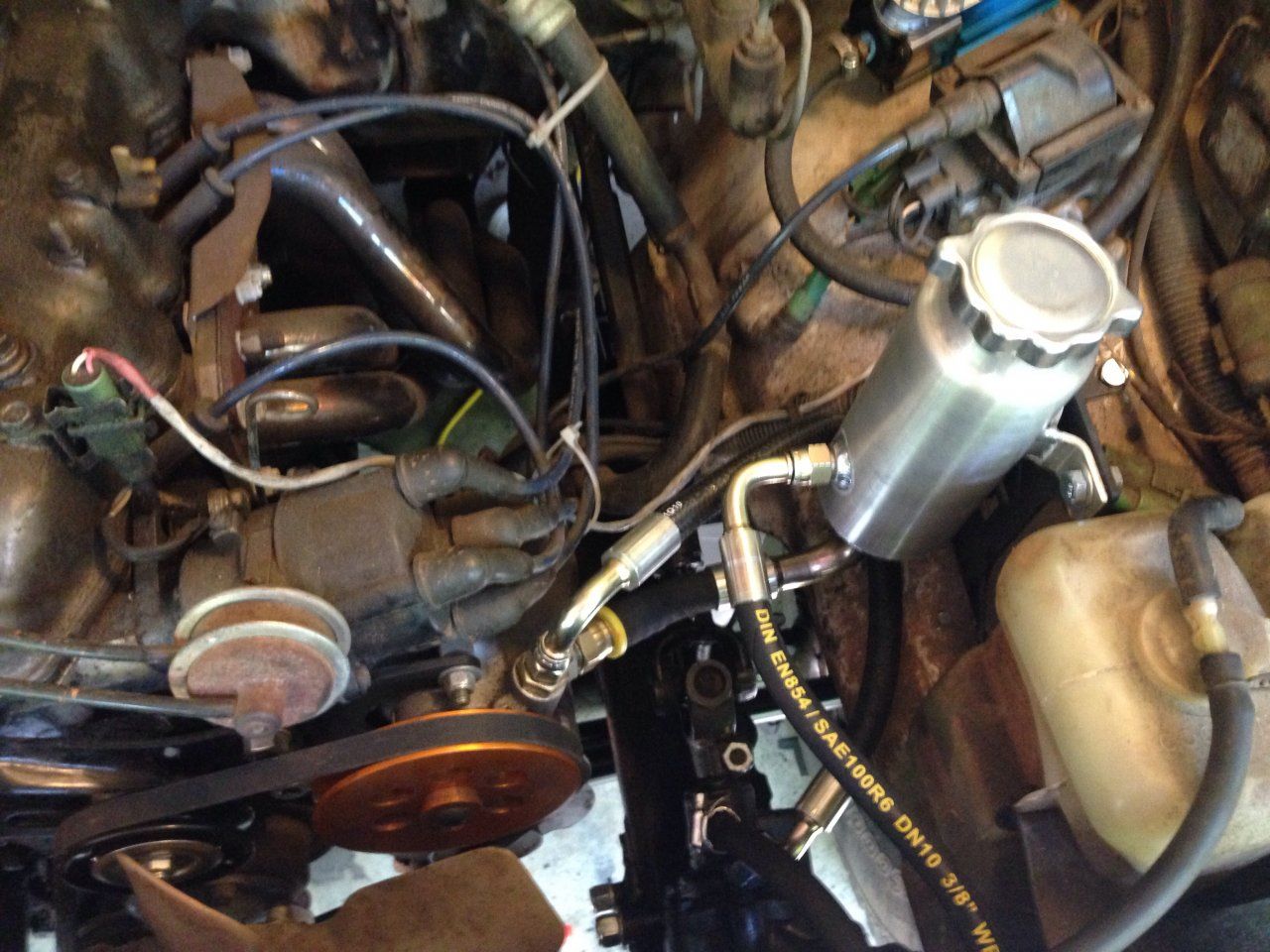

Drove around the 'hood and everything seems in order. Only got to about 25mph so hopefully high speed doesn't yield death wobble. No leaks and my favorite part may be the power steering.

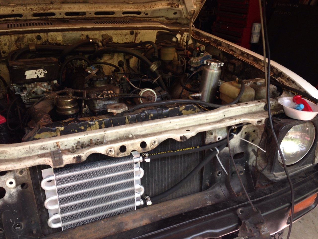

Parts to finish the front came in today. Should be able to measure for shocks once I get these on. Thinking about changing my onboard air options. Can't decide if I should go custom or buy a shiny new compressor. All I know is that stupid little ARB compressor is a goner.
