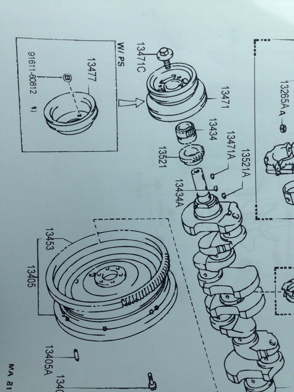

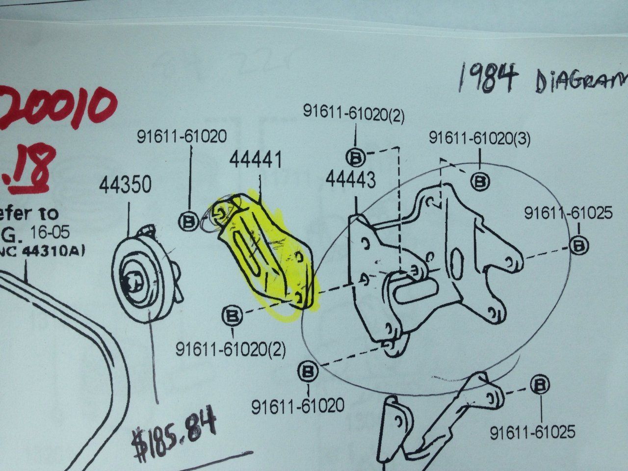

1) power steering - I went up to the dealership today to find some parts not readily available (idler pulley bracket and additional crank pulley for the ps belt). From looking at the '81 22r vs 84+ 22r diagrams, it appears the crank pulleys differ. Of course pre-84 parts are discontinued. I've found several treads on ps conversion but wondering if anyone knows if the crank pulleys are in fact compatible between pre- and post-1984 engines. Here is the rest of the ps kit from trail-gear. It seems to be pretty nice.

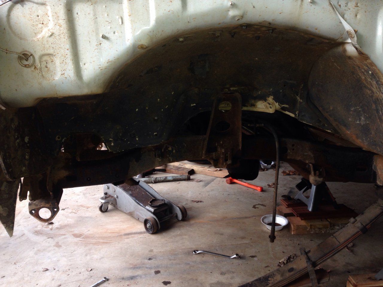

Here is another pile of parts I've got to find a place for. I'm about halfway through disassembling the front end.
Figured I post this up in case somebody was looking to add PS to a non-PS 22r. I was able to get these from the dealership - all part numbers come from a 1984 22r but I imagine the part numbers span multiple years. I got the PS pump bracket from trail gear.
Idler bracket and pulley:
Crank pulley #2:
Part numbers:
