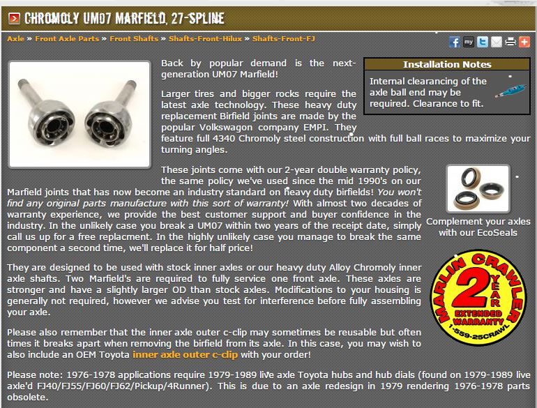

Anybody got any feedback/experience on the 27-spline Marlin Marfields vs. TG Longfields? I'm getting ready to move my rear locker up front and figured I better upgrade before I get stranded at Chocco in a few weeks. Marlin is running a sale right now which makes them cheaper than the Longfields. I've been looking at the 30-spline stuff, but it seems a little overkill for my setup and wallet.

Ted and I bought the TG Longfields around Aug/Sept last year cause they were on sale (like 40% off). Honestly, I would buy which ever ones are the cheapest and just roll with them. Unless you really just hate money and want to spend a lot and get the RCV axles :grinpimp:
you're on 35s , right? Probably not what you want to hear, but I'd say find a couple spare stockers and see how things go. I'm sure Ted, John, or Nick would have one or 2, heck I got 2 in a box if you can't find one. Anyway, save your pennies and See how it goes. If your going to plan on pushing the limits, and you pop one or 2, then look at getting the chromos. But if that happens, then I'd recommend skipping the 27 spline and bumping up to the 30 spline sets.

35s will pop a stock birf no problem, I went through 4 in a single wheeling season before upgrading.
Dollar for dollar I'd go RCV for any number of reasons but mostly b/c of warranty. RCV is the original manufacturer of the Longfields before TG took them over and has a very solid reputation. I agree with Jynx, best option is to skip the 27 splines and go 30 spline out fo the gate, you wont regret it. That said, I ran TG 27 spline birfs with 35s and even 37s without an issue and still carry one as a spare so if trying to save a buck they'll do the job.
Thanks for the input. I've got an extra set of stock birfs, but with as little as I wheel, I don't want to spend my weekend off wrenching in the woods. I'm not quite ready to pull the trigger on the 30 spline as its a little more than I want to spend right now. i may take the risk on the 27 spline and see how it goes. I'm going to swap axles due to the weird camber I've got now and figured I should do it since it'll be torn down anyway.
One question: can I go to 30 spline without getting new inner axle shafts? If so, is it just the hub that also needs to go 30 spline?
It is the splines in the actual birf that go from 27 to 30 spline, so the new inner is needed.

I think you should stay with the stock birfs too. I wheeled on 35's for more then a year with stock birfs and dad didn't break much with 36s. It really depends on how much you gas it on the hard stuff. Most guys (other then Ted) will be careful enough on the medium stuff and bypass the hard stuff. So unless you are planning on flopping/rolling your truck most of the time or beating it you should be fine. :cheers:
