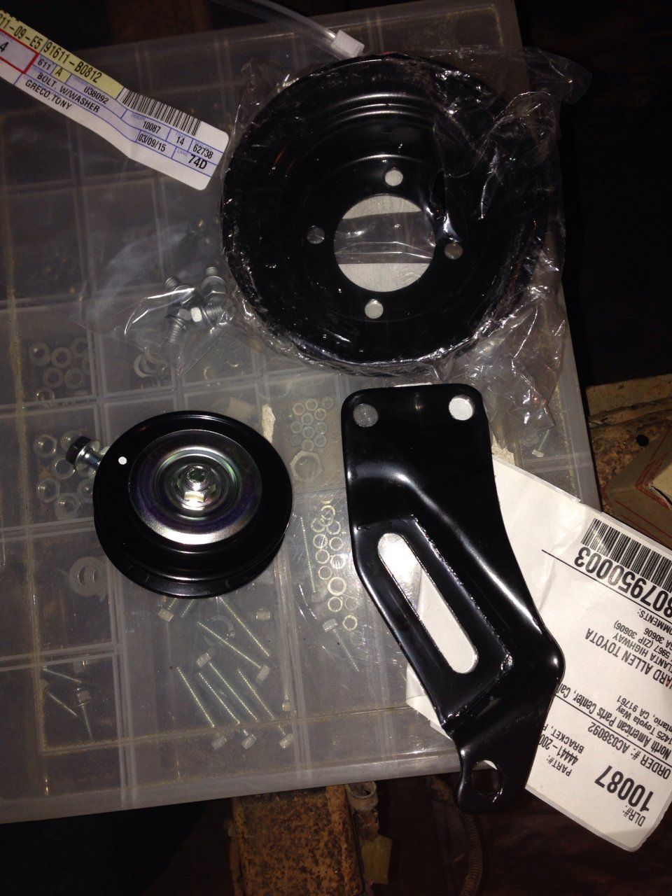

1981 Pick-up Build
While not nearly as exciting as Ted's new purchase, I got the last pieces of my PS setup.
And decided I didn't want to be a redneck anymore.
