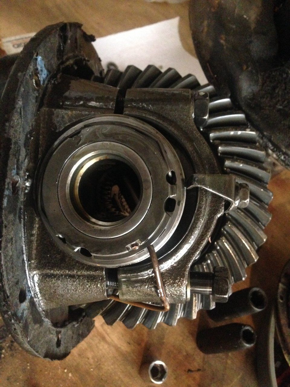

Tore the axles down today to swap the diffs and install the Spartan. Found out why the locker wasn't working- this is exactly as I found it. If you can't see well, the copper line sheared. Do you think this was a poor install and things weren't torqued correctly? It was set up about 4 years ago but the locker didn't stop working until last year. Any potential damage to the gears because of this?
And a pile of parts
And a pile of parts
Holy hell, how did that diff even work?
Umm, I think the copper line shearing was the least of the issues. The fact that the cap separated from the housing was likely the start of the problems, the line shear was just a result of the cap letting the bearing rotate.
I would pull it all apart and visually inspect everything and then decide how to proceed from there. A few new parts for the locker is very likely all that you will need to put it all back together and have a working locker.
I agree completely - the line shear was definitely caused by the loosening. The other side was also loose but not nearly as bad.
I plan to bring it by the shop next week and see what they have to say.
I bet the holes weren't cleaned out, probably had some oil in them, bad torque readings, if they were torqued at all and no loc-tite. Are there any teeth marks on the side of the carrier? If not then the gears probably are fine. New bearings, and set it all back up right and I think you should be good.
Jynx has nailed it as usual, certainly not torqued and maybe not even tightened. If everything looks good and you replace the air line I'd run it.

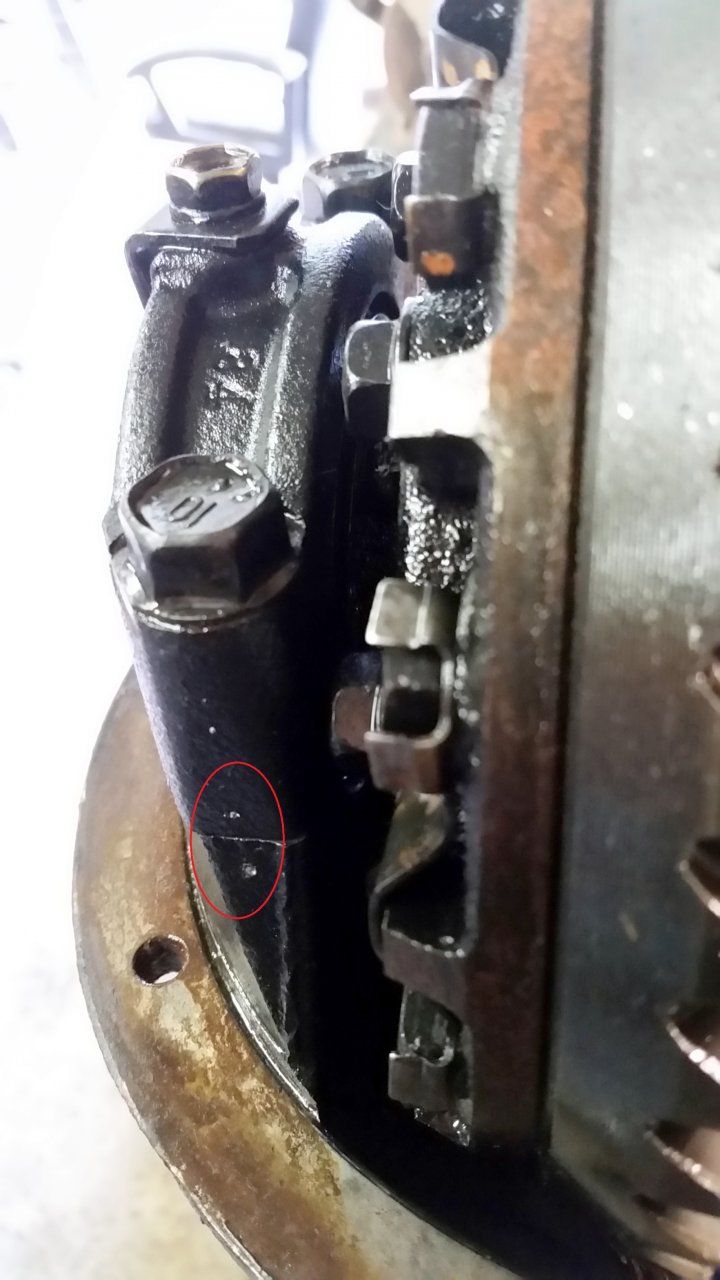

This is important, We take a punch (NOT a pen or sharpie!!!!!!!!) and mark each side with either a 1-punch mark or a 2-punch mark depending on the side, this is to ensure everything goes back together exactly (X-ing fingers) as before it was taken apart. We'll mark bolts, clips, diff nuts, etc... Notice the single punch mark in the red circle.

Notice 2 punches on this side and only 1 on the other side. A little hard to see in the pic but notice the top of the nut is also 2-punched indicating it's exact location.
