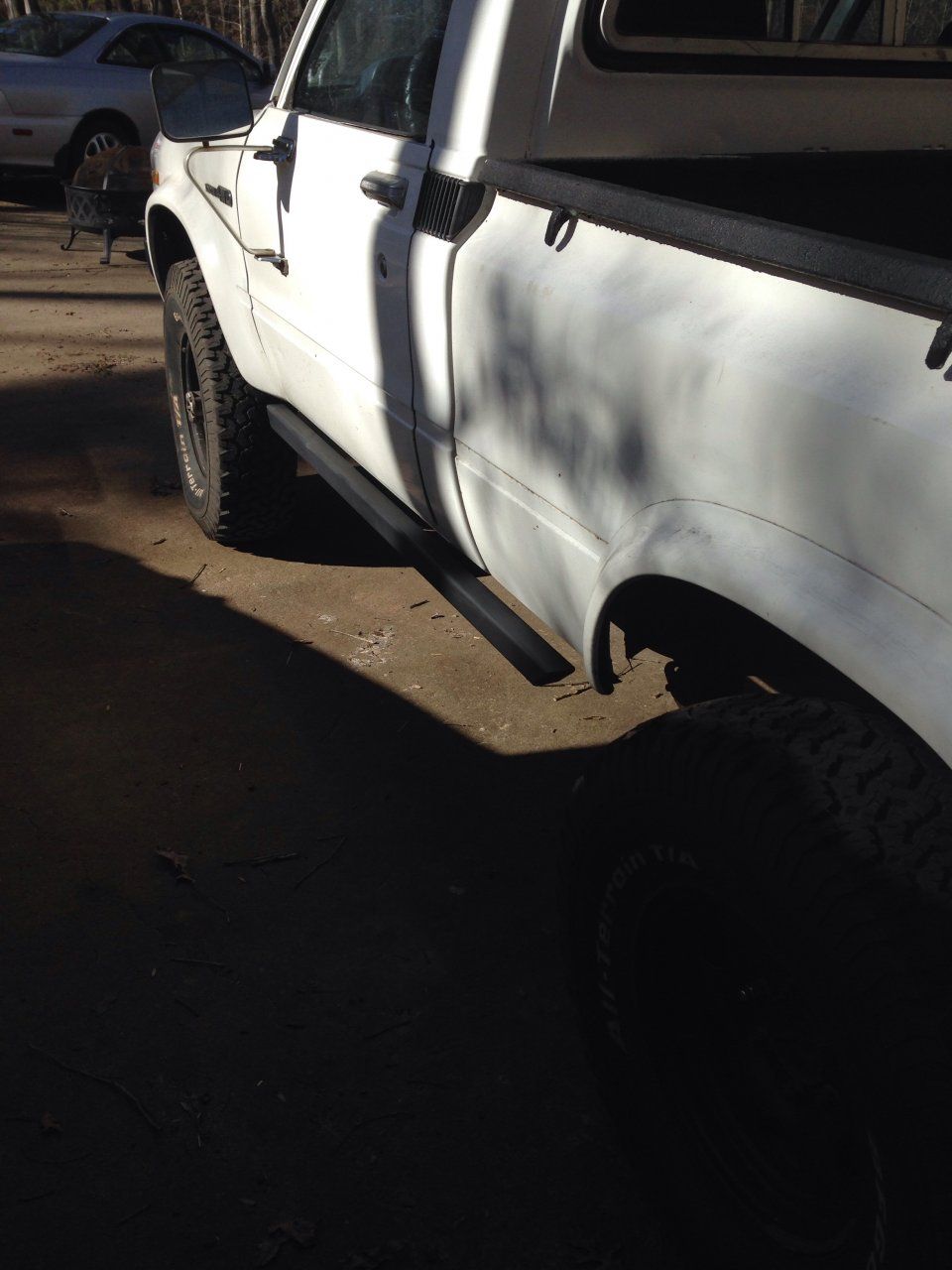

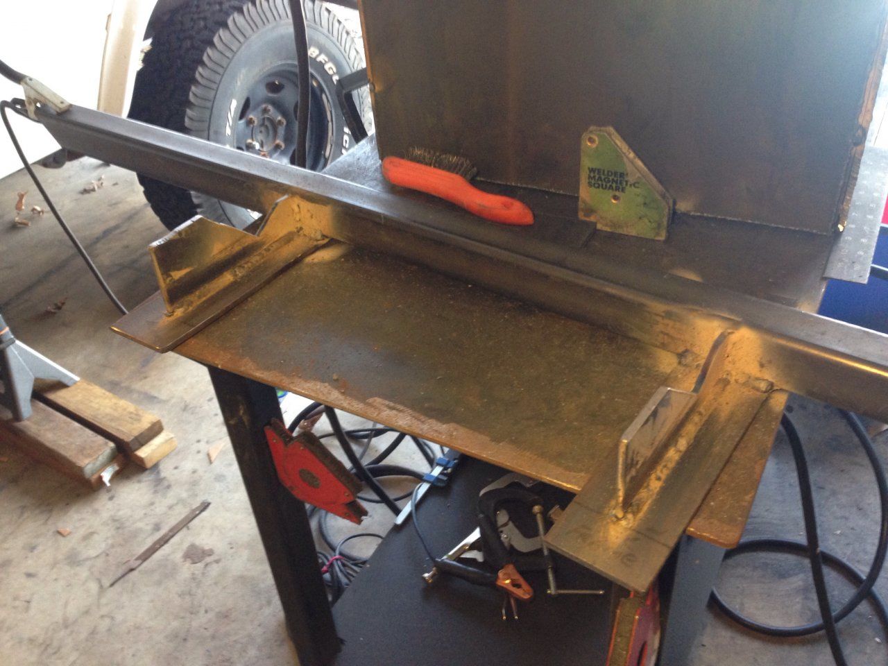

Here is a little offroad related tech. I built my sliders out of some 2x2x3/16 square tube. The brackets are all 1/4 plate. We'll see how only two attachment points hold up.
I'm still running flux and I hate the mess it makes. It really shows in the pictures.
Yeah, I know how you feel on the Flux wire. I did some welding Friday night and the spatter mess is a real pain.
I have a can of tip dip and it seems to cause the tips to jam. I used it for the first time on Friday and while it could be operator error, I was not impressed. You just dip the warm nozzle in it to get a coating on it correct? Not sure what I was doing wrong.
I also got a can of the spray and while it seems to help some it evaporated and fogged up the glass on my helmet and if you spray it on hot metal it evaporates off. It is also highly likely that I was not waiting long enough before welding thru it.
Not trying to poo-poo on the suggestions, just passing on my recent experiences. I'm gonna keep working with them to see if I can find a good combo. I also know that I still need ALOT of practice with my machine. from what I read if you get the machine dialed in then that is supposed to minimize the spatter. For now my spatter reduction technique is finding a good flap disc for my small grinder :hillbilly:
