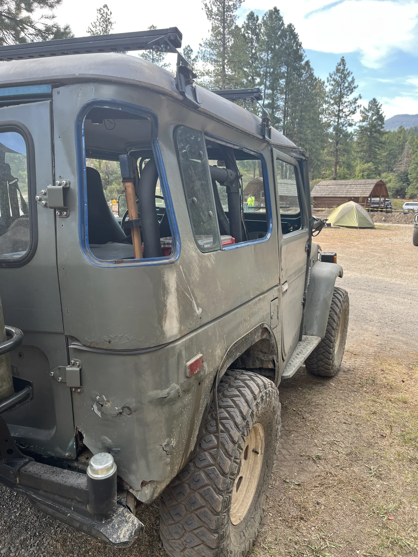

Well Retro went to SAS9 and did not fare well. Ended up on her side (flop!).
On Monday of SAS9 took her up Mineral to Poughkeepsie to corkscrew. After the wall, which Retro cleared, had a mishap on the next obstacle and over she went. Luckily did not roll, only flopped. With the help of the group @Ditcherman @Tank5 @Mike Shull @doseman @Broski @matzell and the guy in the j**p they got me turned back on the rubber side. Thanks for the quick actions and follow through to get me back up safely. We ended up there for the next few hours getting her running (won't go into all that, it is a long story) and Retro up to the top. Winch solenoids gave up the ghost so we had to drive it back around to the bypass.
The ole girl is hurt for sure but she still is running good and drivable. I have some work to do to bring her back around but with my local club have plenty of good people to help when needed.
PSA folks: WHERE YOUR SEAT BELTS, ALWAYS....
If not for wearing my seatbelt I may be telling a different story here. I came out of this incident without any physical harm. Not a scratch not a bruise. The seat belt did its job 100%. Now my pride and ego is different story LOL
Again, I find examples of why I love this community. All of the folks mentioned above stuck around and help where/when needed. Truly grateful and could never repay you guys. THANKS!!!!
View attachment 3970212View attachment 3970213View attachment 3970216

Allen I’m supper happy you didn’t get hurt.
I feel it’s important enough that I have to say it so please don’t take offense.
Equally important as wearing your seatbelt is listening to others that know the trail better and have more experience.
Know your rig, you need to know how to stop it if stalls on a steep incline and not let it roll backwards uncontrollably.
Allen IMO you were very lucky and it could have been much worse.
This is intended for everyone to learn and not have a problem themselves.
Richard, good point for sure. Thank you and no offense taken.
I made a mistake trying to “drive” through it and panicked when it started to roll back. I am very lucky I was not hurt.

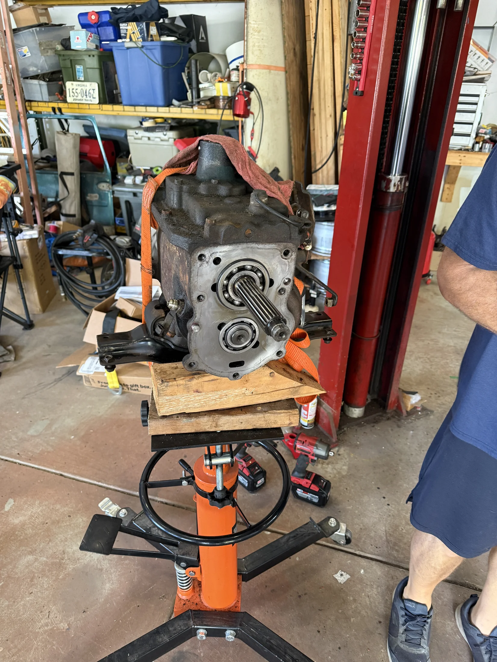

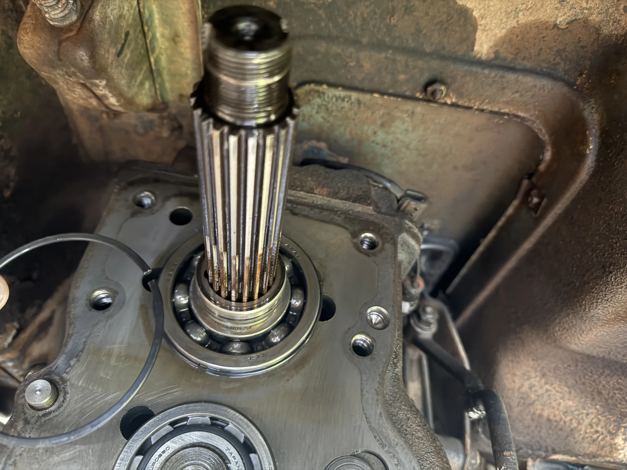

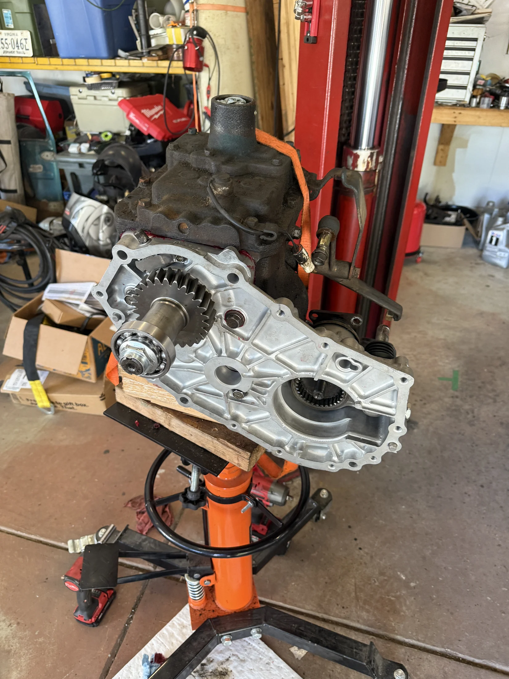

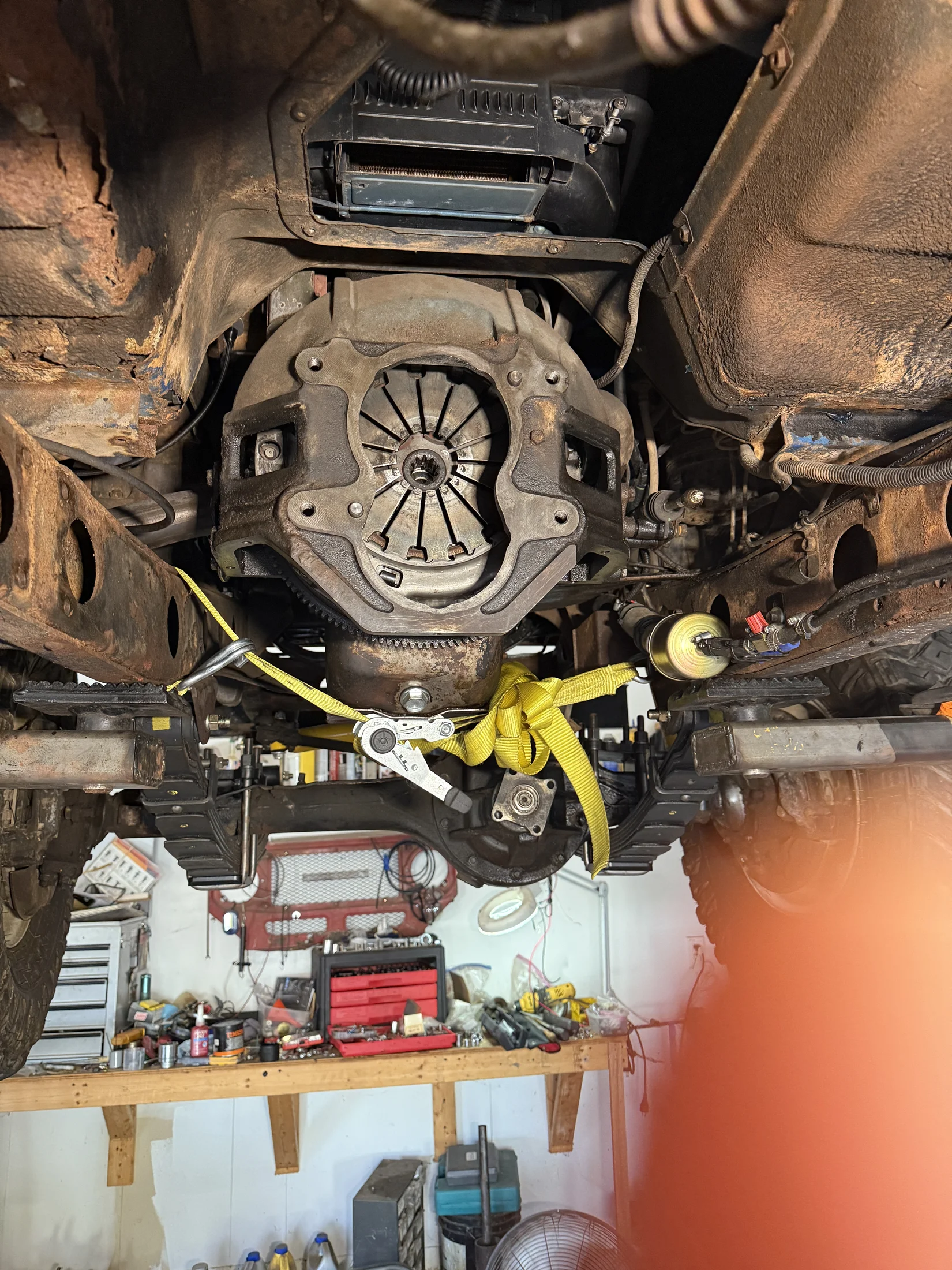

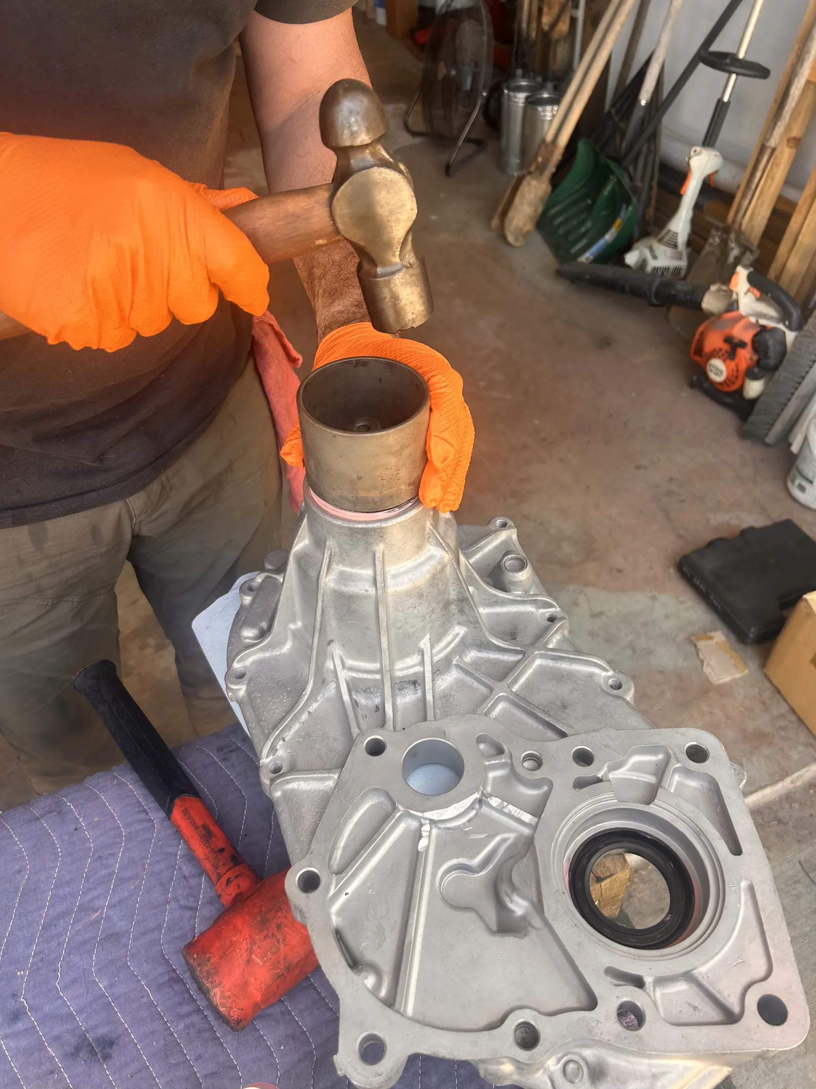

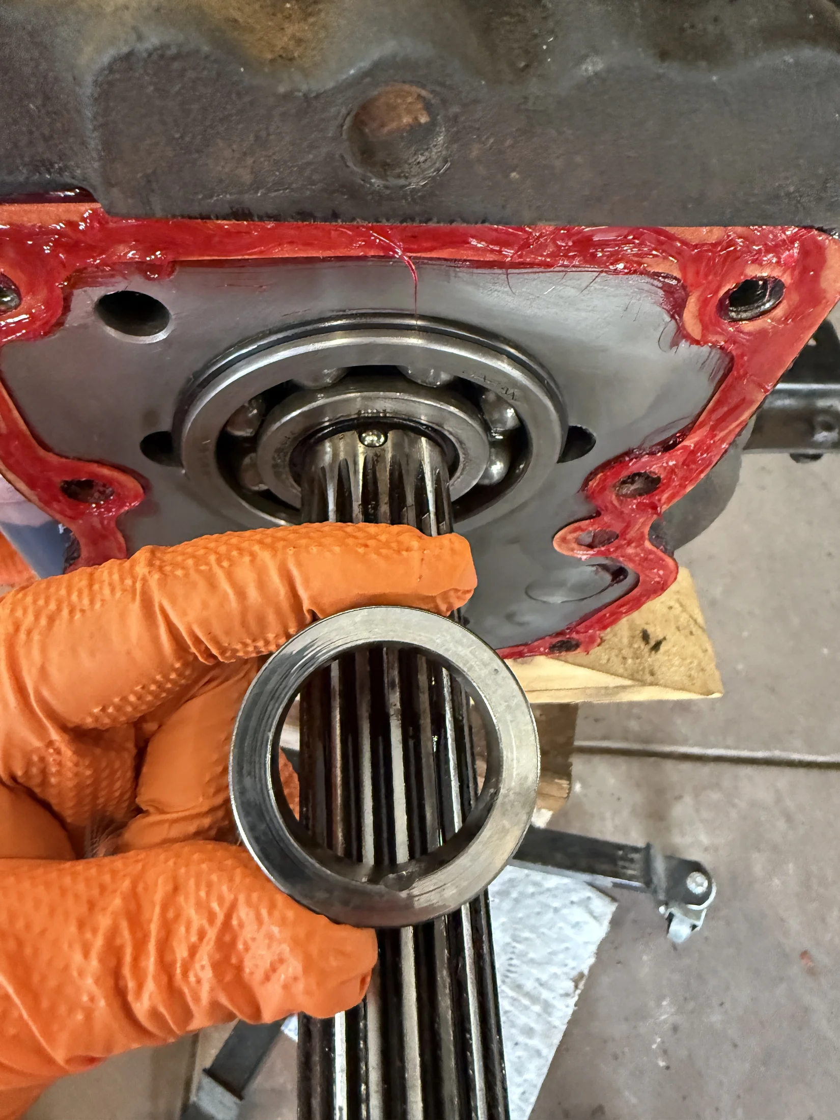

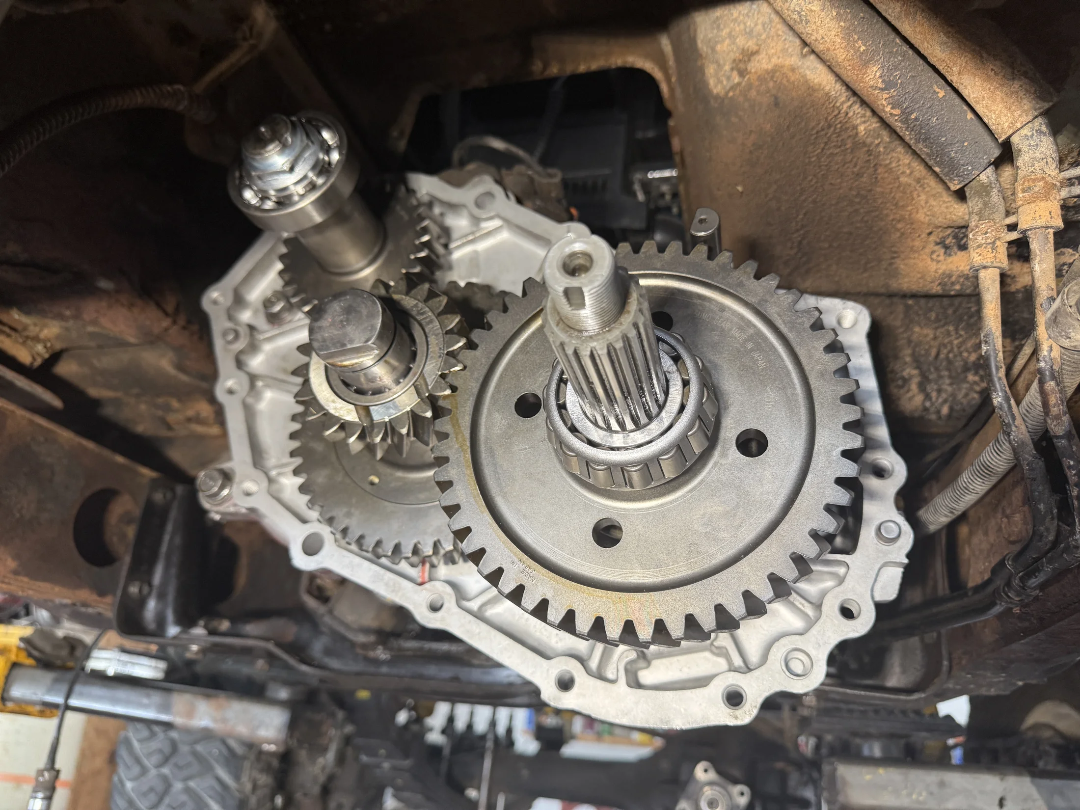

Starting the build back process or atleast the "remove the damage" process. Youngest mancub and I started pulling pieces and parts off the ole girl this weekend. Cleaned her up a bit and took her for a quick ride just around the neighborhood. Planning the next steps. #fallcrawl is in October so just going to get her safe so can trail ride her and then get serious about the next steps. RR all brake fluid. RR all clutch fluid. T-case gears, Soft top, Full cage, 1/8" tub sides are all on the list. I have new springs and u bolt flip kit sitting on the shelf maybe that goes in as well.
Started the t-case regear for 4:1 gears.

Wrapped up the gears. Test drive on street seemed good. Need to get it off road and really “feel” it. Big thanks to @doseman was right there with me sweating, swearing, and hurting. Also big shout out to @orangefj45 for supplying all the parts and pieces and for the technical help.
Wrapped up the gears. Test drive on street seemed good. Need to get it off road and really “feel” it. Big thanks to @doseman was right there with me sweating, swearing, and hurting. Also big shout out to @orangefj45 for supplying all the parts and pieces and for the technical help. View attachment 3999468View attachment 3999469View attachment 3999470View attachment 3999471View attachment 3999472View attachment 3999473View attachment 3999474View attachment 3999475View attachment 3999476

Mike, The more I drive this, in 2wd and 4wd, the more I feel how much a difference these gears make. Not a race car by any means but man she is pretty snappy in 1st and 2nd gear. And 4Lo is just plain awesome. Definitely worth the cost and effort.
It sounds like you are really hooked! I can’t wait to see it again. Low gears have been one of my favorite mods, too. It completely transforms the Cruiser in a good way. Keep it up!
Sorry if I missed it, but what Splitcase do you have (34/36mm)? And what did you have to do to make the new gears fit?
I have a 34mm waiting to go the next project and it’ll want lower gears…
I chose to get (2) 38 mm split halves from George from Valley Hybrids. He had already machined them for me so it saved me some labor on the day of all the swapping out.
Just know the 34 mm you do run a risk of going through the entire piece of the case but it’s doable. You may just end up having to put a piece of you know weld in a a patch on the outside which I know a sister club member just did and did go through his case.
Also check out @matzell build thread. He just completed the grinding of his case as well
