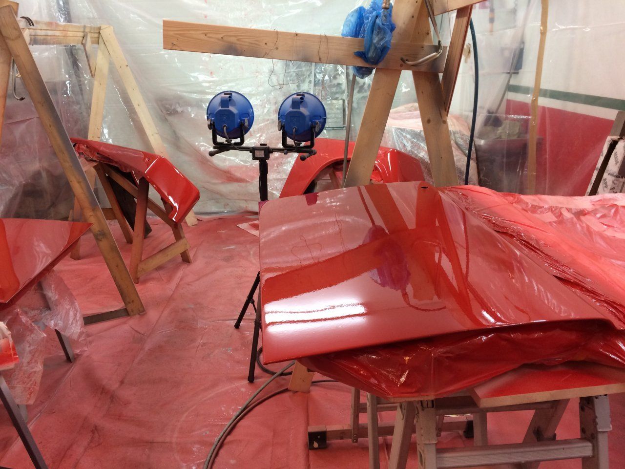

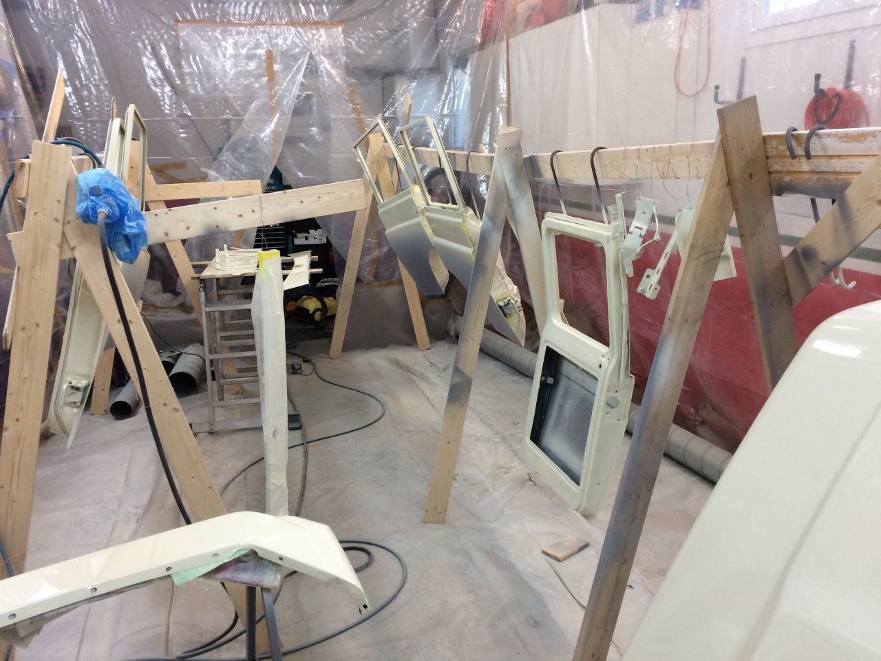

Built a paint boot to my carage and finally getting new paint to parts.
Bonnet, doors and many small parts have now 031 white paint on them. Bonnet still needs another layer of white and after that lower parts of doors with T309 freeborn red. Hopefully at next week starting with body.
Before primer and with 031 white.
Man, that red is pretty. Good Job!
Thank you.
Thats actually my first paint job done completely by me. Have done all the prep work a few times, but never sprayed the final paint. And this far, I'm pretty hapy how its going. Have done some parts twice and there are couple of runs to be buffed later. The biggest problem has been lighting. I have pretty good lights on my garage, but they are too high on the walls. Some places it's hard to see that do you spray wet enough to get proper glos and avoid runs.
