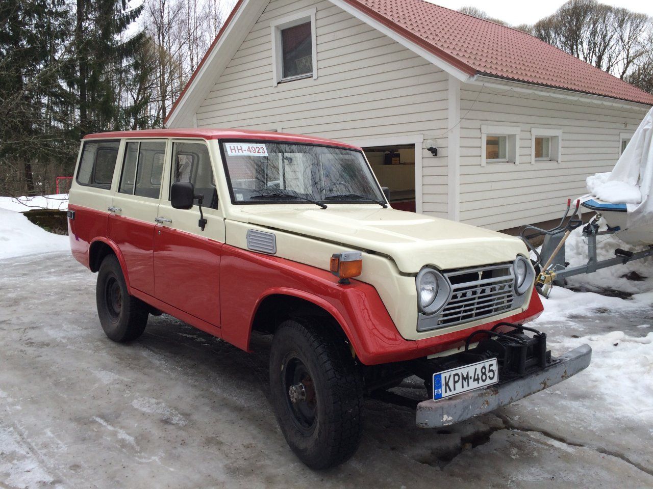

I think she wants to get in warm garage.
That's a real basic model. Absolutely no extras. Even the cargo side panels are plywood.

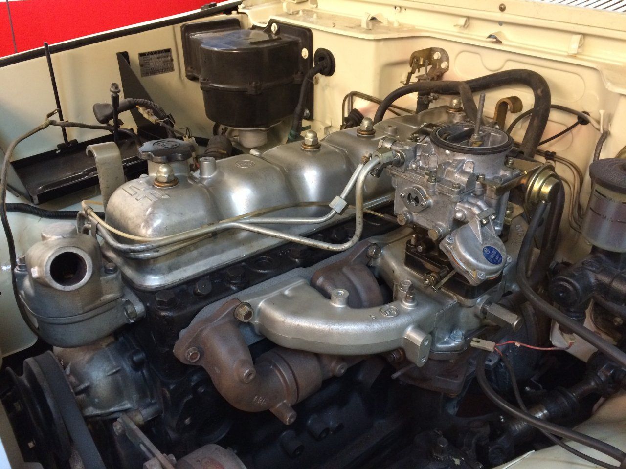

Today tried to get her for a test drive, but maby later.. Looks like had to pull the cylinder head open. When I bought the car it had broken radiator and most likely it had heaten a bit too much at some point. Wont keep water inside, makes a lot pressure. Something to do on easter..

Got the head of. Gasket looked pretty goob and couldn't find any leek points, but we'll see if a new gasket helps. Will clean the head and flap valves now when its open.
While waiting for the gasket kit to arrive media blasted head and valves. Valves grinded and some new paint.

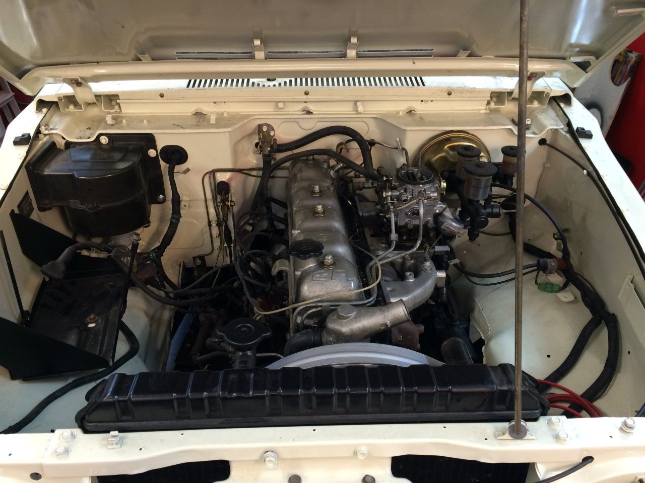

Had also bad heating problems. So changed thermostat with no help. Tried to clean the radiator and find out it was totally stuck. Ordered new one from Rockauto and once got it here noticed it was for FJ40 and didn't fit very well. Allthough delivery was extremely fast, made the order in sun evening and radiator was from California in Finland on tuesday!! Got it though home on friday due to customs.
So I had to make some new fittings for 40 radiator. On pdf the measurements are not exactly correct. I had to modify those a bit when assembling them.
