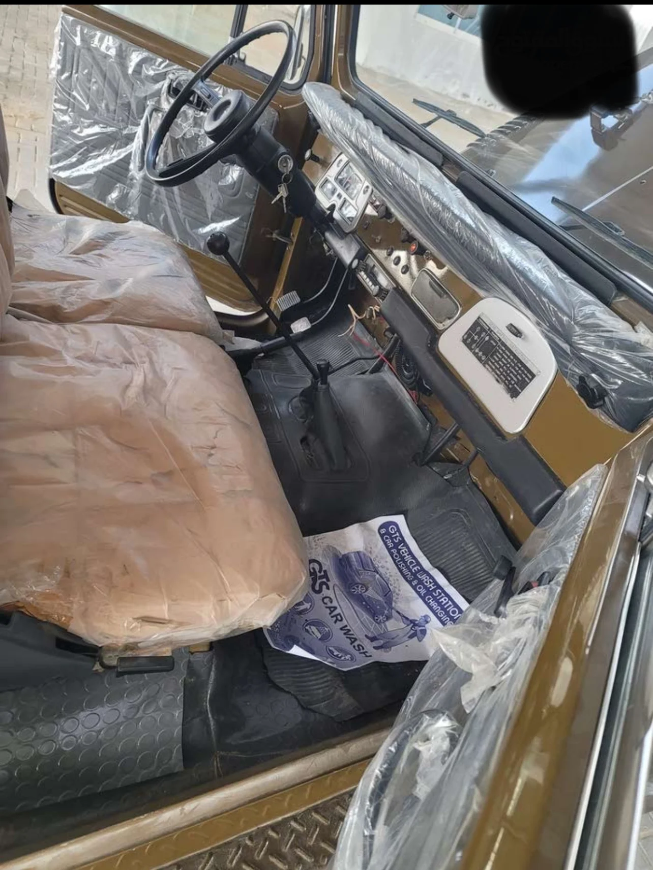

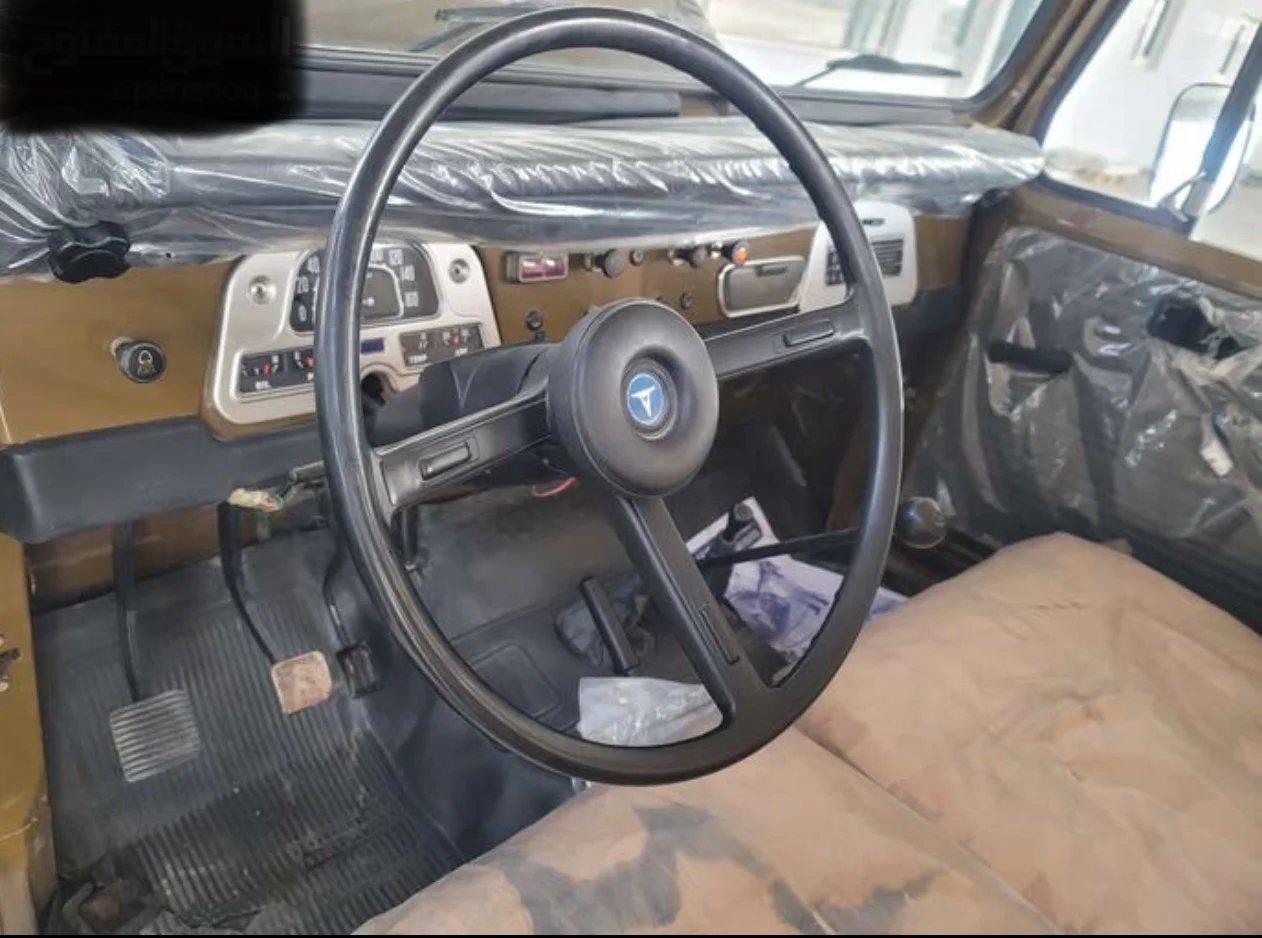

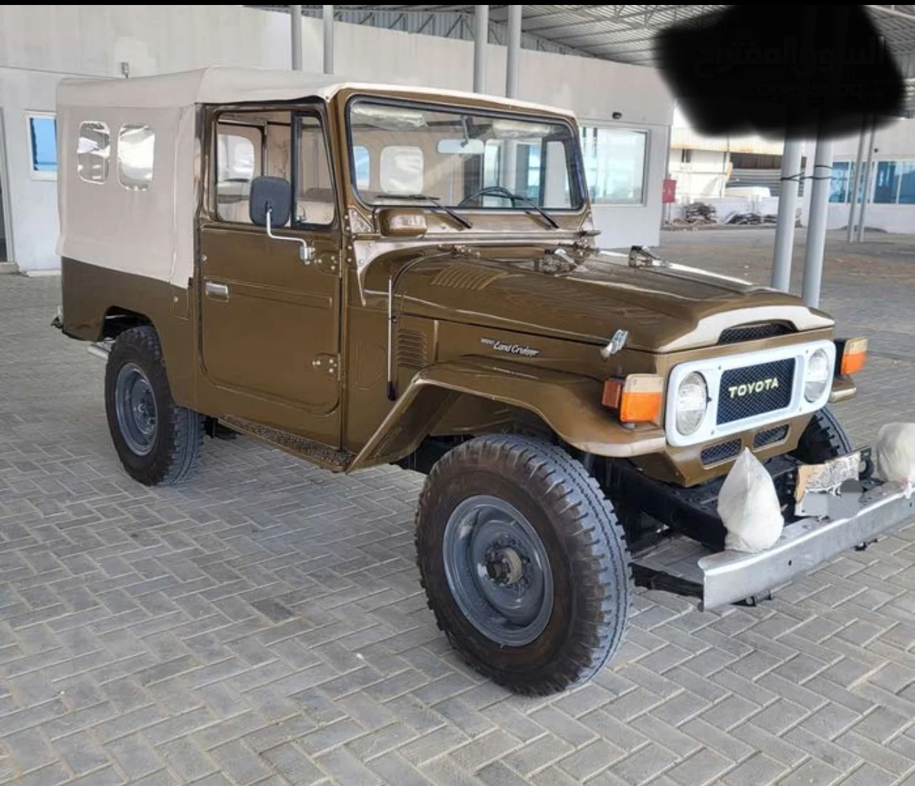

Hello,
Just wanting to get some ideas on listing prices for this 1980 FJ. I will have it in my possession soon once it arrives from overseas. I have been told as high as $100K, but wanted to get some feedback from the community. Mileage shows less than 1,700 Kilometers. The seats are literally brand new and wrapped in protective paper. Also, where should I list it? Your feedback is much appreciated.

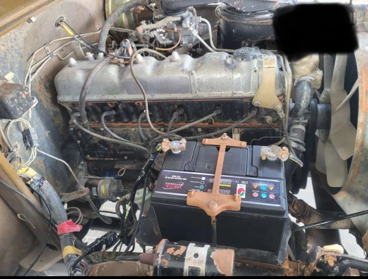

Did you notice the crusty condition of the firewall and the other components under the hood? How about the crumbling floor mat in the driver’s side footwell?
I did notice the crust in the engine compartment but not the floor mat. I was told it was stored for many years and revamped.

something is behind the left rear tire

Just going off the engine compartment you can tell it has way more miles than what they told you. The tape on the wiring harness is wrong, the hardware on the radiator hoses is wrong and just the crusty condition under the hood in general tells a big story.

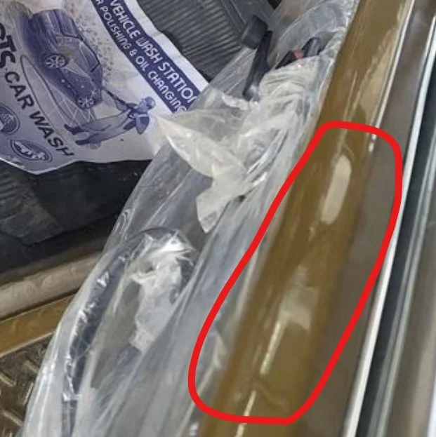

Could just be reflection but it sure looks like worn paint. Takes many miles for a driver's side door to rub paint off where an arm has hung out the window so seeing this on the passenger side says a lot.
This one's been driven. A lot.
