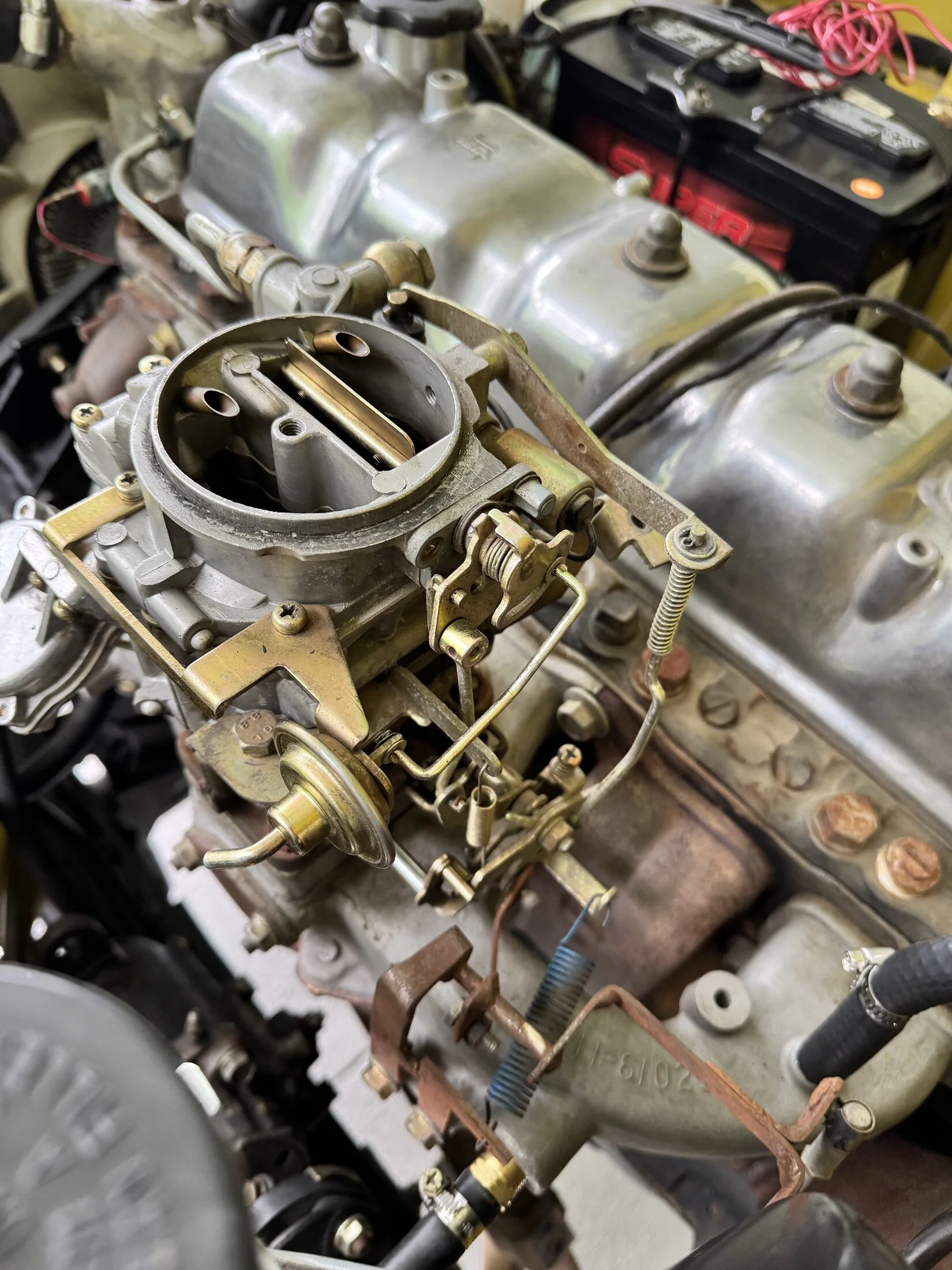

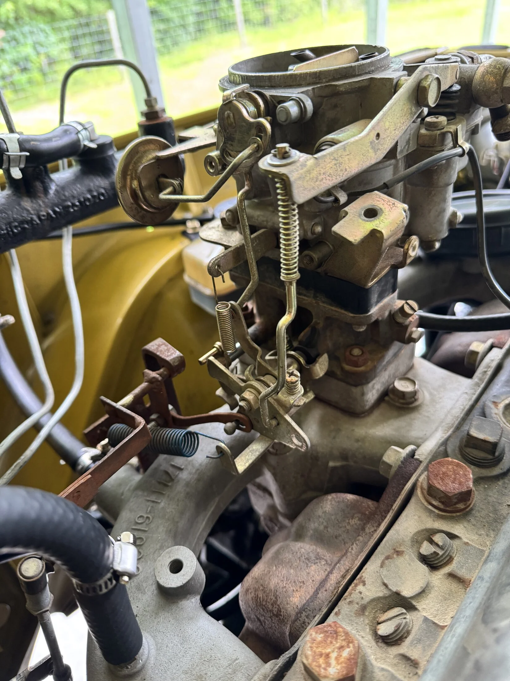

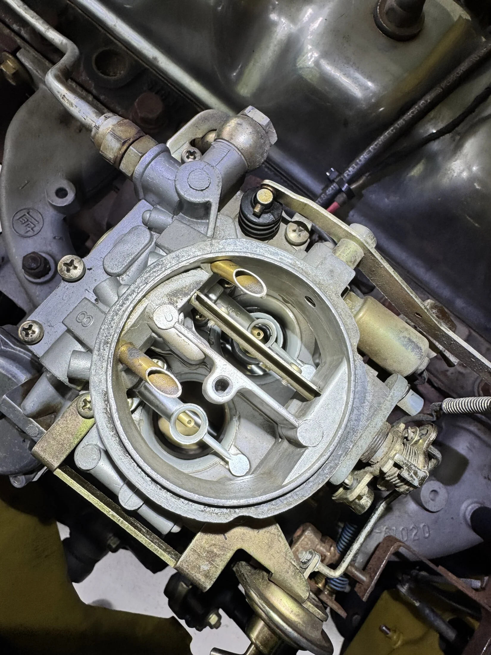

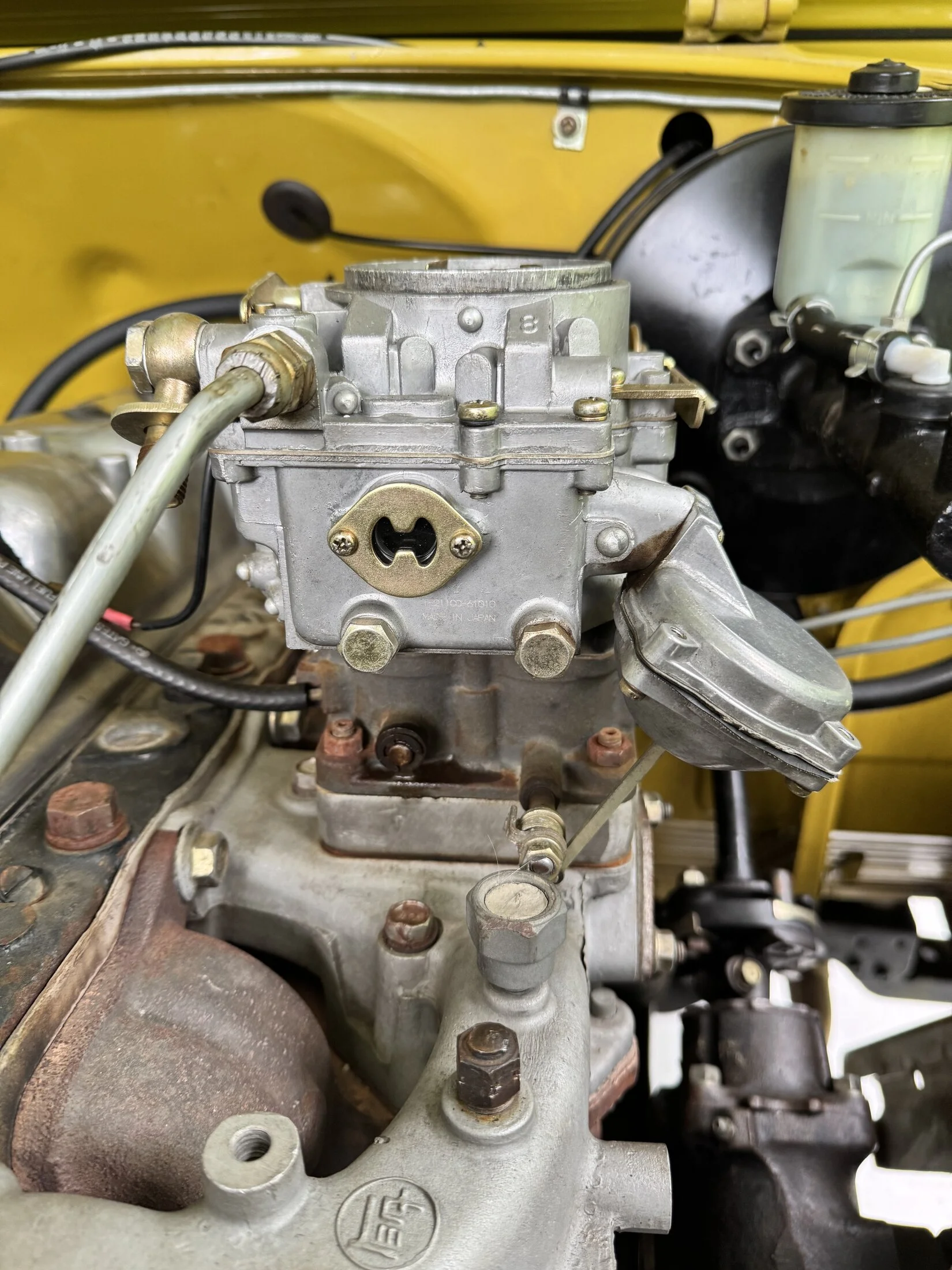

Also some pics of the carb …. Maybe needing a rebuild.
I wouldn't rebuild it yet. Check the dist timing. Set timing to your liking, check vacuum. Try to to adjust idle mixture. 2 turns is probably close.

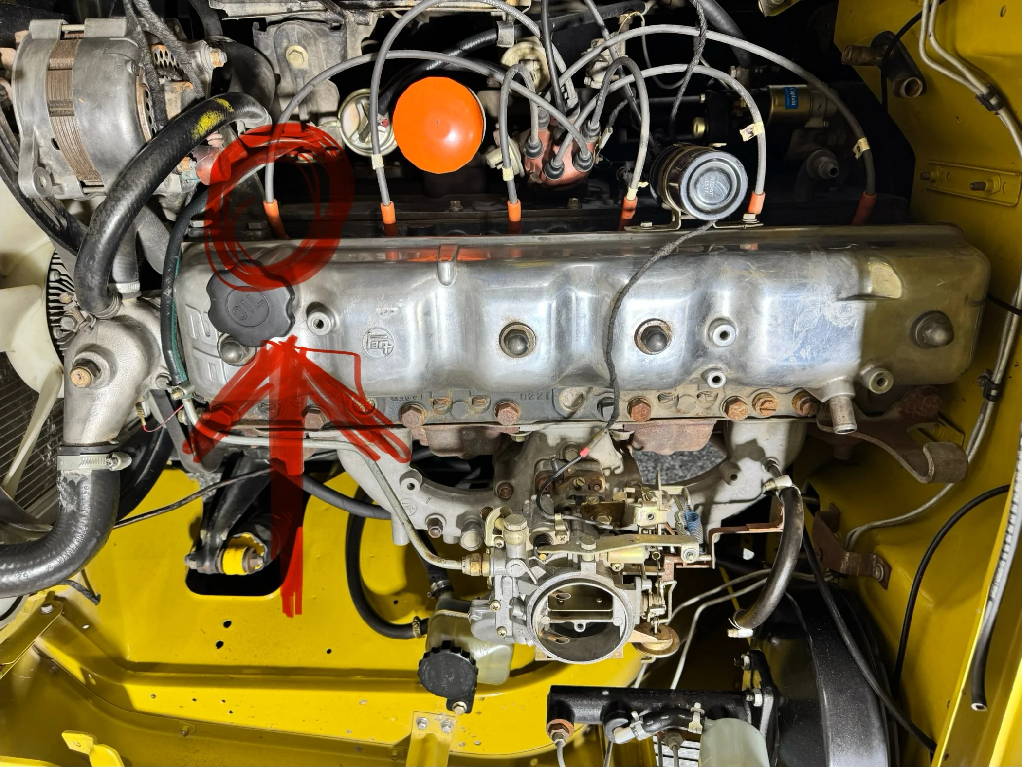

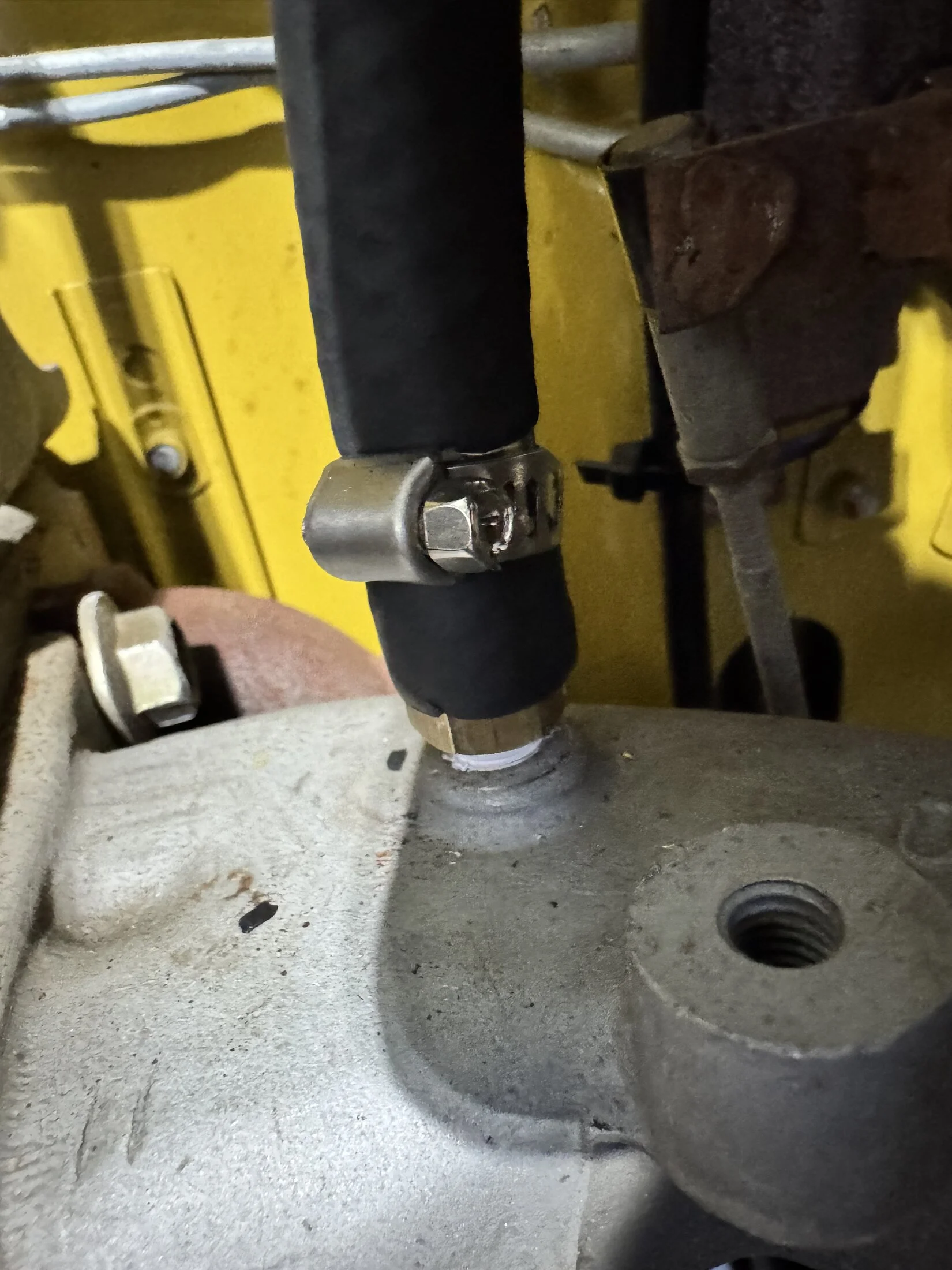

One a side note… I cleaned up the intake vaccum ports and did locate an exhaust leak by the #4 cylinder. Gaskets on order!!!
So, perhaps not-related, but your fuel return line from the carb seems to be disconnected:
Also, if you take a look at the top of the carb when the engine is idling, do you see fuel spitting out of the venturi in the main barrel (the one closest to the engine / right above the idle mix screw). That has been an indicator to me that I had a clogged idle circuit. On that point, do you have any reason to believe that there would be something nasty in the fuel tank (moisture, rust, anything else), and how does your fuel filter look? The low vacuum / can't get it to idle low both could point at the idle circuit.
