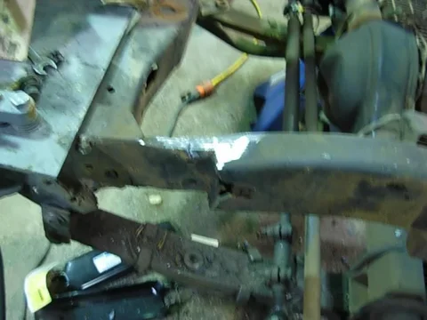

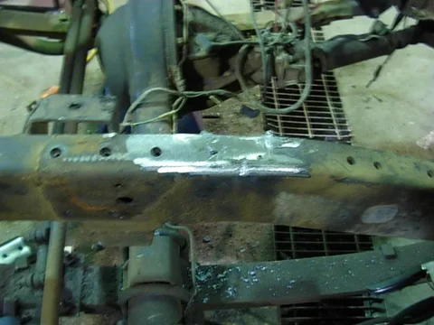

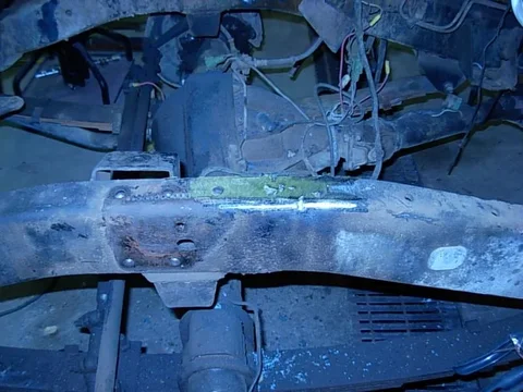

Some progress..............not much

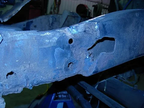

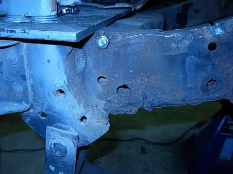

No more shock mounts or s***ty shock towers!
WTF
Yeah I cant take credit for that. At some point in the past somebody hacked it up for a steering box.I have to give them credit, some of the worst work I have ever seen!
Holy Crap, that is one of the worst HACK jobs I have ever seen! wow
Yeah, I dont feel great about the lack of space around the front spring hanger to make a plate to span cover and weld......it is just ugly all the way around. what would you fabricators do? I made a plate been fitting it and looking at it and I just dont like it!:crybaby:
Damn that is harsh......sure you can borrow it.
Awwwww that's nice! Good thing for you I live too far away. On your frame I would consider grafting in a whole piece of frame from the front of the frame to maybe just behind the shock tower. Seems to me that would be the cleanest repair for such a torn up area like that. That's what I would probably do. I do have a donor pig I could slice of a piece of frame for you.....
