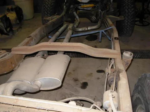

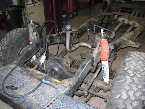

New Frame

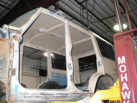

Old donor body

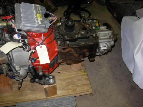

New to me lt1

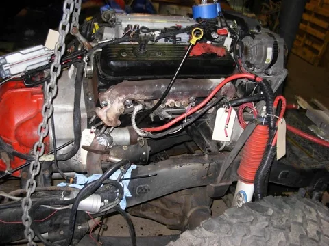

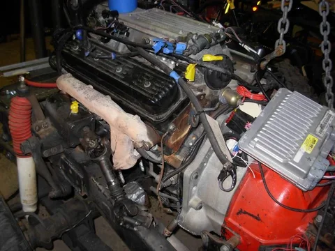

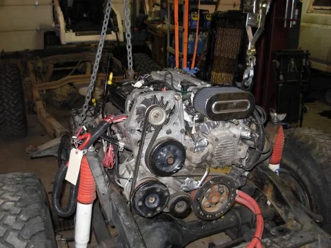

Test fitting the motor tonight, ran into a issue with the manual steering box being in the way:confused: wtf. DSCN0975.webp

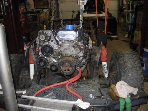

I really want to go power steering but dont have all the parts, was hoping to at least get the motor in and running and actually drive it before addressing the steering, so what am I missing here? DSCN0999.webp
DSCN0979.webpat l
So nuclear, what did you do so they did not touch?

Mine has OEM manual steering w/my older 350. One difference is ramshorn manifolds. It's getting the headliner in today and then back for some initial reassembly at the body shop or I'd send a pic. I'll get one to your email address when I get a chance. My only worry until I do some sort of ps conversion is heat due to proximity to the manifold. We installed new seals on the box so I'll see how long they last.
pablo,
i have most of the parts for the60, looking for the ps pump for the lt1.
you got some photos of yours?
