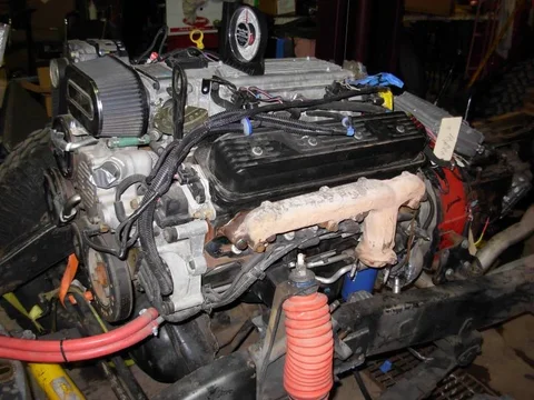

Tonight I had my buddy Doug O swing by the shop and help me get the motor positioned in the frame and he laid pretty welds for me, Pulled it burned the mounts in and reinstalled it so I can start the work on the steering box mount. Was going to shoot photos of Doug O welding but forgot the camera. Project is moving right along though, I also received the body lift, thanks 4crawler, nice work!

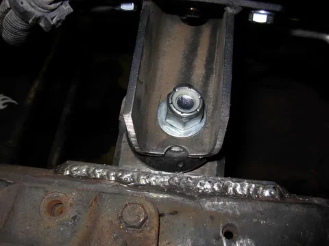

My welds

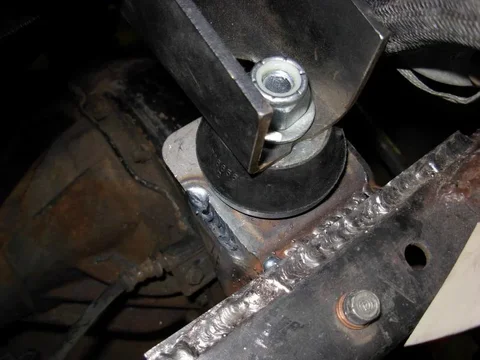

Doug O welds
Motor mounts ....done!:clap:

My welds
Doug O welds

Damn brotha! your welds look just as good as mine. But you didn't post a pic of my best welds. LOL! I am pumped about your rig. It is going to be one stout pig! :cheers:
