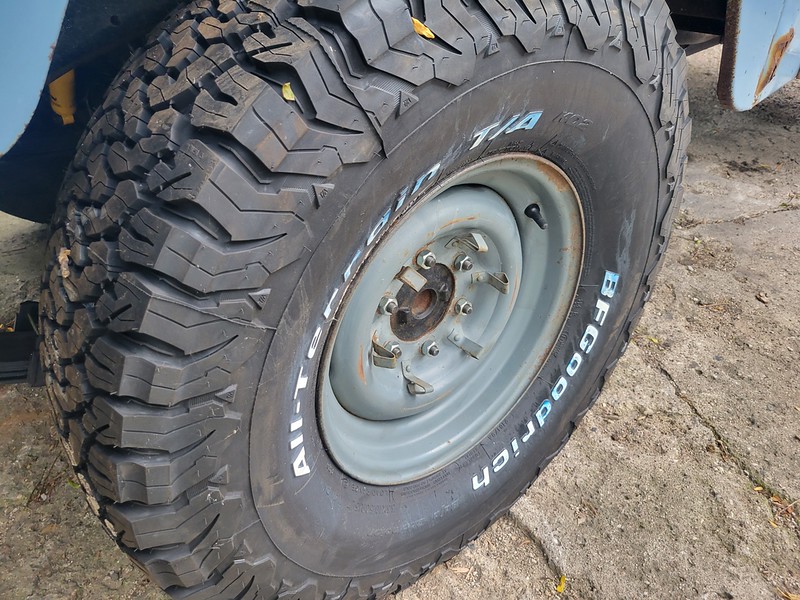

My 69 looks like this, and I just replaced the studs and lug nuts:
Skid plate was previously powder coated, so I’m rolling with it. Today (a beautiful fall day) I fixed the rear wheel studs as mentioned above.

just got my tires replaced the other day... haven't seen or driven my rig in years and I had to sit there and stare at the rear axles... I just couldn't believe that the nuts weren't fully engaged. I don't remember them being as bad as yours... but the studs weren't flush with the nut. Just tried to find all my pictures... not sure where they went.
