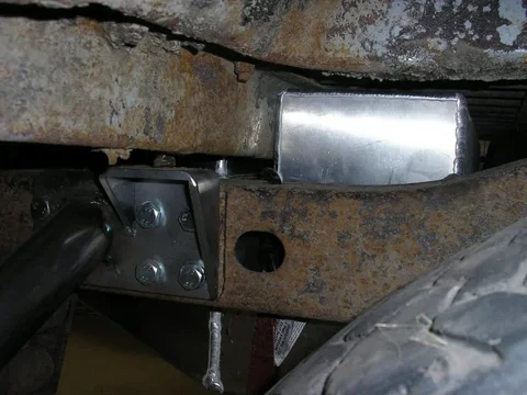

Last one - side shot.
I could have made it hang down more maybe... :meh:
Nuthin feels better than having something you have measured and built fit right in like it was meant to be there. I luv working with aluminium, tank looks great.
Kevin,
Judging by the location of the roll cage, I guess you are no longer putting a factory tach in there?
Also, are you worried about the tank hitting the bed rails when the frame flexes? It looks great, and I am damned impressed with your fitment- but that is all I would worry about. I want to have you make one for Patches...:) Then I would have three tanks...I think I would have to have a fuel tanker licence to drive her.
Cheers,
Josh
The tach wil go in there somewhere, I think :hillbilly:.
I have an overhead console in the plans but hopefully I can find a spot for it in the dash. The overhead console is for pyro, boost, air system pressure, oil temp, radio, DVD/GPS, extra gear switches, rocket launcher etc. It will be part of the cage and all wires will be hidden so the roof/ rear wall comes off easy.
The tank is at least 3/4" from the frame all the way around and I will lower it till it clears the bed by a safe margin. It's just strapped in for now to get it off the floor and out of the way.
