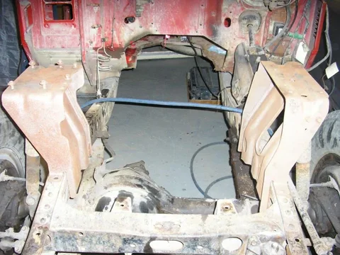

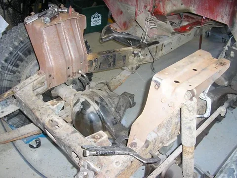

Removed the 2F frame mounts - or at least three of four. The left rear mount is just a plate welded to the top of the frame rail. I'll grind the welds and remove that one later when the cab is off and out of the way.
Here are the mounts... Rather than grind them off I prefer to drill a small (less than 1/4") hole half way through the rivet, then a large (like 7/16") drill bit will take the head off leaving the 3/8" shank of the rivet flush with the surface. Then its hammer time. Some are quite tough and some are two/three hits. Done right there should be no damage to the bracket.
Left
Right
I can't find a pic of the right rear mount :meh:

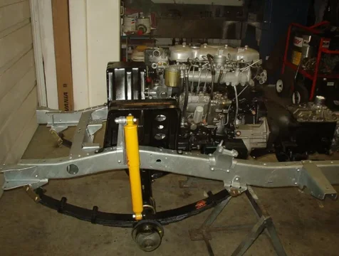

Now I need to figure out where these battery brackets go. There aren't any holes so I'll have to drill and tack nuts inside the frame. I'll drop the drive train in first to help locate the brackets correctly. I also have a bunch of photo's to consult.

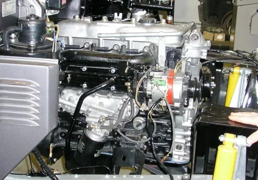

I referenced several pics I have of a friends 45 F to B conversion...

And used some other indicators to locate my battery brackets. My frame being an FJ has no holes or captured nuts so I marked with a center punch and drilled a small pilot hole. I am still weighing my options as to how to bolt them on. There is simply no way to get a nut onto a bolt inside the frame. I asked my restoration buddy how he did it and he uses some kind of industrial nutsert. My experience with nutserts says they would not be up to the task in the long run. I suppose I could tap the frame and not use nuts - but the frame is relatively thin and I'd only get a couple of threads. On the other hand there are 8 bolts per bracket :meh:

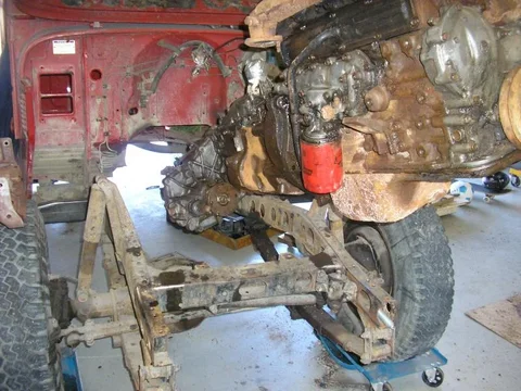

I cleaned up my rusty 3B a bit and bolted the tranny and T-case back on in order to locate my motor mount brackets and tranny cross-member.
I have a complete cross-member but not the frame brackets for the motor mounts. I borrowed a set and made copies. I just have to weld the small angle to one and the plate to the other. Then I can try and locate them on my frame. Not really sure how to do that. My half baked plan is to attach the rubber mounts, slip the drive train into the frame and attach the brackets and cross member. Then I can move it up/ down or for/ aft as required until its in the correct location :meh:. I'll go with that plan and change it as needed.
Nutserts in steel not aluminum have held the torque of a diesel with big tires for some time now.
Properly set they are strong.
Rob
Thanks Rob,
I'm just using them for the battery brackets so I guess they'll be ok. The motor frame brackets will be bolted with fine thread and tack welded in the corners.
