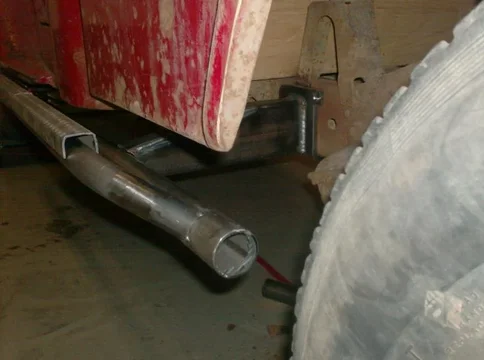

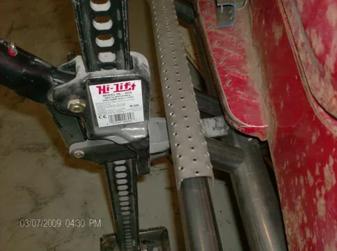

Here is a shot down the cab showing the slider. It is tack welded to the frame until the cab comes off and then I'll match drill the holes and it will eventually be bolted on. For the bolts I will drill an oversized hole through and through the frame and slip in a solid piece of round bar that is drilled and tapped, then welded to both sides of the frame. That will tie the box section frame together, prevent "squashing" the frame, leave the inside of the frame clean and make the removal of the sliders an easy thing. Also in this shot you can see the tread material I will be using. It is just held on by gravity until I figure where to put it. There will be a few connectors between the 1.5 and 2" tube as well.

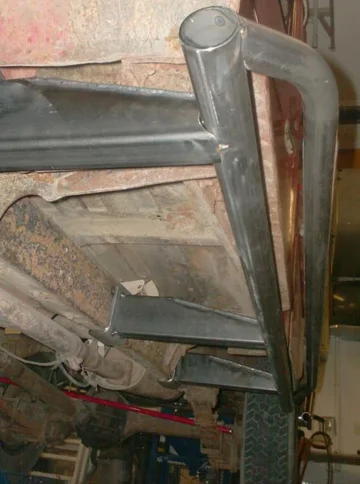

In this shot you can see the basic structure of the slider. On this third mount I had to actually cut off a part of the bed mount bracket so that the slider mount would sit flat. The frame narrows from the rear to the front so the slider mounts get progressively longer as you move forward. At this rear mount the frame is actually parallel to the long axis of the truck. The same is true of the front mount, so they come straight off, perpendicular, to the frame. The middle of the three mounts is at a spot where the frame is tapered and so I angled it to match the other two. Sorry for the confusing explanation. Basically I mean to say that if you were to take off the cab you would see the slider mounts make a straight line across the frame even where it is tapered. The wood you see through the wheel well is just a piece of plywood between the cab and bed to protect the cab when lifting the bed off.
I may be adding another round tube support run from the end of the slider to the frame. There are two stock holes in the frame in just the right spot. The rear overhang is about 16-18". I couldn't move the rear mount back any because the frame starts to taper out and curve up for the rear axle. Well, I could have but this was easier. As well as the bolting method I described above, I will be running two countersunk flat head bolts up into the bottom of each mount to act in shear as the sliders support the weight of the truck. There is a surprising volume of space up under the bed here. I have visions of two deep cycle batteries or an old propane tank for an onboard air reservoir.

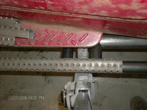

The exhaust will be run on the other side with the 3B, and it will be above the bottom of the frame rails. That will leave the sliders and frame at about the same height off the ground. I plan on making a custom skid plate to protect my vital bits too.
I might run a length of tube to connect the three slider arms about halfway out from the frame to stiffen the whole affair. Also there will be two or three flattened spots on the 1.5" tube for jacking points. The two tubes will be joined at those locations with short lengths of tube so they both support the weight.

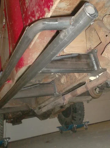

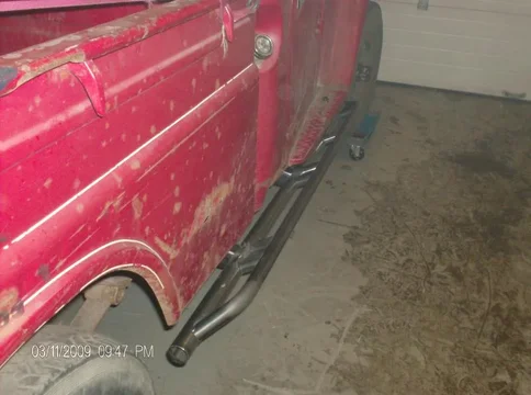

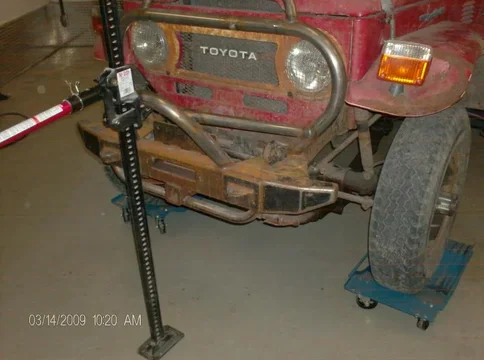

So I finished the other side far enough for now..
And I can start the front now. I spun the truck around and tightened the bolts on the front bumper to secure it in place and build the brush guards. I needed to bash the left fender into proper shape to build to fit. Just for kicks I lifted the front off the ground... there were no marks on the 2" tube with the full weight of the truck on it :cool:

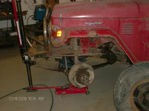

She was a bit squirrely with the roller skates under the four corners so I moved the jack to the corner and stuck a jack stand under there. Popped off the wheel and removed the light. Grabbed a hammer and bashed it out.
Now both sides are about the same shape
It's a bit risky doing all of this when I have new fenders coming and the front clip is not even straight but I'm building in some clearance and my stuff is built off the frame evenly so I'll hope for the best. I am going to build the whole truck then tear it all down for blasting, coatings and paint.

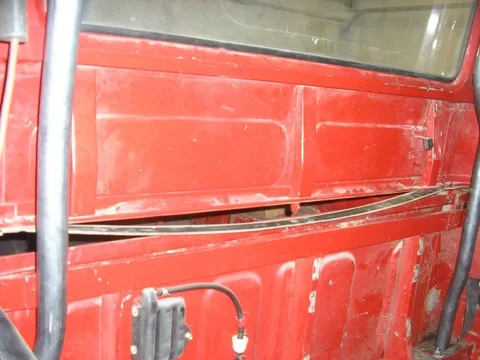

So - on to the roll cage... with the two rear drops in place I needed to remove the top to finish the hoop by adding the front top cross bit.
Removed all the hardware. Got to use the father-in-laws impact screw loosener thingy
The top is actually quite light, even with the glass in.
