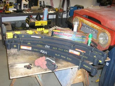

A sharp eye (you know who you are ;)) will notice the bushing issue in the middle picture. I'm working that out with the supplier.
A couple more pictures and a question or two...
Question - I knew at one time what the "+" and "0" painted on the top leaf meant but can't remember.... was it that the spring tested slightly higher than spec or...
Question - my 45 is a 1978. what are the inside diameters of the spring perches and the shackle mounts on the frame. I'm not ready to disassemble my rig yet and I need to confirm my bushings are correct.
There are 3 different sizes of bushing here
#1 - 15mm ID x 25mm OD
#2 - 18mm ID x 30mm OD
#3 - 18mm ID x 35mm OD
All the spring eyes are 35mm ID so all the #3's are for the springs therefore there should be 16 of them. I have 13 :hillbilly:
The #1's seem to be for the frame side of the front shackle.
The #2's seem to be for the frame side of the rear shackle.
Net effect is I am three short on the #3 and have four extra of the #2...... I think. Could someone please back up my thinking of educate me please.
I believe you are right + means above tolerance - less than and 0 balls on !

I bought my kit not from a OME distributer but from a friend of mine who makes a living fixing and restoring Landcruisers and other Toyotas. He prefers this particular mix of parts on his restos so I just went with his recommendation. The bushings and shackles are marked "Terrain Tamer" which I gather is an aftermarket outfit from Aus that sells a lot of Cruiser parts. If I was going to buy anywhere else it would be from Kurt based on the plethora of good reviews he has here on Mud and the utter lack of negative feedback about his business and ethics.
The actual distributer these came from is a well known 4 wheel auto....motive supplier ;). He had apparently been sitting on these rear springs for quite some time and so let them go at a discount. I've got the medium fronts (CS001F same as for the 40's) and the 45 heavy rears (CS003R) which is a medium with an extra leaf. If I find the rears too stiff I can remove it.
For interests sake, I landed this kit in my garage for $175.00 more than Kurt's current sale price..... but.... remember I am in Canada and would have to pay tax, shipping, duty and currency exchange on top of his price. I also saved about $500 off the Canadian distributers listed prices and didn't pay any shipping.
That's the way I remembered it. Funny how when you read a thread and think to yourself "I need to remember this thread cuz I'm gonna do the same thing" but you never do. I know there is a thread with a complete discussion about installing these. It's got trivia and marking info and pin and bushing sizes for different year frame etc etc.
OME info
The OMESB30 bushing kit will have a 15mm I.D. and 25mm O.D.
The OMESB1 bushing kit will have a 18mm I.D. and 35mm O.D.
The OMESB79 bushing kit will have a 18mm I.D. and 30mm O.D.
With that info you should be able to order what you need.
If you need info on shackles or pins let me know.
The + denotes drivers side.
Right side in Australia
Left side in U.S.
? in Canada:doh:
Hope that helps.:cheers:

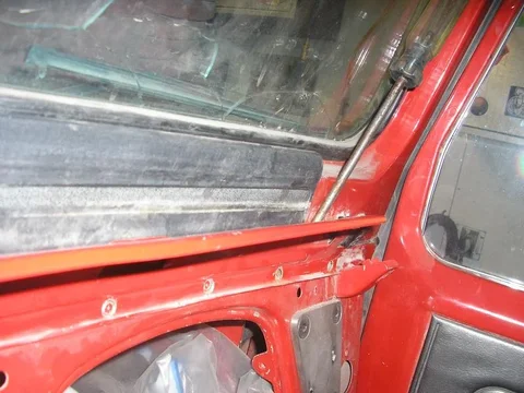

I previously notched the corners on the dash pad mounting flange to allow the cage risers to pass. I have since decided the stock dash will be removed completely to allow the cage to pass and I will fabricate a custom "Dashman" style storage box that will look good and also house several gauges (pyro, boost etc.). A while ago I got a couple of spot weld cutter drill bits from McMaster Carr and have been wanting to try them out.
With mom in full on "x-mas baking mode" I took the initiative and occupied the mini me with some testosterone building exercises. I used a center punch to help the spring loaded bit tip to stay put and pulled the trigger. The bits were a very good purchase as they cut almost too fast and I had to try hard not to cut the second layer.
Starting at one end and adding a little tension by jamming the screwdriver in made it easier to detect when the weld let go.

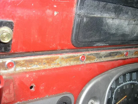

Looks like the grey primer was applied and then the parts assembled before body color was sprayed. A natural moisture collector for rust. Now to grind off the "buttons" left behind.
I flopped the windscreen to get better access with the 2" air grinder. 80 grit for the "buttons" and then medium (purple) scotchbrite pad to remove the rust. After cleaning I stood the windscreen back up and set the top back in place.
