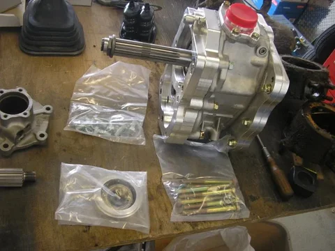

I went for a little (1200 Km round) trip yesterday down to Montana to 3_puppies place. I traded him some parts for an FJ60 front axle, a set of mini truck knuckles and backing plates. That gives me the parts to do vented discs and V6 calipers on four corners. Paul also had a package from Marlin and one from Georg (orangeFJ45)....
Twin stick kit from Georg
Australian splitcase drum park brake
Rebuild kits for the splitcase, H55f, front diff and rear diff
Call Georg (orangefj45 - Valley Hybrids) - he had the splitcase in stock and the h55f was a couple days for him to bring in. He also had the drum park brake for the splitcase you see in the photo above
THESE.
The twin stick kit: document it carefully. Make mistakes and tell me which ones not to make (I need to order one from Georg myself...)

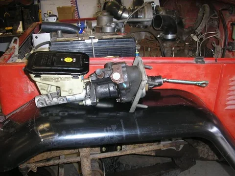

So, a while ago I decided to go with a hydro-boost instead of the vacuum route. This is out of a 2002 GMC Safari (I know, I know. It will be the only GM part in my build - I promise) This one had 4 wheel disc brakes and a larger compressed gas cylinder reserve on it. The master cylinder is from the same vehicle. As you can see, due to the mounting position in a van it is angled downward when the reservoir is level. I initially thought I could just get a different reservoir or complete master and make a different mounting bracket or just return it. It was the booster I was actually interested in anyway. Upon closer inspection the fact that it angled downward actually made more room with regard to the intake manifold and throttle linkage.

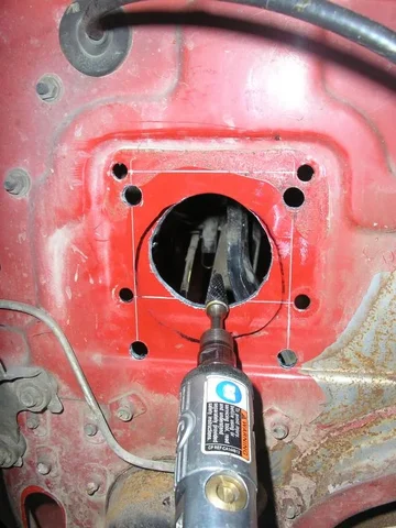

So I went ahead and drilled through the firewall and pedal bucket...
and started to clearance the very large center hole

and drilled the holes all over again - due to the angled system this lower position was required but the end justified the means
et voila! It looks kinda funky but clearance is great and there's no going back

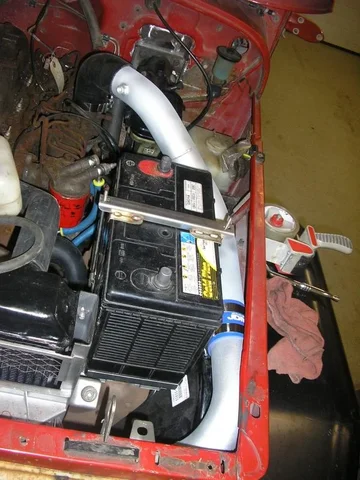

Fender back on and time for the intercooler to intake piping
sorry, no progress picks
intercooler pipe done. I would have done a one piece pipe but experience on the other side taught me it is impossible to fit or remove a one piece pipe without removing the fender:D There is another 1/8 NPT fitting welded down behind the battery for the boost gauge. It looks like it goes over the master reservoir in this pick but in reality it is just slightly over one corner and the cap is easily accessed.

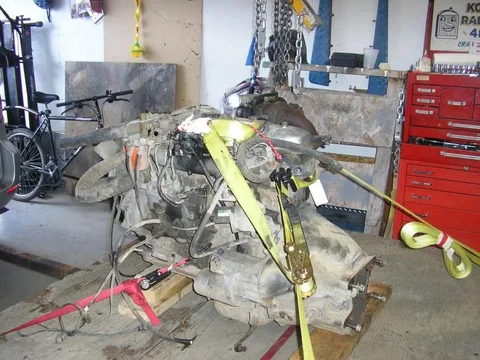

Honest honey, it followed me home....

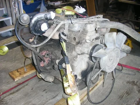

450K and still OK - just a spare and a few parts. Home made turbo setup - volvo I think. I got the BJ60 complete harness too. For those of you in the know this came from a local rig known as "Slightly Dented" - thanks Ian and Cody for lifting it on the trailer... by hand!
see... the decal even says its OK
hummm, interesting setup with the hydroboost. i wish i would have had time to stop by during my visit a couple weeks back, i would have enjoyed an upclose and person look at the build.
cheers
Cool , great idea on the hydro boost .
Was thinking of the electric vac pumps, but i like the hydro boost much better , and keep the electro-vac for the crusie :-) ,, 2002 GMC Safari Van , was that diesel ?
Would like to see a pix of the home-made manifold and the turbo, don't think it's a volvo one tho.
